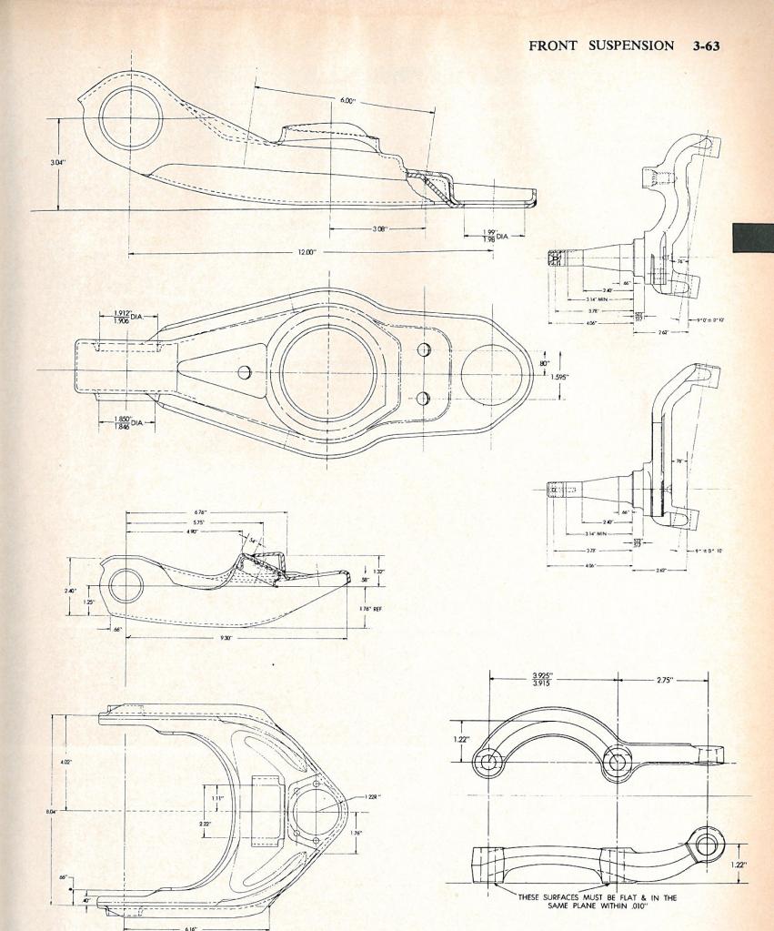

Excellent workshop manual scans - unfortunately I can't read all the dimensions on the LC one.
LH/LX and UC RTS ones would be excellent to complete the set.
Which workshop manuals are you guys scanning these from? They look like they must be from factory holden manuals.

LC 6cyl Torana
Edit: Can anyone else read the dimensions? I might have to do a zoom scan or something.
So what's the chance of getting a better resolution image of this?
And some for the LH - UC Toranas?
#57 _Skapinad_
Posted 29 July 2012 - 10:44 AM
Clearer?
#58 _CHOPPER_
_CHOPPER_
Posted 29 July 2012 - 03:43 PM
The pics I can see, it's just the numbers I'm having trouble with.

#60 _CHOPPER_
_CHOPPER_
Posted 28 September 2012 - 08:37 PM
OK it's a bit old, but does somebody have a clearer image of the LC/LJ diagram and is ther an image out there somewhere for the LH-UC?
#61 S pack
Posted 28 September 2012 - 09:02 PM
Hi Chopper
I tried to enlarge the LC/LJ diagram on the scanner but to get it large enough to read the dimensions the image data size was too large for the scanner to handle.
I'll have try close up pics with the camera instead.
Dave.
