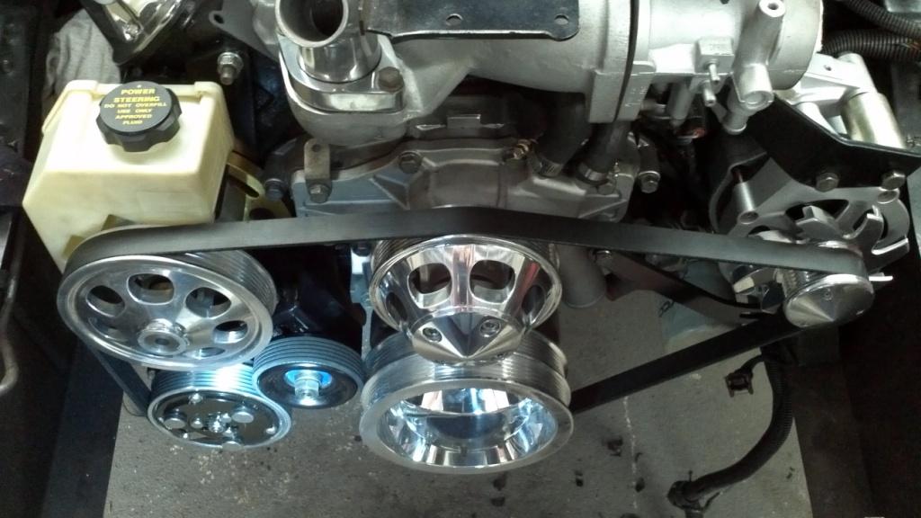

looks great so far, i think you will need a bit more wrap on that water pump pulley but
I agree with you there, there isn't much belt contact at all.

Yep your right but the photo's don't do it justice, It's quite hard to turn the water pump pulley with the belt on, and the water pump don't take much power to drive it. I was hoping to reduce drag by not adding an extra idler pulley but if I have any problems with pulley slip I will have to add one more idler, which would be quite easy compared with setting up all the other pulleys. Its a shame I couldn't go under but the water pump would pump in the wrong direction.
I have see some of March Performance small block Chev conversion serpentine kits and some have around the same contact area on their water pump pulleys. I suppose I will have to wait and see.

At last I compleated the accesories drive system.
I think you need to revisit the belt location over the water pump, with that little contact i think it will slip and cause major overheating issues.

Yep you might be right, but I carn't turn it by one hand and water pumps take bugger all to drive . With 6PK belts the grip is about tripple to that of the standard vee belt. The A/C pump will draw the most power then the power steering pump, the alternator will take around 5-8 hp. I recken the water pump will draw around 1/2 hp. That will increase at bit at 5,000 rpm. If it does slip I will just have to make an extra idler pulley. I was trying to keep tis area clutter free as I might fit a little belt driven vortech later when I get bored.
