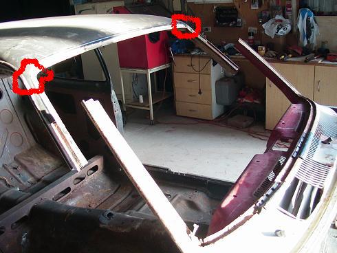

Back to the Joing job..
I sandblasted all the joining areas and Zinc primed.. I cleaned up the LH middle chassis rail as well.. Shouldnt rust any more.. I cut the inner sill from the front, ready to mate to back..I wont cut the outer untill I know its correct.. A little at a time..
I took off the outer from the window frame.. Im going to do a BIG stagger for strength.... I leveled the rear.. Will get the front on same plane when needed..
Looks like its going to work....
Mike

you know you could just melt the lead out of the front window frame and then re join there
im not to sure if you havent cut to much of the front has the pic can be deceving
going great guns
cheers gong
