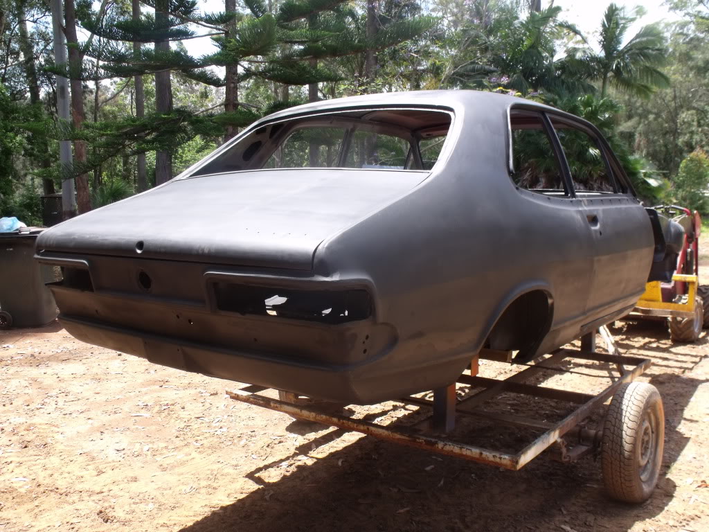

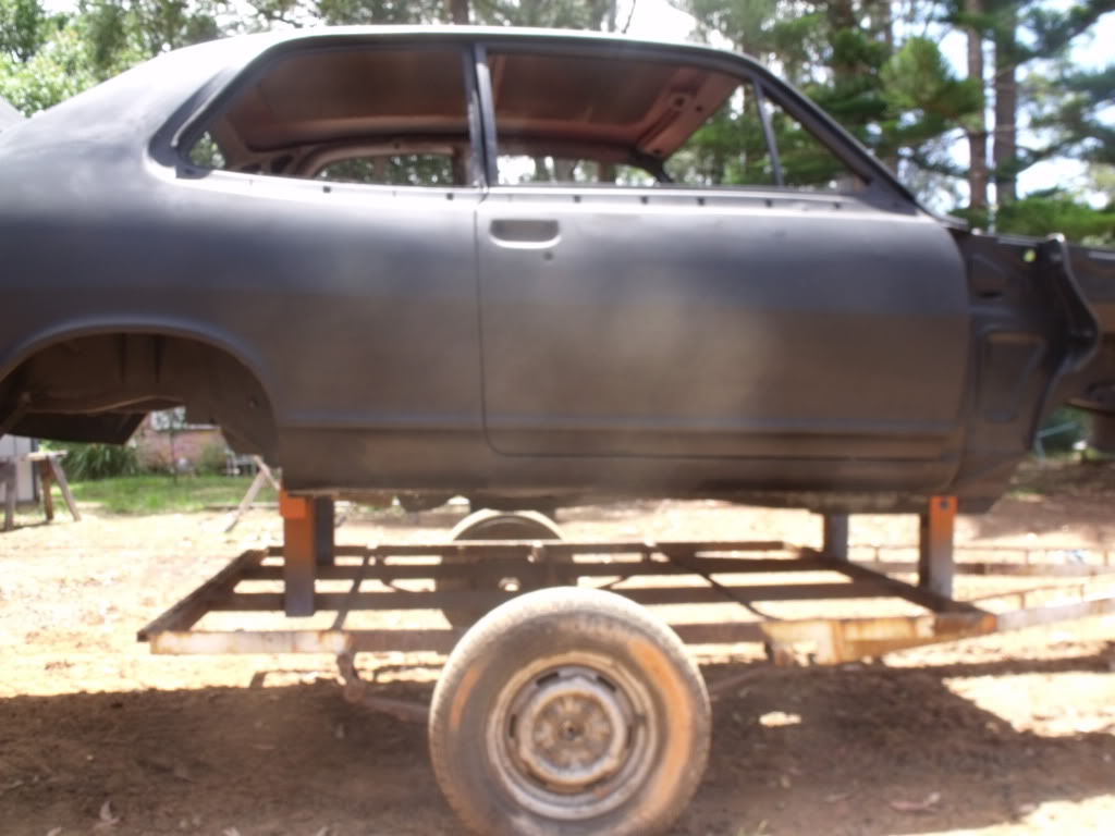

I made the trolley and finnished the repairs.. I have to fit doors and take out bracing..
It is off to get beaten up on Monday... Cant wait.. He said 2-3weeks.. But I dont get back until Ive welded his car.. Looks like Im going to have to do some looonnngg days to finnish his car.. It isnt as bas as Mine was.. Shouldnt take too long.. I figure 4 weeks solid work... I have experiance now.. Sooo much easier for me this time.. I have the jigs, dolly's I made.. easy.. I will make my own replacement panels..I t doesnt need too many.. Mainly front window cowl area..The A-pillars look fine..
Guys I made the trolley 600mm off the ground and made sure that it was sitting as it sits on the road.. The rear front mount is 12.7mm lower thant the front.. some quick calculations and a Plumb bob..alls good.. Its a bit overkill, but It wont move..
Hopefully the next post will be of my XU-1, all beaten up and straightened out :) :).... Then Ill replace the whole metal dash, then colour. . Cant wait..

good idea mike, i done the same thing when i was building my car, the only diffrance was i made mine from old trailer frame and welded lc 4 cyl stubs to it,,, it was good i could tow it around the farm with my dingo, the first couple of pics are of an lj.
here is a pic or 2.
cheers gong
