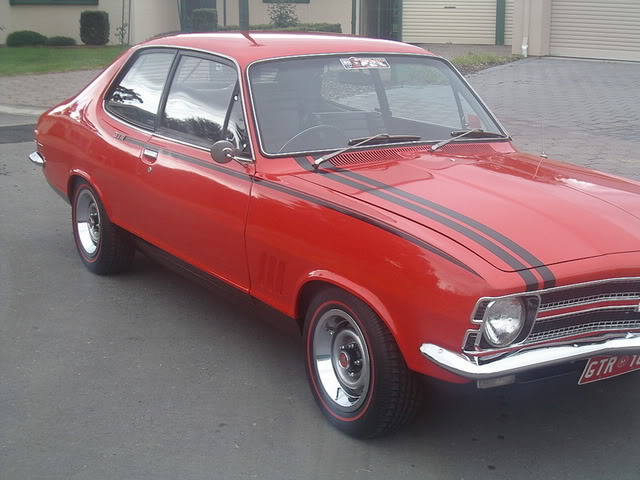

hi mike
looking good ? the colour does look like it has a orange tinge to it as far as i know rally red is red ? the spoiler if its the one off my car is true rally red has been confirmed by so called expert keep in mind it has been sprayed with acrylic paint
john

#520 Potta
Posted 13 February 2015 - 09:19 PM
Looking good Mike.
Hard to tell from the pics but it does look more orange than other rally red cars I've seen.
Maybe PM John Gong?
He would know for sure.
#521 XUI-86

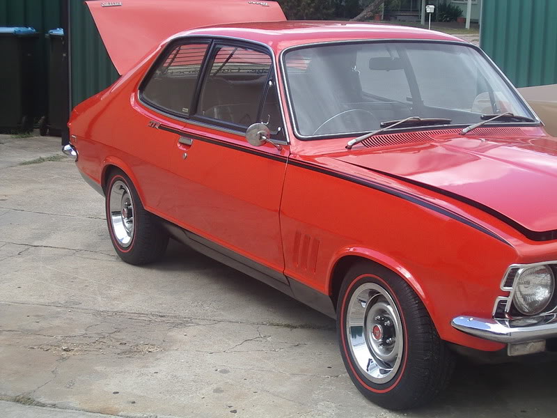

#522 bullitA9X
bullitA9X
  • 4,168 posts
  • Location:south australia
Posted 14 February 2015 - 11:39 AM
hey mike here is my genuine rally red lc gtr that i owned your colour does look a little orange just depends who mixes it mate also when you look at older paint jobs that were painted before the led was removed they always look different
#523 Potta
Posted 14 February 2015 - 12:06 PM
That is the Rally Red that I know.
Looks very similar to Gene's Red Rocket that he had which wasn't an original paint job.
