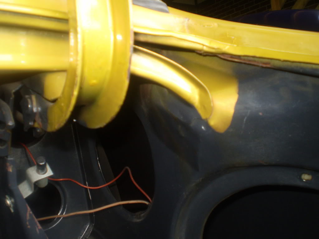

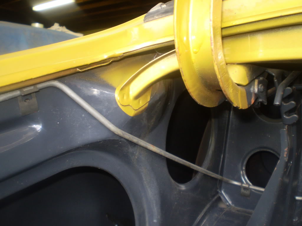

What about these? are they correct for 8/70 Adelaide build. which of the door/floor seal are correct? and does it go around the back of the door as in pic 1.
Mike
