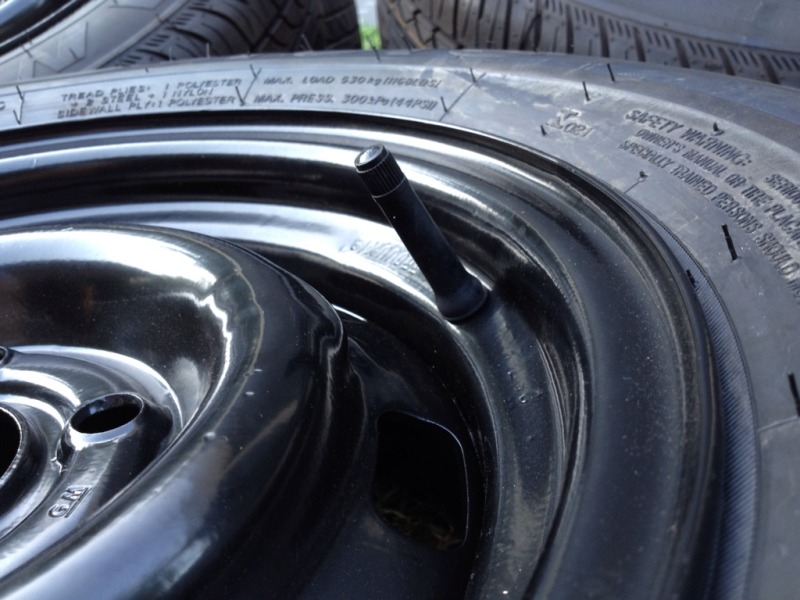

$550 to get 5 rims blasted and powder coated. Found a shop with some 185/70/R13s in stock. However I've had the incorrect valve stems fitted... Had a choice of long or short.... I went short.... Dam... Have to take em back and get the valves changed. F*ck me I'm not having much luck lately....
As you can see..... The valve stems are way to short.

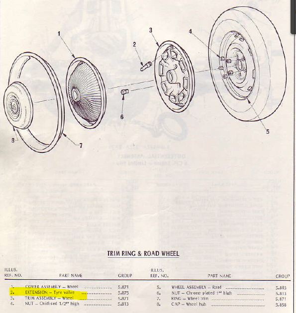

Check this out from the parts book! Tyre valve extensions!!!! hahahahaha. Shit aye!
Yes, they are shit. I realise you are trying to get the car as close to original as possible, but avoid them like the plague. They are reknown for letting the valve core stay off their seat and simply deflating the tyre when ever they feel like it.

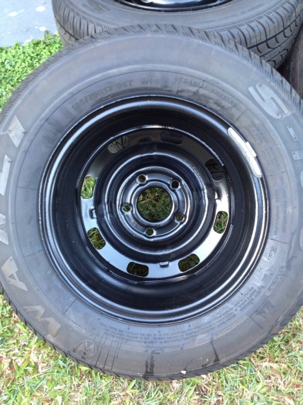

Posted 20 September 2012 - 05:59 PM
Righto so these are the longer stems. I think that will just do the trick???

Make sure you use metal valve caps, as they have a rubber seal in them. A tyre will hold pressure better with a metal valve cap and NO valve core rather than the other way round.
