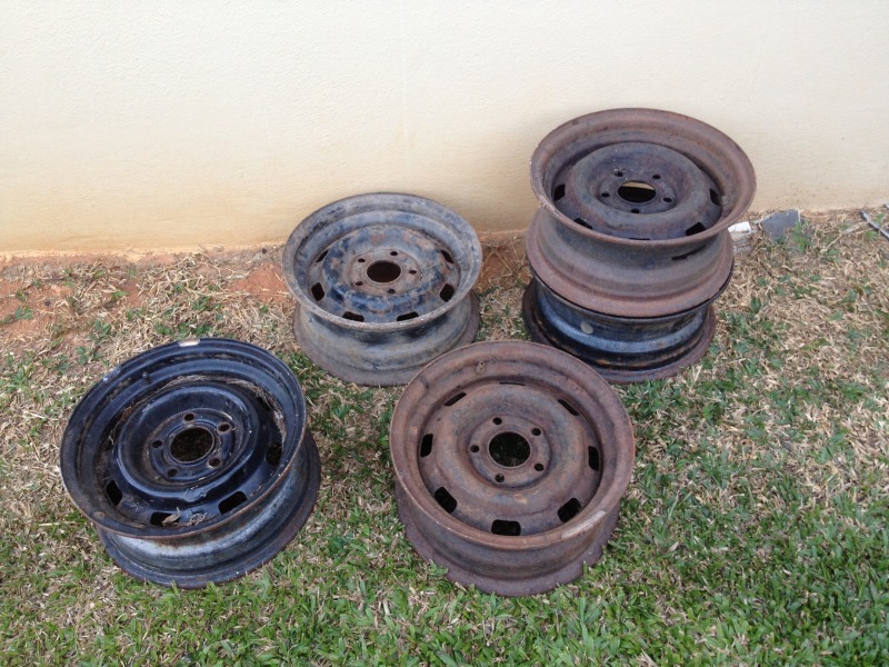

These ones here showed up at my place yesterday.
Hope they do the trick.

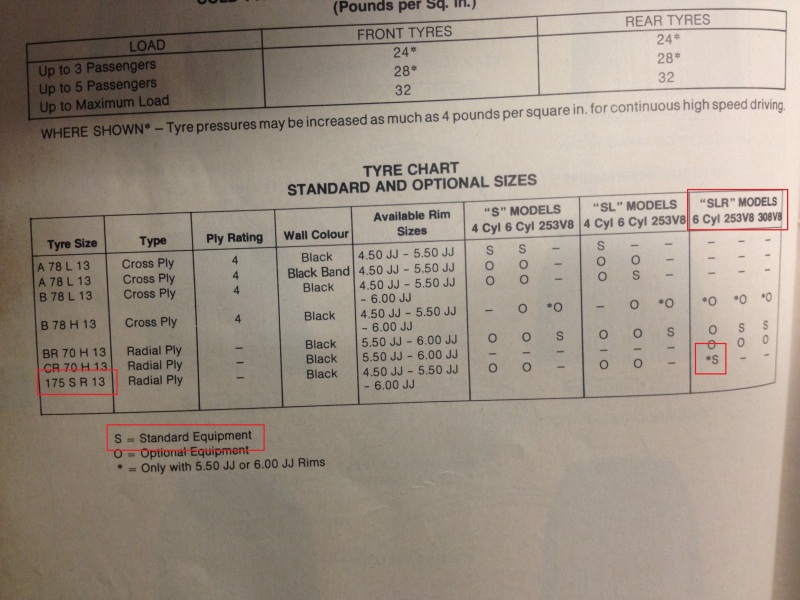

Stock size would be 185/70 in my opinion. 205's are too wide for a 5.5 inch rim in my opinion. Looks like a pregnant wombat.
Im thinking perhaps 175's?????

I have 175's on one of my cars with SLR caps and another I have 185's with standard hubcaps and dress rims. Go the 185's! Much nicer fit on the 5.5inch rim.
My 2 cents worth....
The rims you have got pictured will do the trick. Sandblast and kbs paint.
That must be for the LH. My LX book says an SL/R 5000 had BR70H13 as standard. The metric sizing for a 175R13 is a 185/75R13.

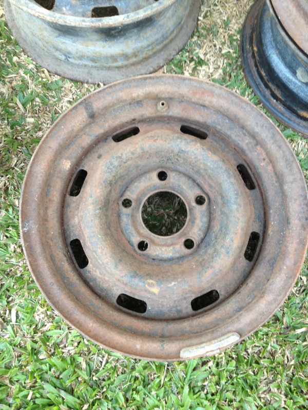

If you want to fit LH SLR hubcaps, the valve must line up with a wheel stud hole on the rim.
Jim
#36 hanra
Posted 26 August 2012 - 07:52 PM
Like this one?
Yeah mate. Your right, I think I was either drunk or high on fumes when I did that?
S= Standard fitment on LH SLR with 308 is BR70H13 as you mentioned. Im not sure how available 185's are these days. So I may go with a 195.

Like this one?
yep.
An SLR hubcap won't easily fit on the black rim on the left without surgery.
I found this out about 35 years ago.
Jim
#39 hanra
Posted 26 August 2012 - 08:39 PM
Well spotted. Ive already arranged for an exchange on that one. The other 3 are like the one above.

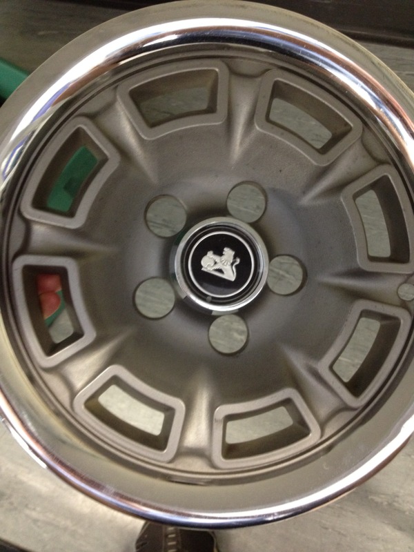

I believe my exchange rim is ready for collection.
Had a little pressie arrive in the mail to...!
