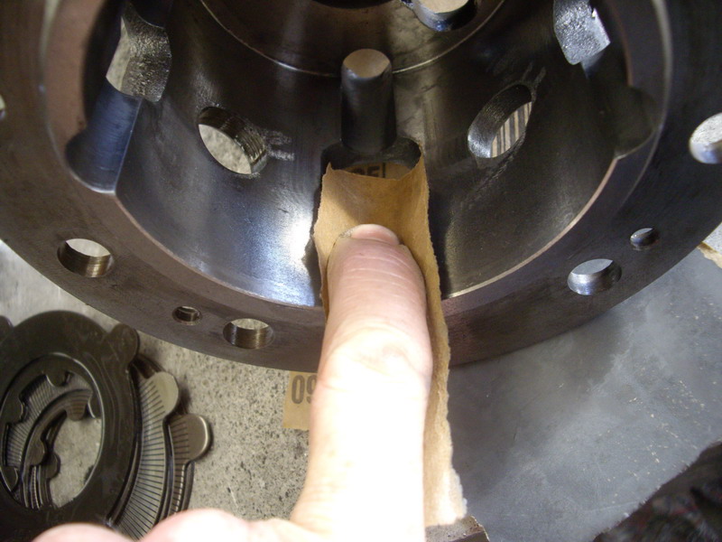

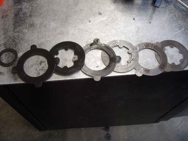

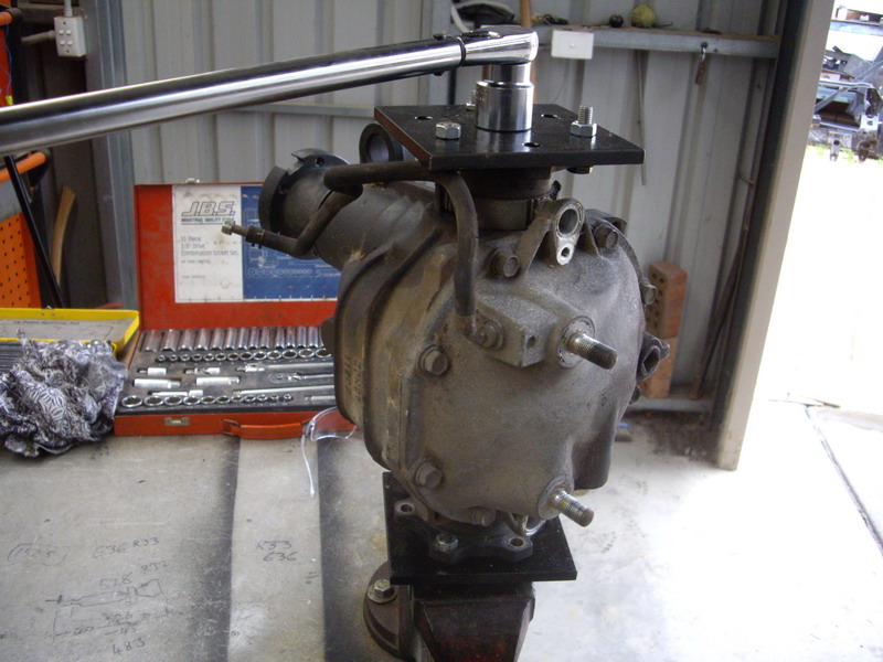

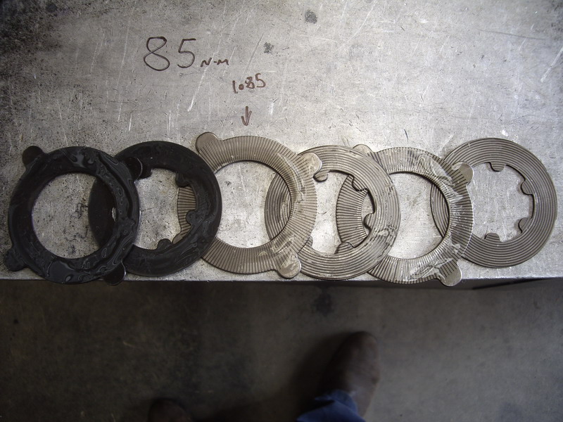

Few more things done, rebuilt the clutches in the diff. The bearings and back lash was fine so brought the nismo 3843S-R521 kit but should have brought the 3843S-R520 kit.
The R521 kit came with 4 spring plates, 2 spring discs 4 friction discs and 2 friction plates, this made about 130ft/lb brake away.
I used 2 spring plates, 2 spring discs, 4 friction plates and 4 friction discs, this would be the same as the R520 kit.

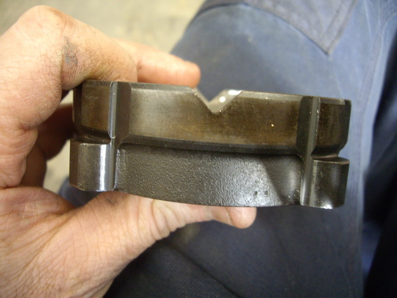

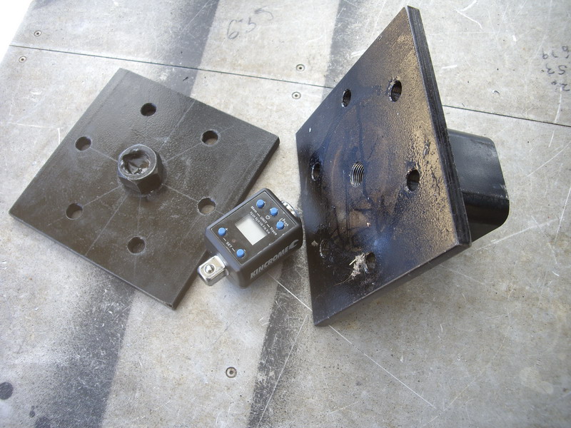

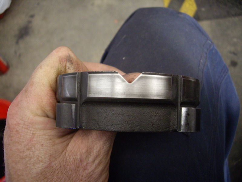

The brake away torque to start with was 25 ft/lb and ended up with 69 ft/lb. Gave the pressure rings and the casing a polish with some fine sand paper and filed the
sharp edges, this helped the pressure ring slide smoothly.
Pressure ring before polishing.
After
Polishing the casing where the ears run.

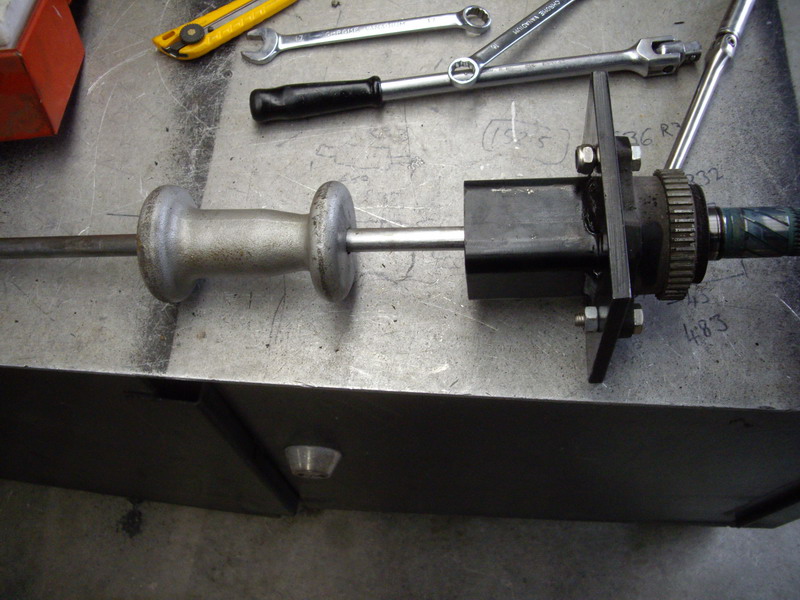

Made some plates to bolt to the flanges for testing and removing the stubs.

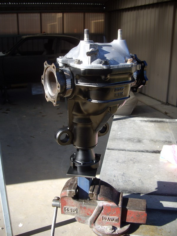

Put back together with a quick coat of paint.
Also started to de-burred the block and modified a corner on the fuel tank to give the exhaust more clearance.
