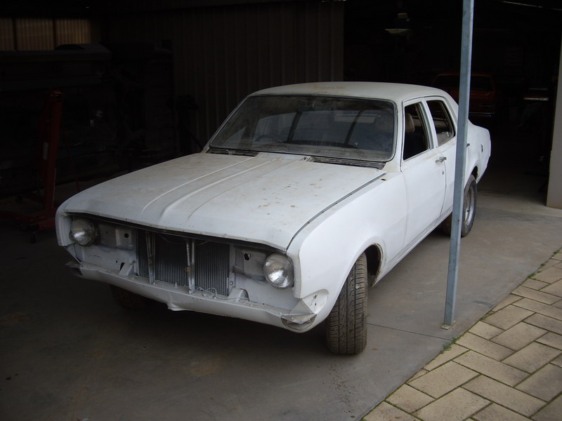

Thanks for the kind words, update time. Finished off the LX sedan, stopped work on the HT, new motor in the purple hatch just waiting to get it tuned
and gave the panel van some love.
Attached File  torana (1)_resize.jpg   155.02K   7 downloads
Attached File  IMGP2785_resize.JPG   142.82K   7 downloads
Attached File  IMGP2788_resize.JPG   143.06K   7 downloads
Attached File  IMGP2959_resize.JPG   145.64K   7 downloads
So brought some recaro SR2 seats which will get re-trimmed, made up a dolly to make it easier to move it around and started to set the panel
gaps and flares which will need some work.
