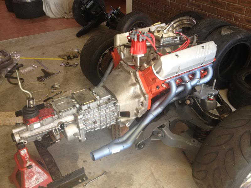

Welby here is a photo of my SLR engine (VR commodore Club Sport engine) with standard Holden factory extractors &Torana engine mounts. I have around 11/4" clearance to the rag joint. Hope it helps.
