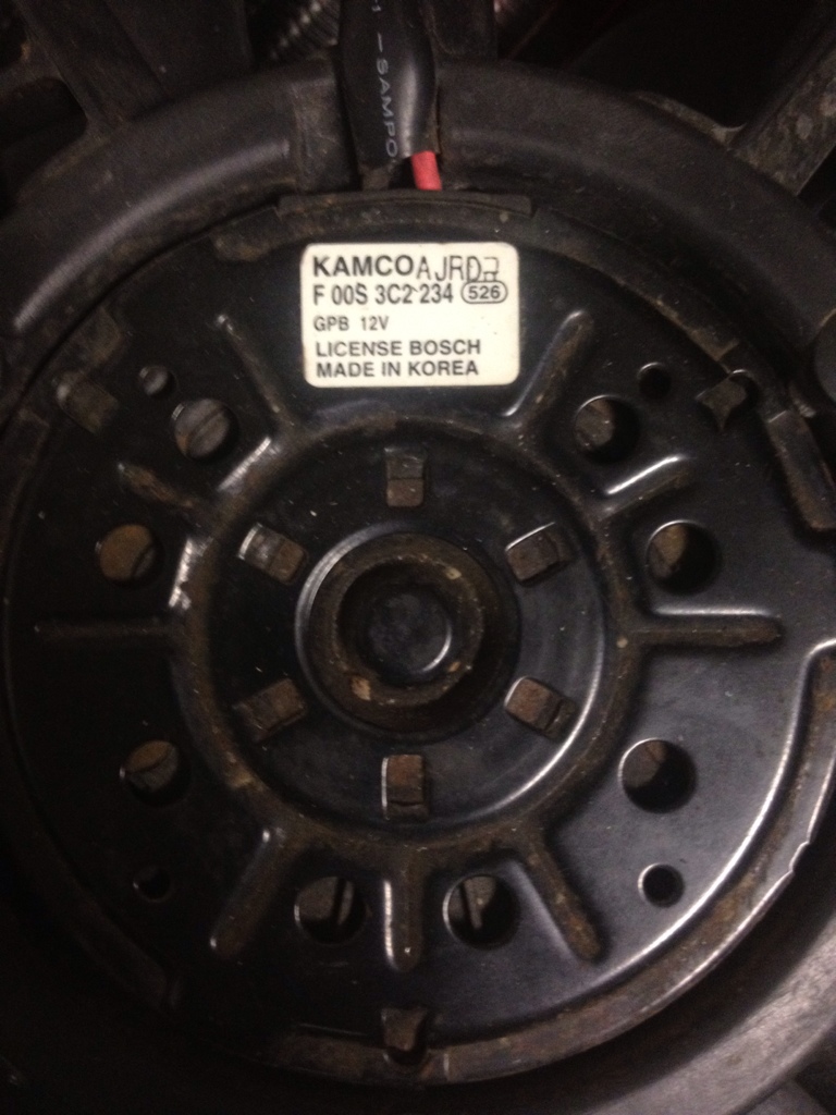

They do spin both ways ,I tried it today = if I put the wires Red---Red ,Black----Black the fans spin clockwise ( standing infront of the car)
If I put the Wires Red---Black,Red---Black they then spin Anticlockwise but im almost positve that both ways I could feel the air pumping toward the front of the car, which makes no sense!!!!?. I bought these many moons ago from Browns Radiators over here in W.A they told me they were original AU fans yet I see they have stickers on them " Made In Korea, Kamco ,licence Bosch" maybe these fans are knock off's just made all wrong!?
I have to re-test tomorrow,Im getting pretty tired of this car now..

I'll try as best I can to get a pic of the fans tomorrow and post some pics up I have already taken pics of the radiator/engine bay
Edited by 76S.L.R, 06 January 2013 - 10:41 PM.

You shouldn't need to have the engine running to test the fans. Just put the ignition switch in whichever position energizes the relays and remove the trigger wire from the thermo switch. Depending upon what type of switch you have the fans will either come on when you disconnect the wire or you will need to ground the wire.
The fan blades are pitched so they must push the air in one direction of rotation and pull the air in the opposite direction.
Using smoke to test the direction of the air flow would be better.

Ive just looked at Ebay Auctions for AU fans and mine are NOT AU Fans!!!,I was told at the time I bought them they were Genuine but are not
#156 S pack
Posted 07 January 2013 - 01:00 AM
Either you got ripped off or you were sold Genuine reproduction fake AU type/style/almost the same as fans.
In any case, whether or not they are genuine or not, the blades will/should be pitched. So they will/should function as I described 2 posts back.

If you have Bosch motors then you have original AU fans. The aftermarket fans do not have Bosch motors.

Put the fans on, and drop a tissue in front, that will tell you if they are pushing or pulling.

I just tested the fans by earthing the fan sensor wire and putting a bit of paper at the front of the radiator = it sucks the paper onto the radiator really hard!.
So they were actually spinning the right way in the first place!( im retarded,if I tested with paper in the first place I could have avoided all the messing about!) so theres nothing else left now but to assume theres a Crack in a head or a Head Gasket is Gone. Great,looks like its staying parked up again as I have no money left!!
