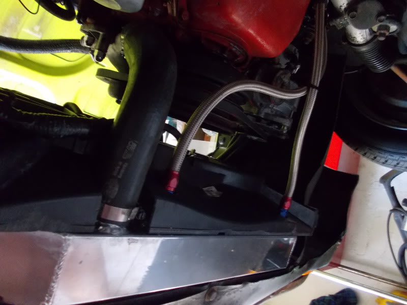

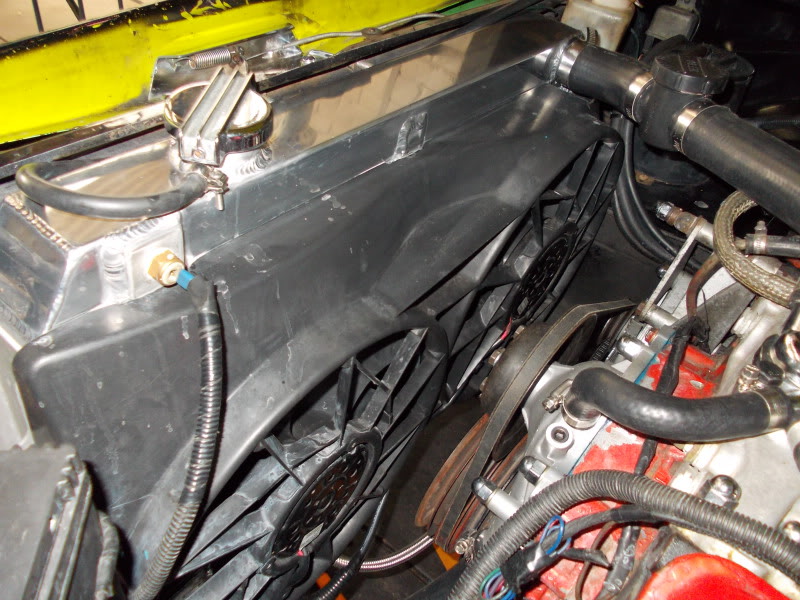

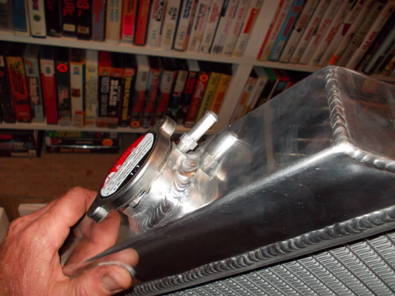

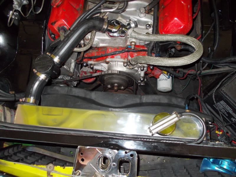

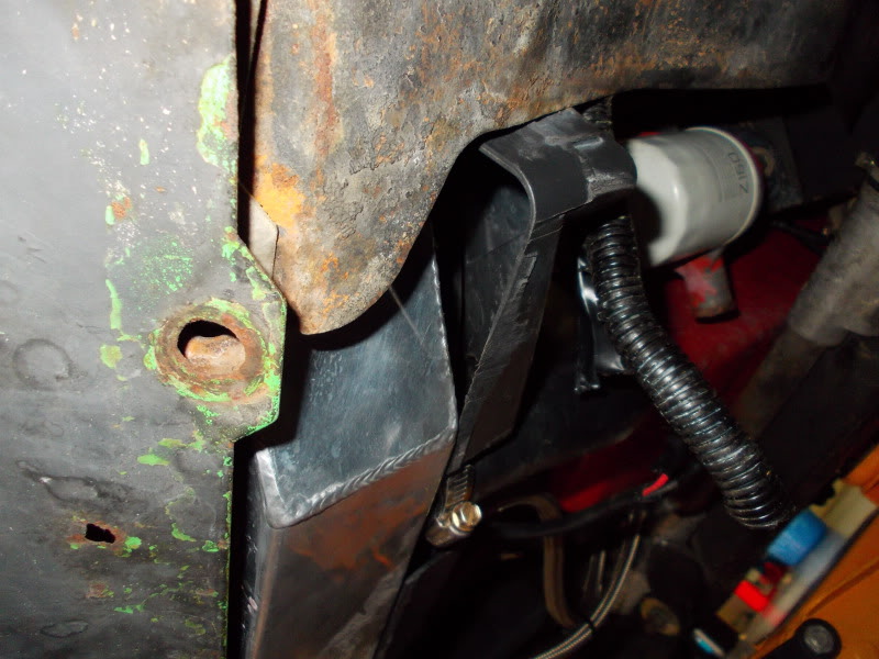

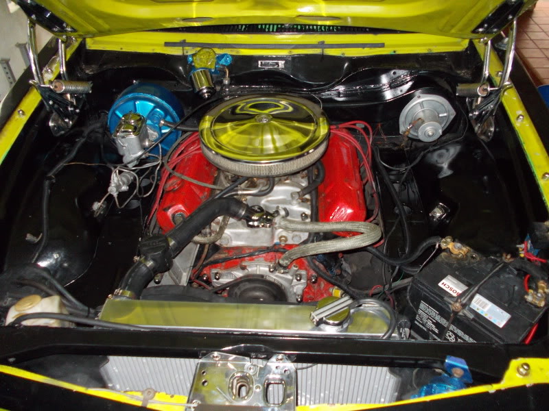

PICS AT LAST! ( photobucket been playing up!) and yes that big long thermostat bypass hose has been replaced with the proper factory hose now!
At some point ,looks like some time ago ,one of the water pumps has been rubbing here??!

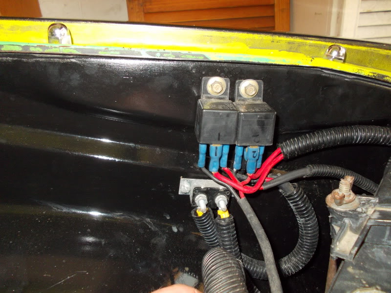

Relays etc for fans
Edited by 76S.L.R, 08 January 2013 - 12:46 AM.

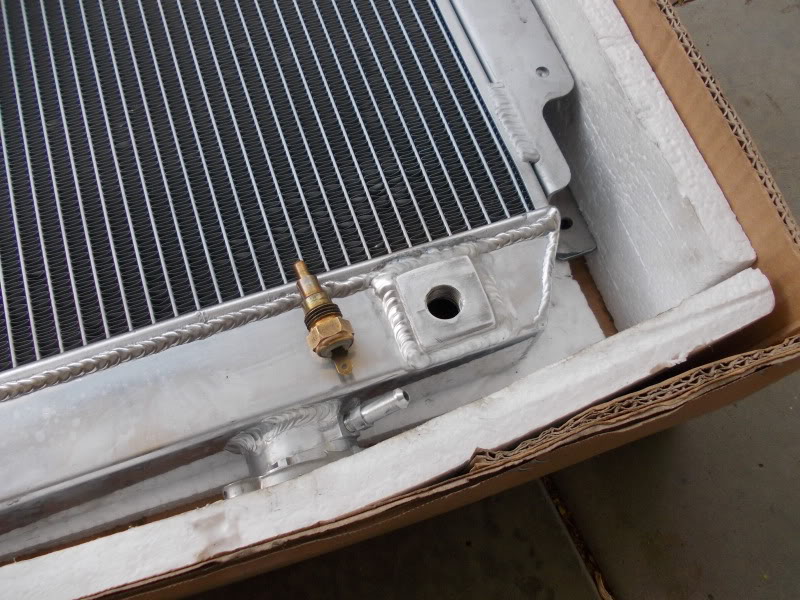

Altered radiator plate for fan sensor

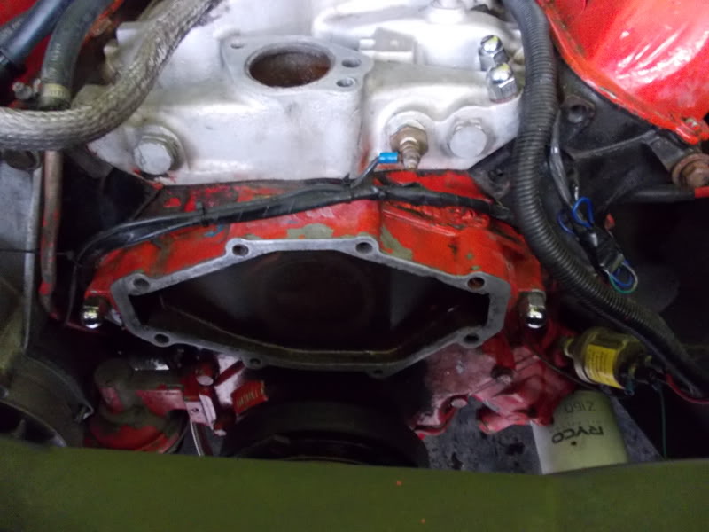

Posted 08 January 2013 - 01:15 AM
More Pics

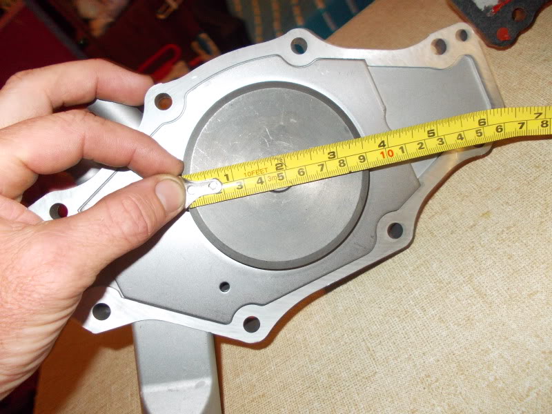

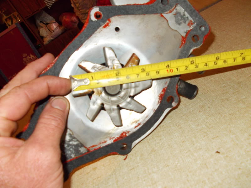

Old Tin Impeller pump
New Cast Impeller Pump ( 10mm wider Diameter)
Im guessing blocking up these holes will improve slightly??
Edited by 76S.L.R, 08 January 2013 - 01:21 AM.

#200 _The Baron_
_The Baron_
Posted 08 January 2013 - 10:43 AM
Yes.
Cut the corners off following the same profile as the bottom of the radiator and then blank off the exposed hole for a nice finish. Air flow will take the path of least resistance, blocking these off will help flow through the radiator.
