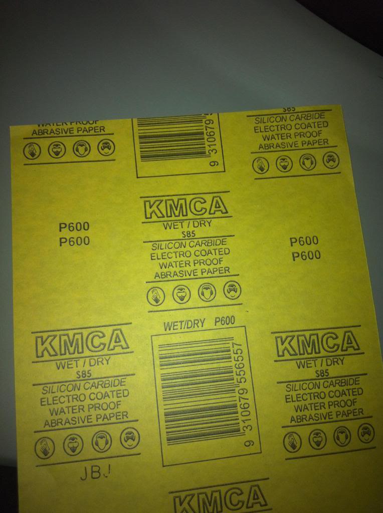

Before i took off to work I took a quick pic of the paper I'm using, I'm 95% sure this is the right stuff as I heard if you don't use that shit that starts with a "p" it can vary the outcome, let me know if this stuff is wrong?
http://s1131.beta.ph...html?sort=3&o=0
#82
Posted 19 February 2013 - 12:31 PM
Where do you buy your paper?
If your close to VG's maybe you should start shopping there.

Also, if your wet sanding use clean water and squeegee regularly (to clear the surface or waste)and rub sunlight soap into the paper to help prevent clogging.
If your dry sanding change the paper as soon as it's worn (also applies to wet sanding).
Don't try to rub the life out of the paper, just buy a box of the grade you need and change it often.

As bomber has stated on another thread I should sand 600 wet and throw more coats on, with that 600 wet do I get it flat with no peel before applying the next 3 coats? Or just sand to get adhesion? I'm guessing to get it flat but just checking with you guys first
#98
Posted 26 February 2013 - 08:10 PM
I usually go min 7 coats of solid acrylic for coverage and to counter for chopping back and buffing and/or flow coating.
if your doing metallic there should be no sanding between colour and clear.
#99
_chev400_
Posted 26 February 2013 - 08:40 PM
#100
Posted 26 February 2013 - 08:44 PM
Same as blocking the primer, the flatter you get it the flatter the final coat will be.
