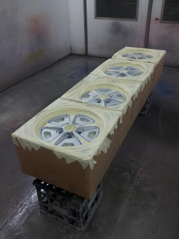

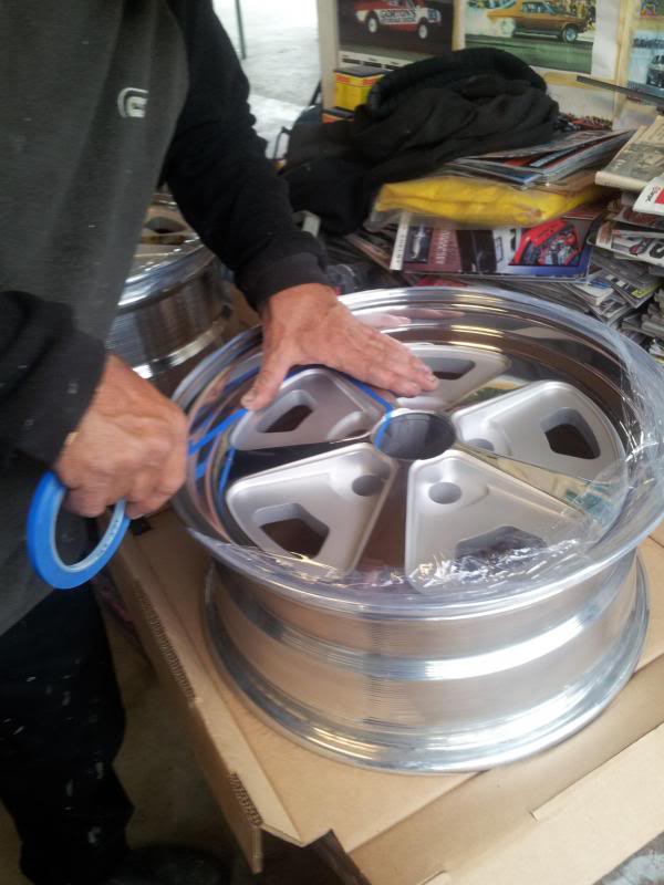

Have fun masking them up for painting Ryan. It took me 2 hours per wheel!! I also need to do mine again as some of the prep work wasn't quite right and the paint is coming off in a few places. So if you find an easy way of masking up let me know. I was thinking about putting a piece of clear contact over entire wheel centre and then cutting out the bits??

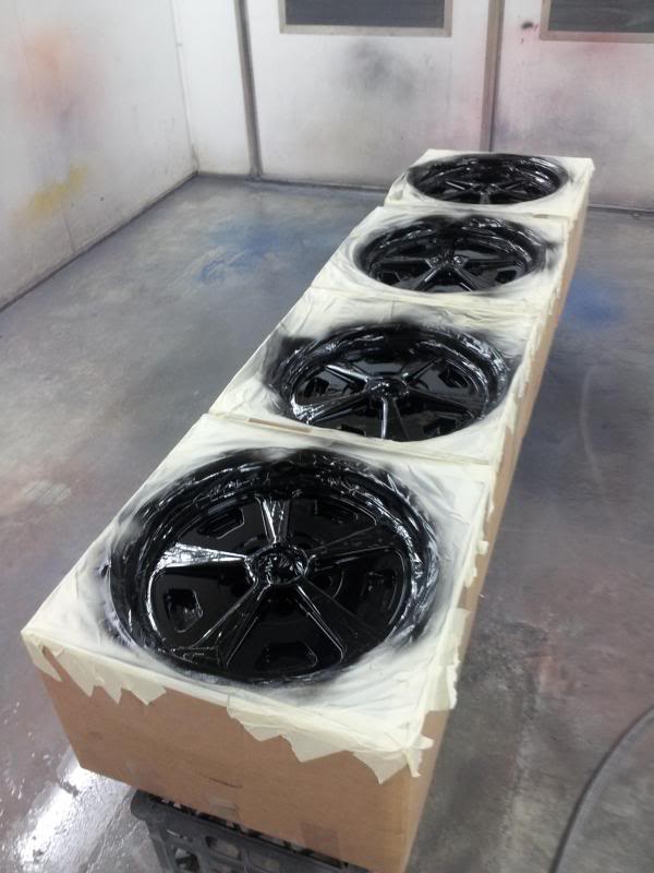

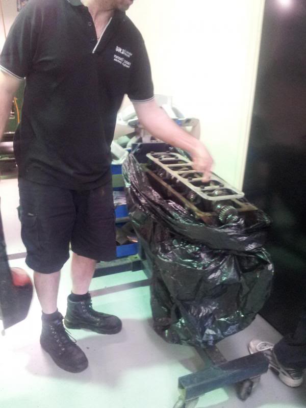

wheels have been painted and look a million bucks! very happy! will post pics tonight, I'm on my phone at the moment, we are on our way back from the engine shop, will post some pics of the shop also took dad about 30 minutes per wheel to mask up (but he's a spray painter). He used fine blue tape for the edges and then masked the rest with 2 inch and 1 inch masking tape, he then sat them in the boxes they can in and taped it up to paint them (easier than covering the rest of the rim) will post pics tonight looking at a poster on my wall of a pink blown torana 'front' and it has longbeach customs wheels and they look very similar to mine, only difference is the center cap from what I can tell Ryan,

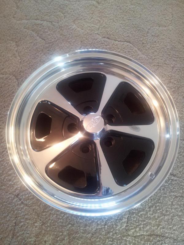

Posted 13 July 2013 - 09:48 AM

Nice :spoton:

Beautiful. Your old mans a legend!

very nice mate. cant wait to see these on, and with the drop spindles too.

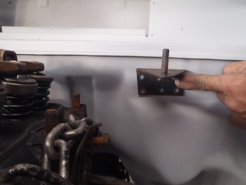

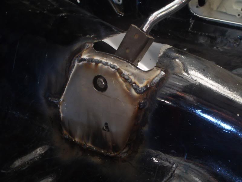

Also i found the original triangular throttle bracket, and it was spotwelded on
that nearly means its a gtr doesnt it? how would an lc S have a spot welded triangular throttle bracket?

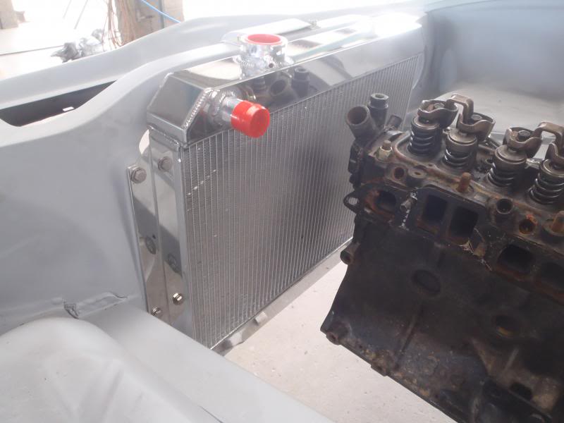

Had to make some modifications for the muncie to fit
And heres a picture of the spotwelded LC GTR bracket?

PWR radiator

That spotweld looks a lot like a finger!!
Was that on the car when you got it?
#250 _gorto_
_gorto_
Posted 04 September 2013 - 11:32 AM
Yeah it was, but we drilled it off as we're running sonic injection and wont be needing it..
Heard a story about the car the other day.. This guy reckons that it was a gtr and someone stole it and turned it into an S so they wouldn't find it? Would make sense why the gtr holes were bogged up and there were S holes on the side. Seats, gearbox and engine were also stolen.
