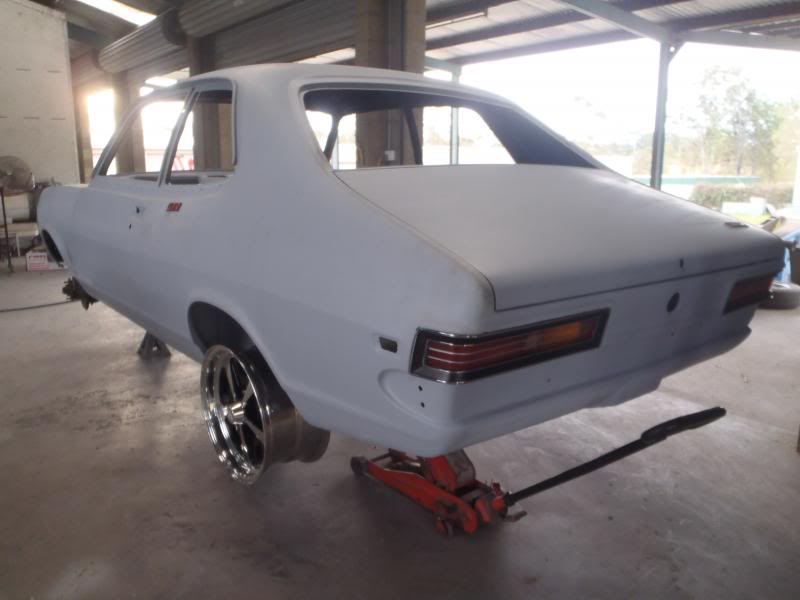

EDIT: The wheels were bolted onto a standard length banjo in this picture.. we just put them on for a picture (have got a custom diff made)

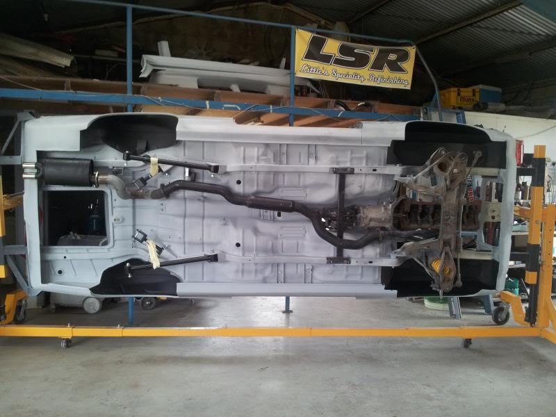

Here's a picture of the torana on the rotisserie that we got off ebay

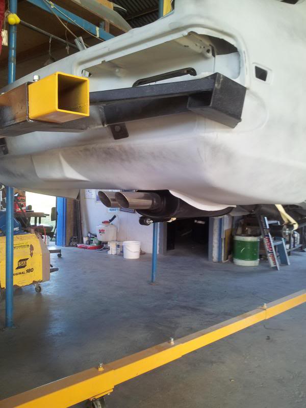

Posted 04 September 2013 - 12:50 PM
Opinions on the exhaust tip anyone? not sure..
#255 Ice
Posted 04 September 2013 - 01:02 PM
Look good to me

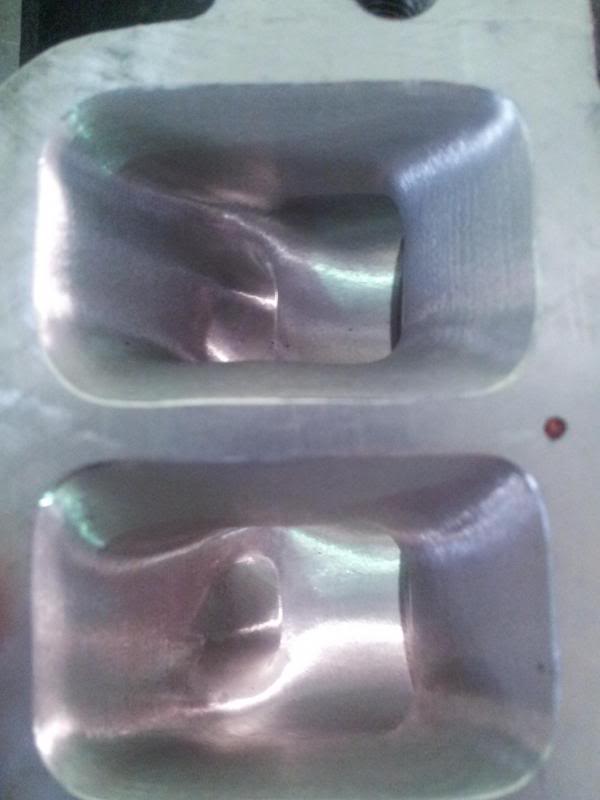

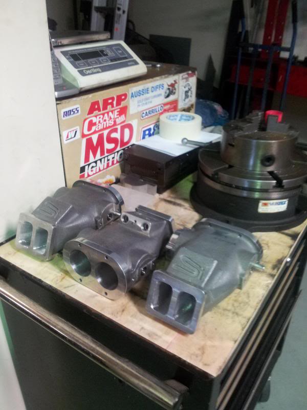

The injection has been pulled apart by the engine builder and ported, still got a little bit more to go
Heres a picture of the head after porting

Posted 04 September 2013 - 05:42 PM
looking good, i should have bought one of those manifolds instead of webers..
#258 _gorto_
_gorto_
Posted 04 September 2013 - 09:44 PM
manifold cost is similar, but then you have to factor in fuel delivery, wiring, sensors, cpu etc. gets real expensive, real quick.

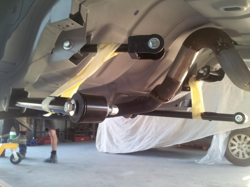

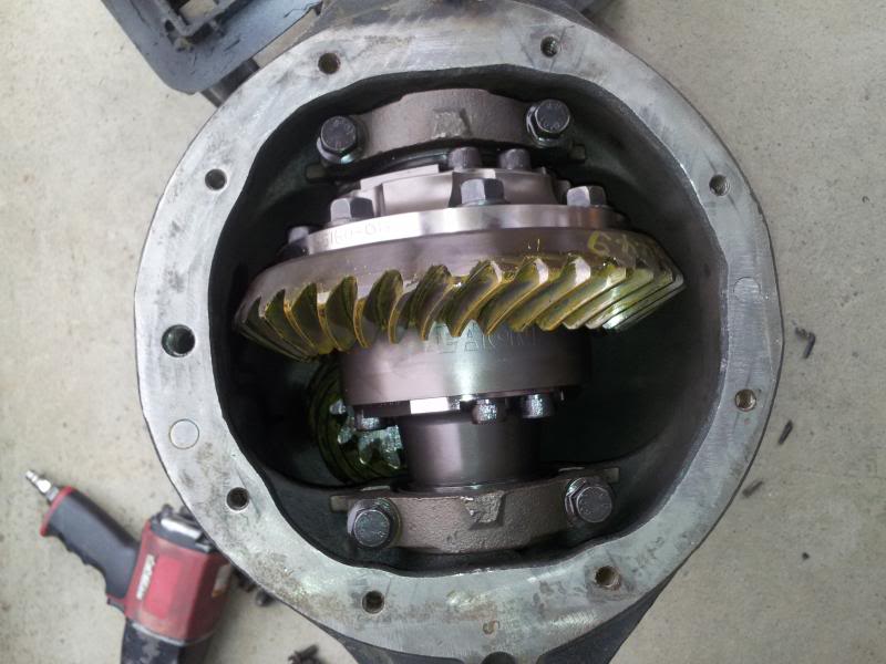

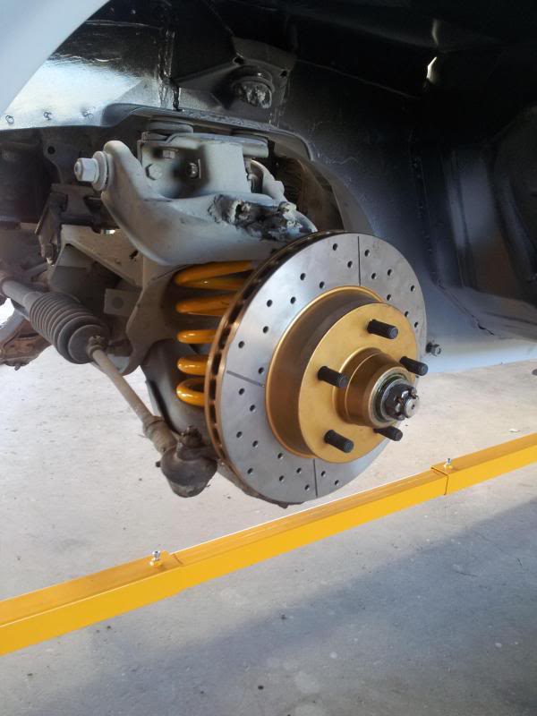

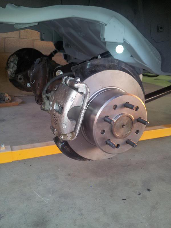

Heres the front end assembly to get the 16x7's to fit
2inch drop spindles (so we can still run standard length springs but have a lower ride) and dba gold ford leyland p76 disc (brings wheel-track in 7mm each side) with a custom made spacer to fit the bearing

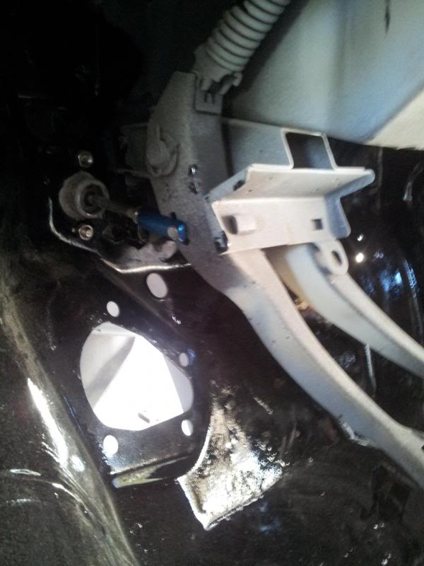

hydraulic clutch set-up that we used, had it lying around from dads old sprintcar
A9 altrac powder coated chrome molley adjustable arms
Custom length Borg Warner with chrome molley tubes with billet 28 spline axles and commodore brakes
Harrop/Eaton truetrac diff centre
Re-priming the engine bay, for the last time (i mean it this time!)

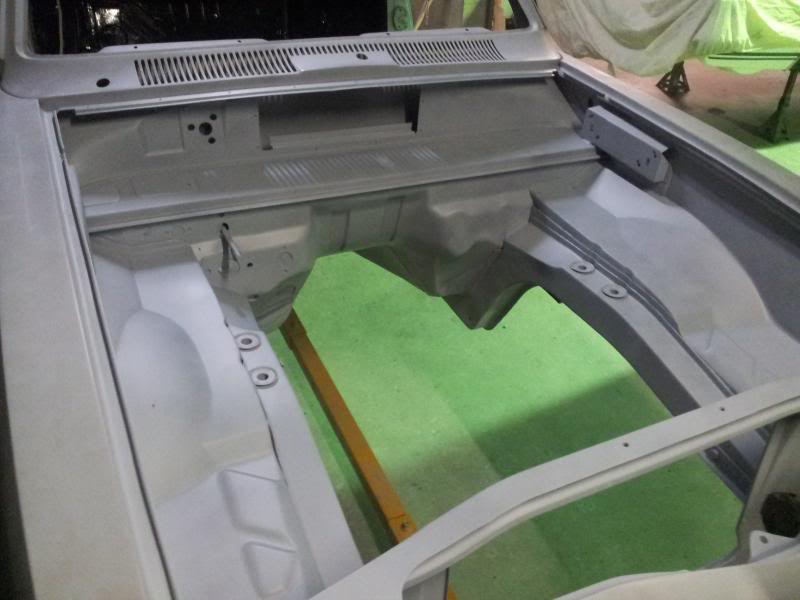

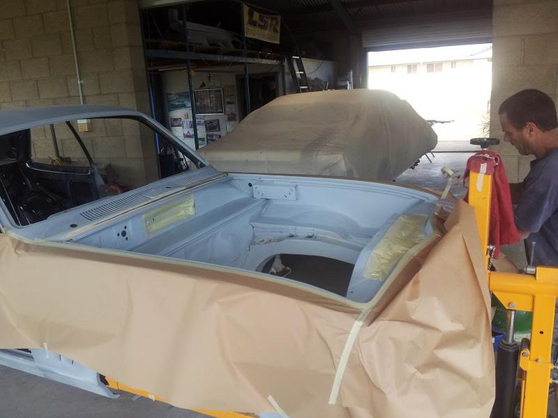

Posted 05 September 2013 - 09:33 PM
engine bay once primed
Sanding the floor with his fathers day present between his legs haha
