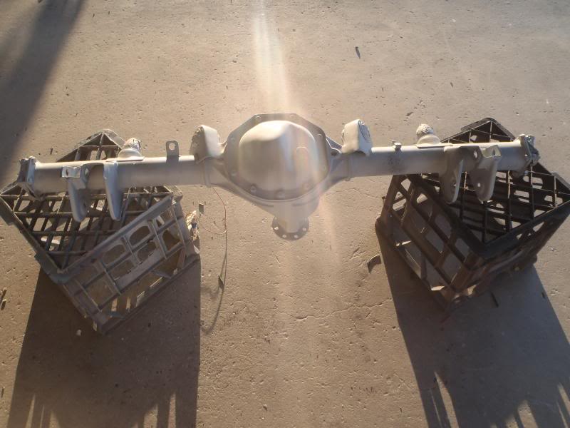

BorgWarner has been primed

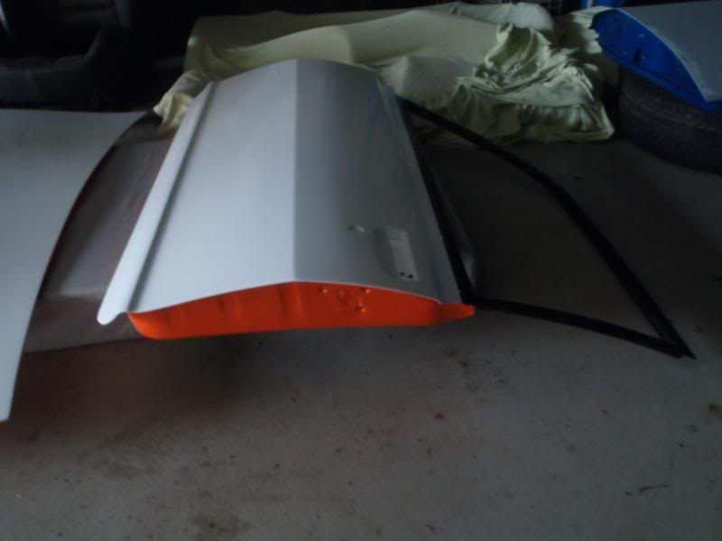

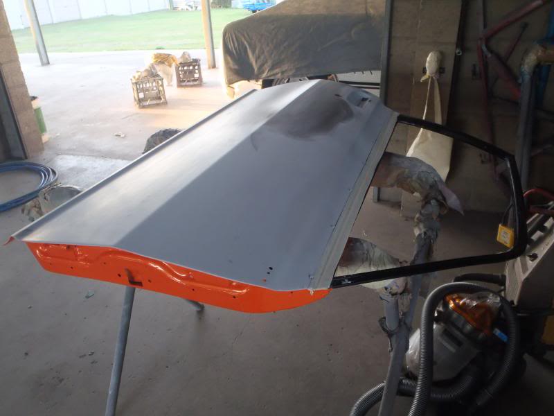

Posted 17 September 2013 - 09:03 PM
after many hours of staring.. dad decided that he wasnt happy with a section on the RH door
Edited by gorto, 17 September 2013 - 09:04 PM.

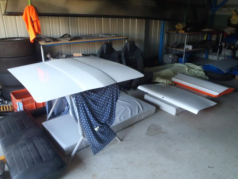

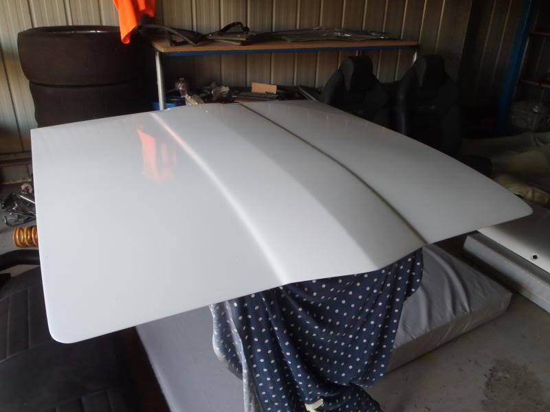

Posted 18 September 2013 - 07:08 AM
Panels have been basecoated in House of Kolor white basecoat
