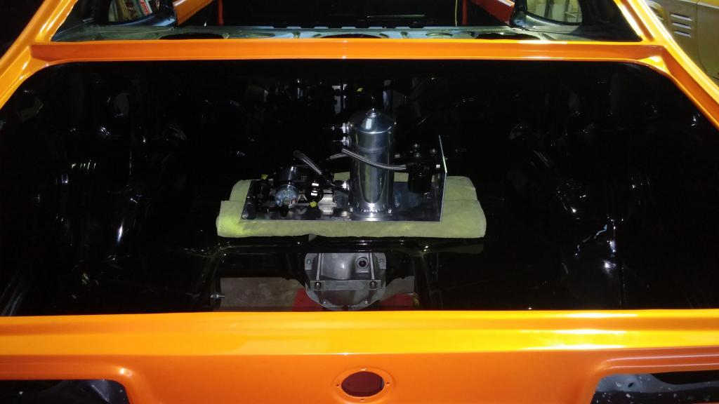

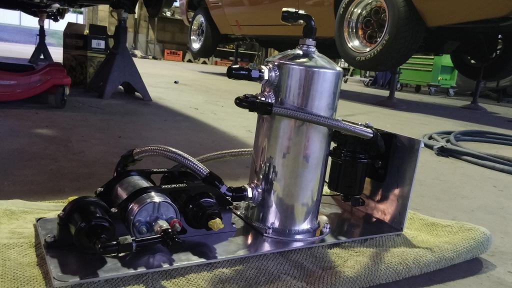

Spent a few hours after school dummy fitting the fuel system. Got an alloy plate bent up and the carter gold, 044, surge tank and filters fitted and the lines made up. Took it all apart now and going to weld a gusset on the plate so that it doesnt vibrate with the pump mounted on it and polish it all up.

Cool, looks good. And what is that weapon in the background of pic number one? :-)
#637 _gorto_
_gorto_
Posted 11 March 2015 - 04:35 PM
Thanks!
That is dad's mental HQ monaro.. Owned it for 22 years. Its 90% way through a new driveline build, gt47 540ci BBC built by the same guy that is building my 202. On the engine dyno it made 1470hp at 6k and only 13psi.

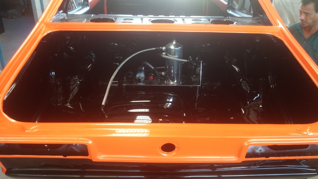

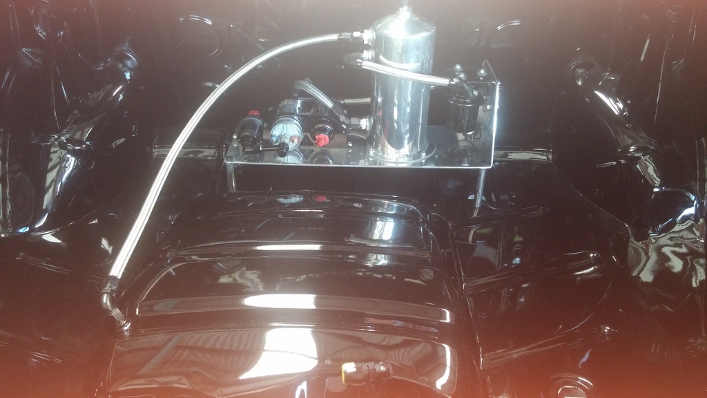

Here's some more pics, nearly done. Need to do a breather now (going to do it in 5/16th instead of 3/16th).

i dont think that your car will pass a roadworthy with the fuel system in the boot.
#647 _gorto_
_gorto_
Posted 12 March 2015 - 05:11 PM
Car will be engineered, so dont think it will matter. As long as the engineer passes it all good I assume.
#648 _gorto_
_gorto_
Posted 12 March 2015 - 05:23 PM
If the engineer gets picky (not sure who it will be yet, used to have an engineer that would tick it off easy, but he has retired) I might have to put it in a sealed box. But hopefully it's fine and I just have to have the breather venting to the atmosphere.
