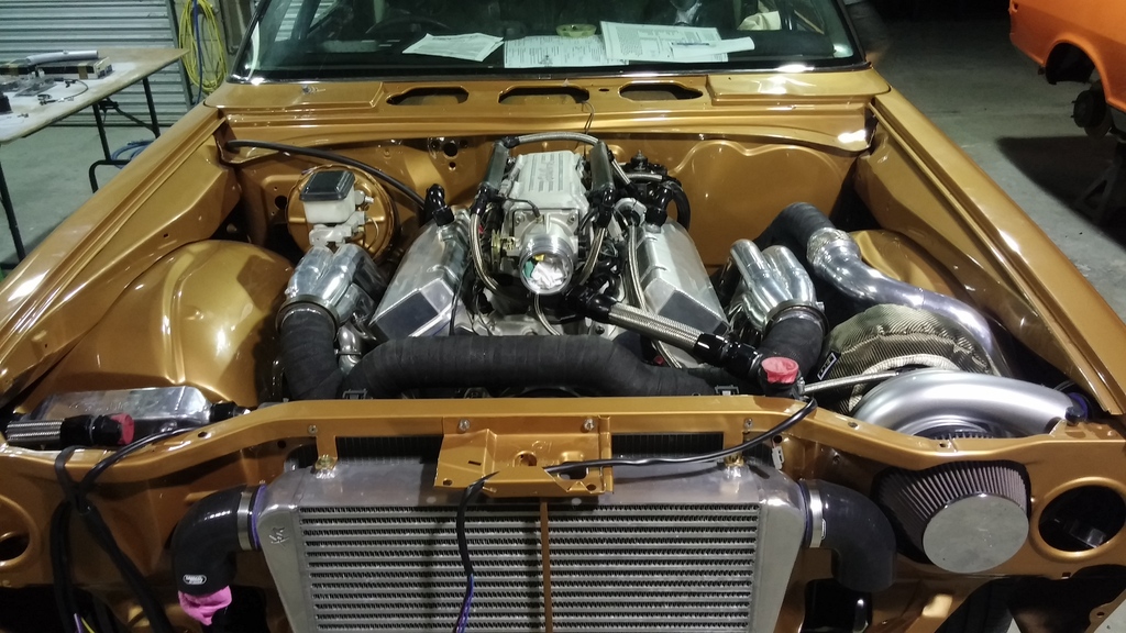

Here's a pic of dads monaro for you SmacT
Holy crap - that looks pretty special. :-) Thanks for that. No wonder your car is so nice with that kind of hardware in your genes.
Yeah its nice, his first turbo engine in the coupe. Has had nearly 10 engine config's over the past 20 years.. haha. 2 350's, an injected 400 chev, another 350, a 496, then the 496 with a vortech supercharger, then the 588 and now this!
