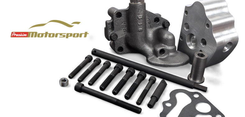

Ditch your twin gear style Holden V8 oil pump and upgrade to a superior gerotor style Melling pump today. This kit adapts a big block Mopar oil pump to your Holden V8 and will give you consistent oil pressure from idle to max RPM.
Holden 308 Oil Pump Conversion Kit >> BUY ONLINE
As always feel free to send us a PM or contact us at the following details for any enquiries:
Phone: 1300 364 350
Email: enquiry@precisionintl.com
Website: www.precisionintl.com
Edited by TerrA LX, 02 November 2013 - 07:06 AM.

Reselling, say's it's available through Precision International or Hercules in the Street Machine article.
