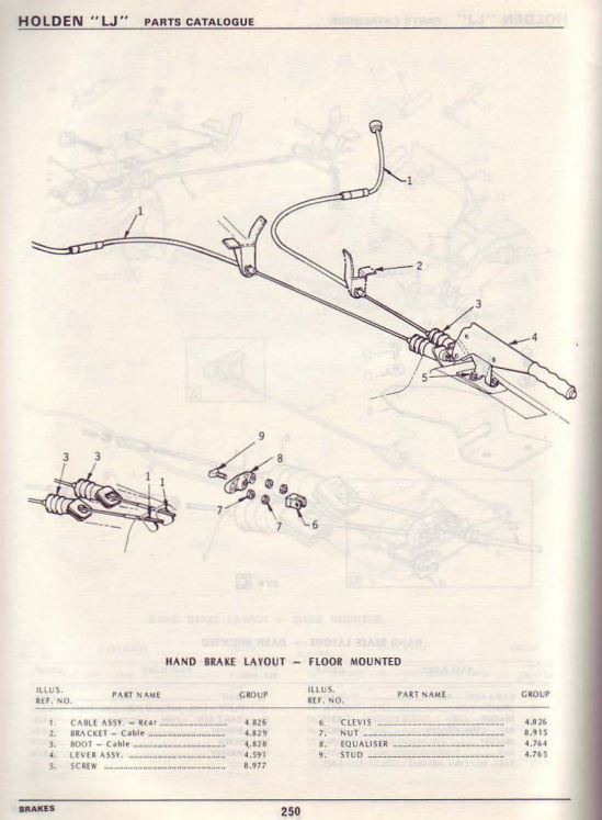

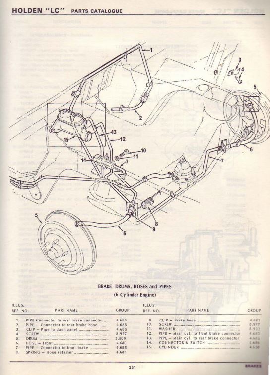

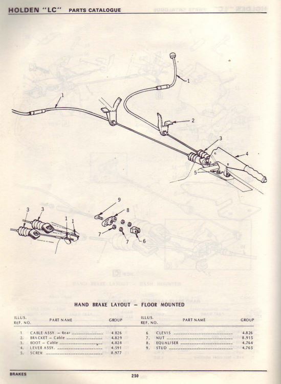

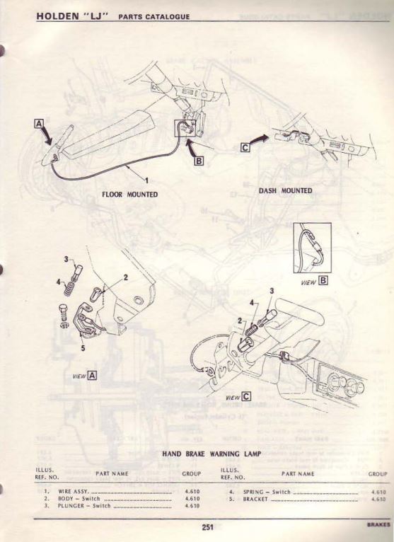

Posted 30 September 2015 - 01:11 AM
LC Parts Catalogue
LJ Parts Catalogue
