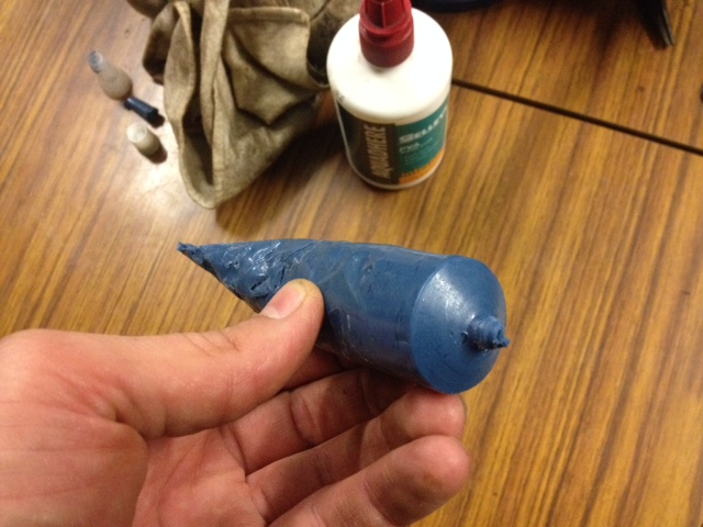

I put a dob of wood glue on each terminal to act as a bit of insulation, last thing I want is a short under the car.
Attached File  photo 5.JPG   121.18K   2 downloads
I was going to use some blue gasket maker stuff for insulation but it was a bit hard to spread.
