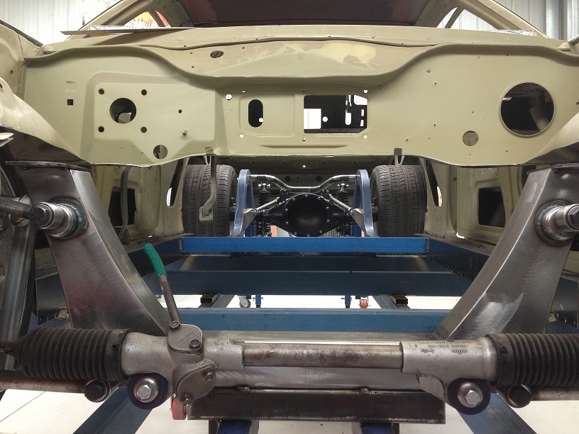

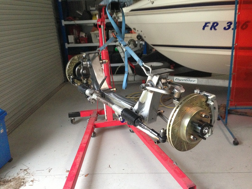

So they finally finished it. Its been over two years since we first loaned them a spare K-frame, but realised a year in that straight line drag racing is their only forte and they simply don't understand fast cornering or inside outside weight transfer under cornering  and braking loads, let alone roll centres, instant centres, having separate caster camber adjustment (no shims)
Be interested in reviewing the measurement specs to confirm my thoughts. But I will stand corrected as it sure doesn't look like it will offer much improvement for corner carving over the Massey Ferguson suitable standard torrie set-up.
Good for drag racing and make it easy to fit 90/10 coilover shocks. Still looks like it is a carbon copy of the fatally flawed 70's geometry errors.
I just don't see why anyone interested in corners would be interested in spending $4.5k just to gain a few slight subtle benefits. I think with the drag racing fraternity its all about bragging rights WOW look I have a custom built K-frame front end with coilovers..
Its quite ironic that forever the yanks had no idea about going fast around corners and awesome braking, yet now here they are today with the hottest market being Pro-Touring where they are putting real geometry into those old 50's,60's and 70's muscle cars that in the old days could only really go fast in a straight line.

Honestly they arnt built for targa racing. If you building a pourpose built race car your not guna go down to autobarn and by speco stuff are you. They are more for streeters who are lookin for coil overs or airbags, theres abit more adjustment in them and they look heaps better than the standard splatter and you can fit big brakes easier. Just my opinion. If i was going racing i wouldnt have brought one

We are in 2013 and suspension and geometry knowledge has made enormous inroads and rightfully it has crossed over into the hotrodding of 60/70's muscle cars.  It actually has nothing to do with racing its all about angles although obviously using good 2013 geometry knowledge and the far better tyres (that we didn't have in the 70's) means we can not only can get around corners in a torrie far faster than Brock ever could, but we also don't have to worry about our kidneys being forced up into our throats when we hit a rough road. The whole idea is to keep your tyres in max contact and yet not ride like a billy cart in an attempt to get the very poorly designed std chassis to work
Now this is not to say that some people hotrodding a torrie don't want to keep all the 70's foibles.
You are correct all these replacement K-frames are built with one design goal in mind.and that is style over substance , but that's my whole point ..... is spending $4.5k worth that gain?
What also is troublesome as per CRS is what real R&D is going into these things because all the so called certified safe means zip if it doesn't fit even using a common engine? Certainly wouldn't give anyone peace of mind knowing that their safety has been designed by someone that can't even make it bolt up.
I just question what I am seeing being sold as hot-up bits as being poor / no real engineering, overpriced and zero back-up support responsibility by the seller. It would seem the vast majority of businesses are taking advantage of the interest in doing up old cars and dishing up rubbish that's only claim to fame is its expensive rubbish.
