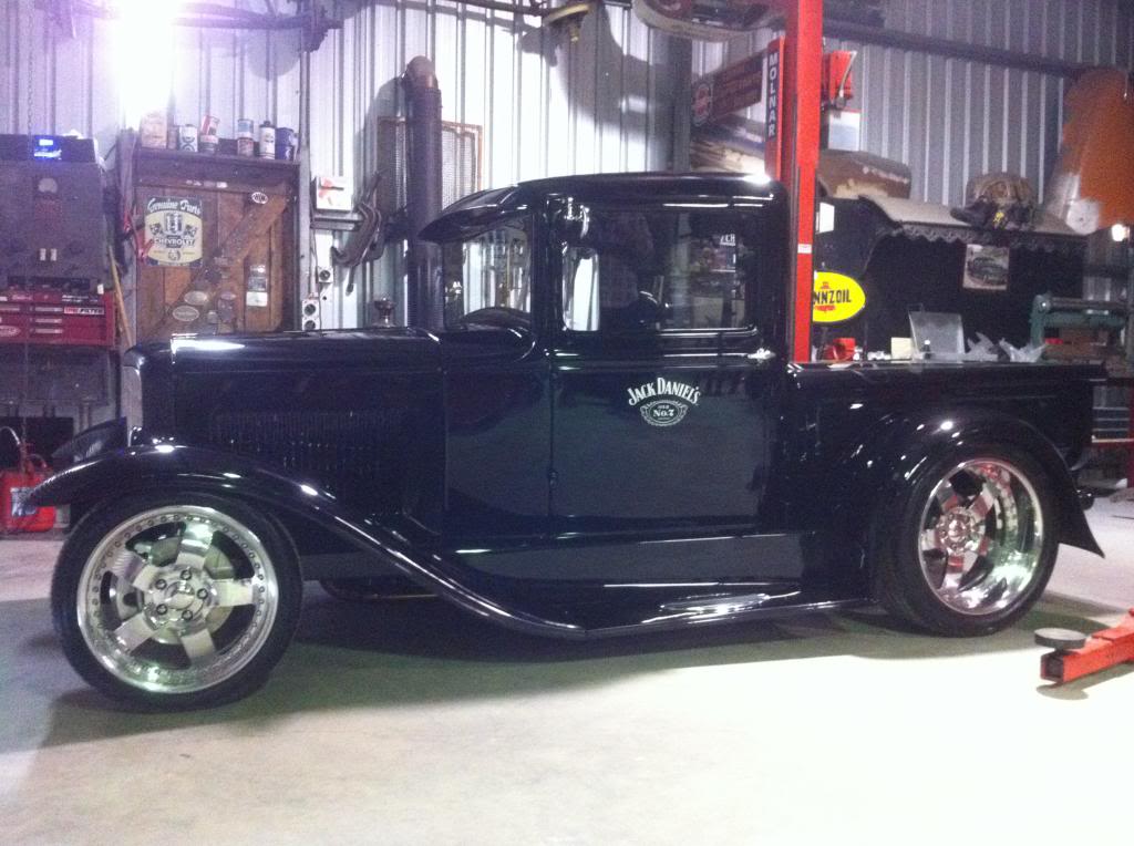

Depending on what chassis youve got you can buy a front end that will bolt or weld straight in. Jump on my profile and look at my hatch in the vehicle section. Thers a couple of pics of my front end. Just a thort, my mate just fitted one to a mustang and we not long ago built a 31 model A pick up for jack daniels as a promo give away car and it had one of these front ends to. I realise your in perth but im sure if you were keen we could sort something out

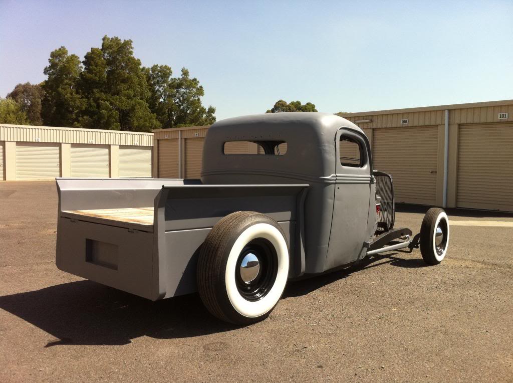

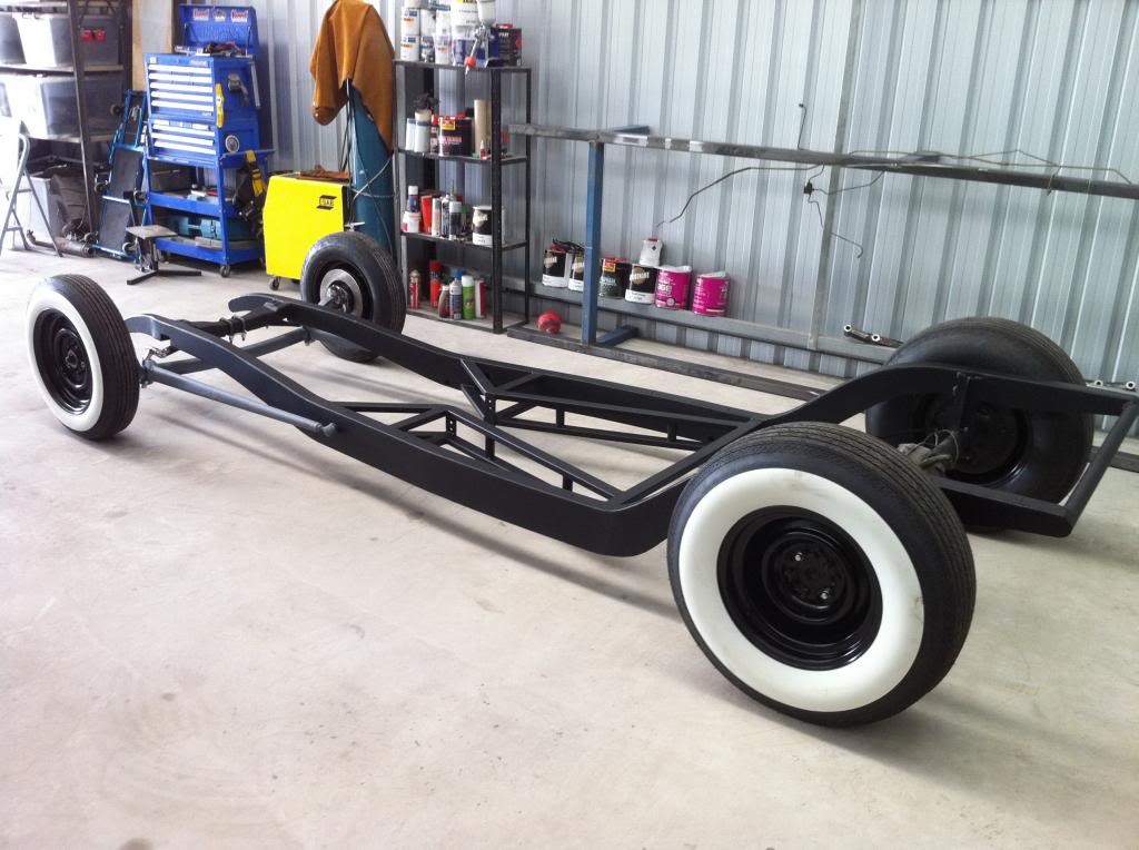

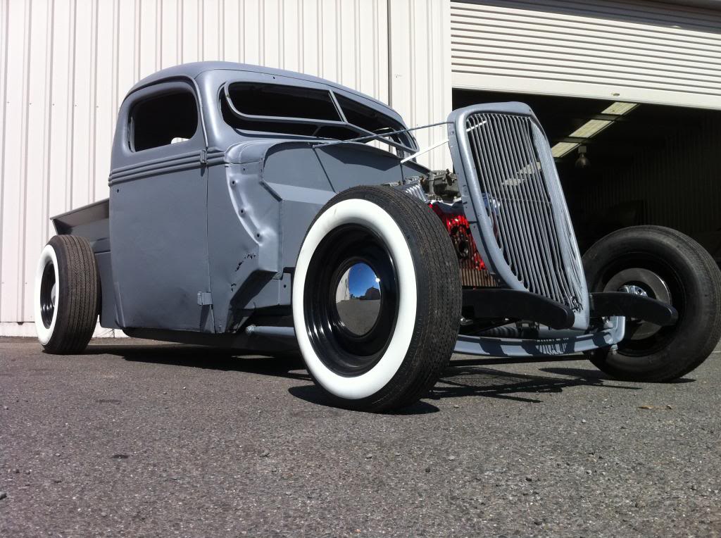

yeah cool there a good looking rocket,(minus IFS lol sorry) The good old I beam would be less work and probably cheaper tho wouldnt it? get an original axle dropped or buy a so cal 4' drop one, alot of guys use hq rotors with vr-vs commodore calipers which look kinda cool cos the are sorta finned.Buy hair pins or split an original wishbone, a set of perch bolts and a spring and off you go, depending on weather or not youve already chopped it up most the stuff should be there already. I started building a 38 ford pick up awhile ago but had to sell it to fund other stuff. Ill try and find a pic or 2.
#114 _NewsuxLX_
_NewsuxLX_
Posted 15 January 2014 - 08:00 PM
IMG_0461_zpsed239824.jpg[/URL]
IMG_0498_zps8f432836.jpg[/URL]
IMG_0507_zps8c07a411.jpg[/URL]

Posted 15 January 2014 - 08:02 PM
IMG_0919_zps704fe86c.jpg[/URL]
Not a real good pic but this is the pick up we built for the jack daniels promo give away

Loving that 38. The ultra subtle z on the front end is perfect.

thanks Bomber, i didnt wana sell it but had to. id like to build another one day
