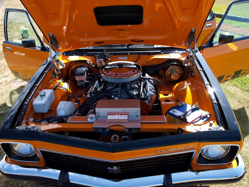

Ok heres what you've all been waiting for.....The Start Up of Rusty The Torana.
Actually this is the second start......I done the cam run in first without videoing it cause its just too busy keeping an eye on oil pressure, temp and any leaks that may occur.
Rusty started first kick and got oil pressure instantly......I primed the system by using a fitting in the oil sender hole with a piece of rubber tube attached then proceeded to use a pump oil can to fill the system until I got oil right up to the rockers...it was easy and filled in no time.....replaced sender and away she went..
The engine runs nice and sounds great but very loud....no exhaust yet but thats coming.
Im running VN heads with stainless valves....H286 cam....LT1 valve springs....flat top pistons..... torque power dual plane manifold ... roll master timing gear...... Quaddy and extractors.
Compression ratio is 10;1 as quoted from my engine machinist and all is good so far.
Just a couple of questions.....what would be the recommended spark timing..... initially and what Idle rpm would be right for this donk.
Any way heres a quick vid of the start up
https://youtu.be/1aqTQHkH0t0
Al

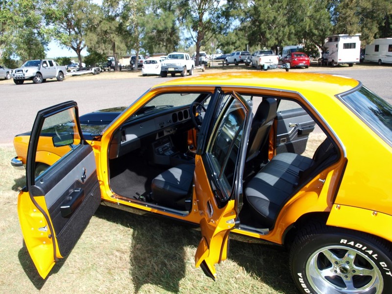

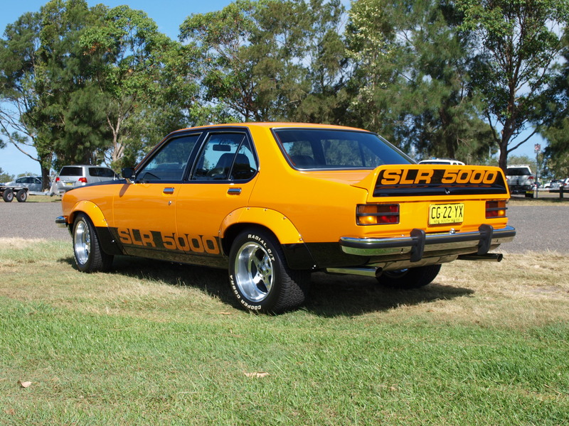

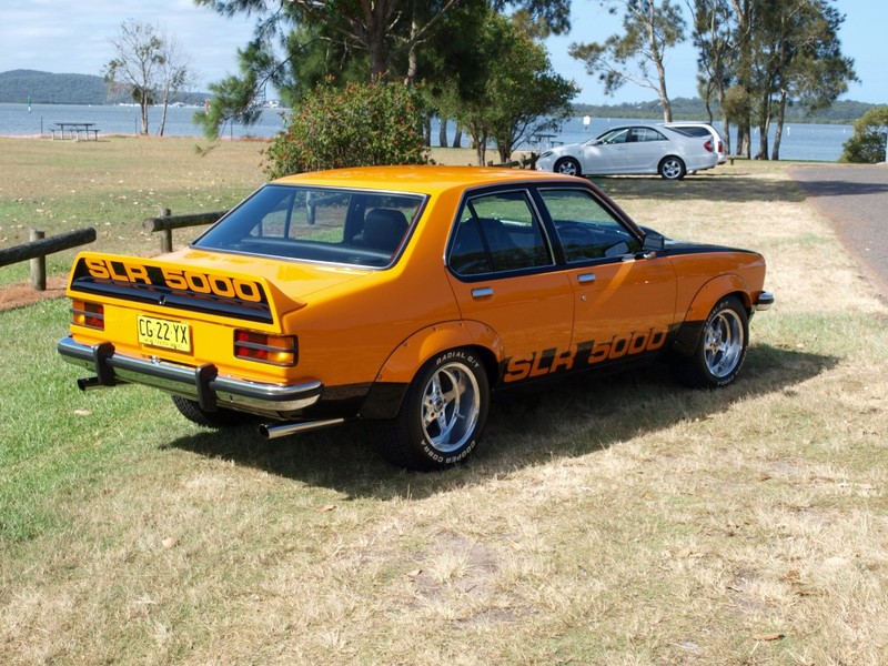

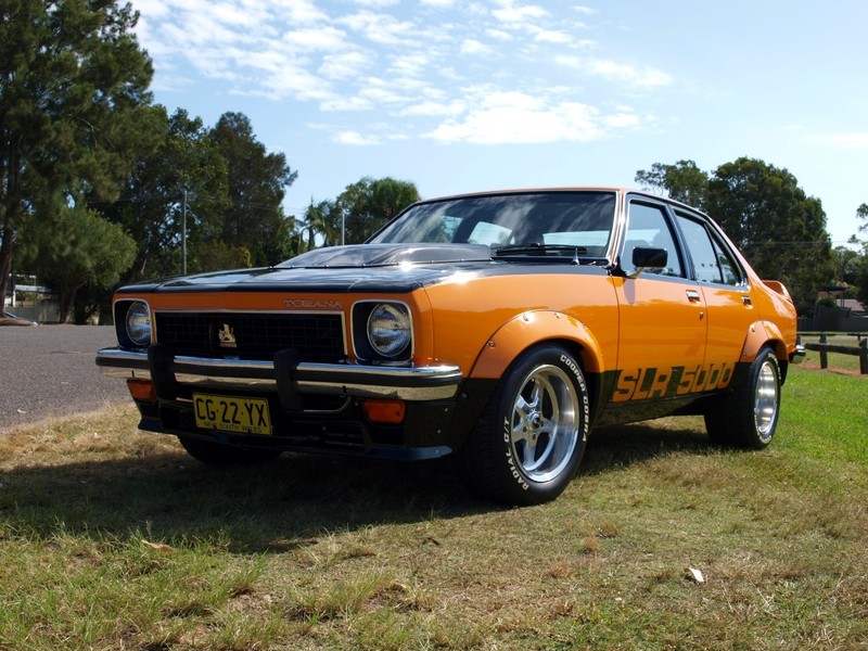

Ok here's my final update on Rusty's rebuild thread
I went for a rego blue slip (NSW) last week and passed no problems at all.......so Rusty is finally on the road after 8 years.
Its been fun doing the car but I sure am glad its finished....now its time for a rest.
I spent just under $26,000 on her but thats not including my time.....just materials and parts.
I manged to do all aspects of the car myself except the exhaust system and engine machining so I managed to save a packet doing it myself......and I must say It came out really nice.
Just like to thank all of you guys that helped out with advice and parts over the years......it would be nearly impossible to do this without your help.
So here she is...finished and registered
