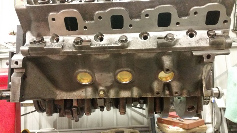

Finally the engine was ready to pick up.....square decked 15 thou...bored and honed 20 thou over.....new flat top pistons.....hastings moly race rings......hot tanked.....all new bearings.....linnished crank ......new fly wheel.... crane H286 cam.....new push rods and crane lifters.....all rotating assembly balanced and he got it to 0.5 gram overall says the balance computer readout sheet....pretty impressed with the quality of work done and all was spot on.
And yes its all been hot washed with soapy water and cleaned and blown out till no black on the rag from any area.
Got the crank installed...clearances where perfect and end float was 5 thou
Ringed up the pistons and installed them
Time for the camshaft.......checked the cam with a degree wheel to ensure the timing as per cam card was very close.
Ended up 1/2 a degree from spec....close enough for me ....used  a new rollmaster timing chain and sprocket kit with mulit keyway but didnt need to advance or retard so its set to 0 position.

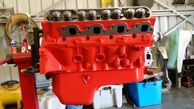

Got the heads on and tensioned up.....all is fitting very well
Installed all new brass welsch plugs....cam plug and gallery plug

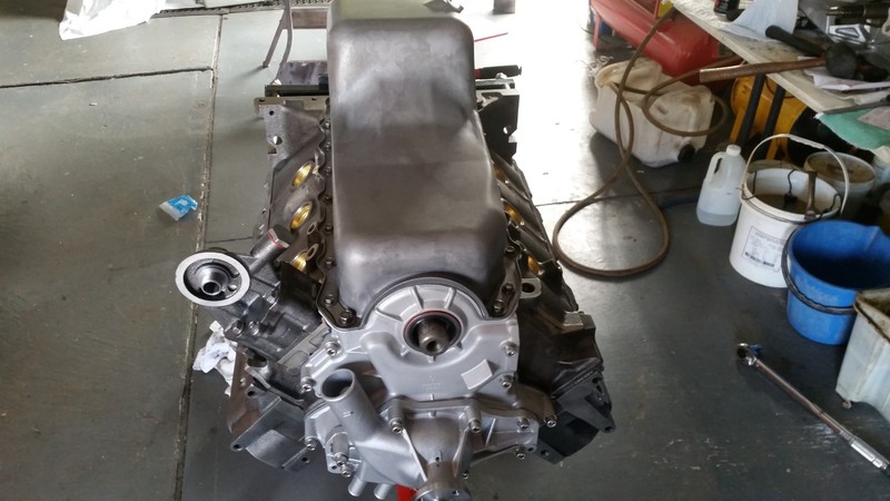

Fitted up the new sump with a one piece neoprene gasket......it fitted perfectly...was a bit worried since its aftermarket.

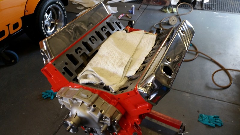

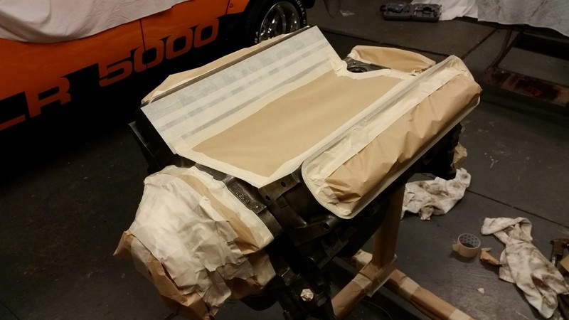

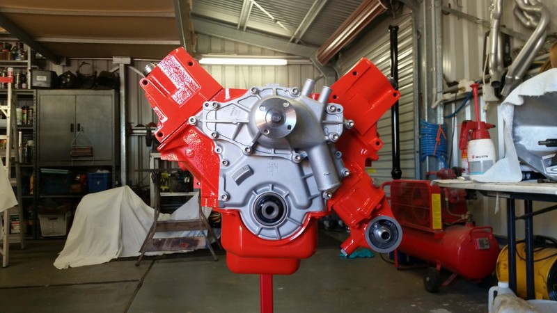

Ok all looks good....time to mask her up ready for paint
Hit it with a splash of 2k Rocket Red after etch priming it and there you have it....beautiful.

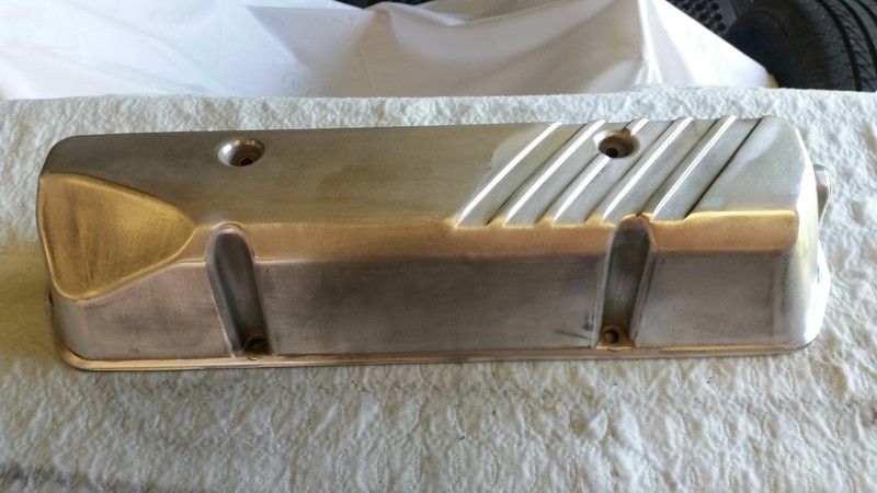

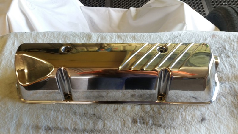

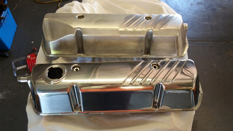

Rightio I decided not to paint my rocker covers at all...instead I hit them with a DA sander and a bit of wet and dry....removed all the factory paint and polished them.
They came up a treat......took 4 hours to do both covers but you"ll need a dremel with polishing wheels to get into the tight areas......other than that Im pleased with the result.
Before...after sanding
After....about 30 mins worth of polishing on bench grinder buff wheel
Both together
Quick mock up...looks good
