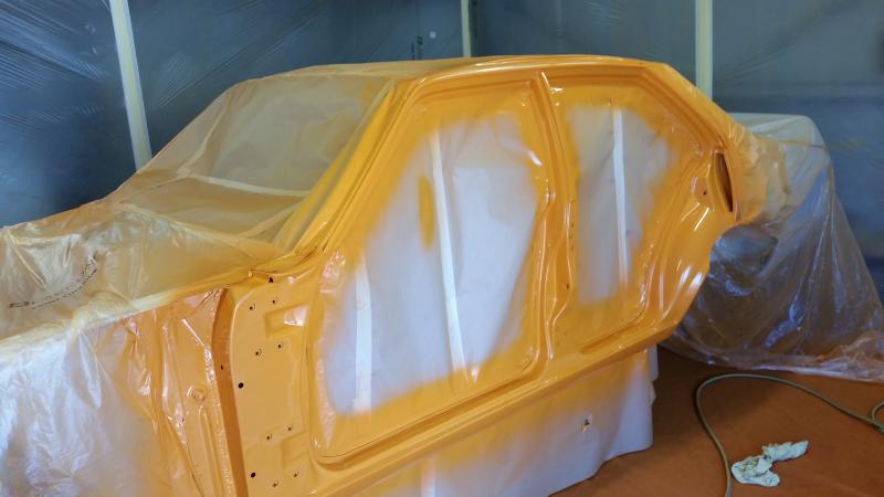

Ok time for another update........been busy blocking and painting the last few weeks in between going to work and now starting to see results of a seven year resto on old rusty.
Painted some satin black on the front apron and chassis rails
Finished the door appartures and sills ready for the blackouts.
and finally got the shell of the car painted....it came out great...good gloss off the gun.....love PPG paint.
Heres a little vid just after a colour sand and buff

Great job on the body AL & the paint has come up like glass, a real credit tot you mate !!
Actually it looks better than great it's spectacular - well done.
Looking forward to see more progress pics
