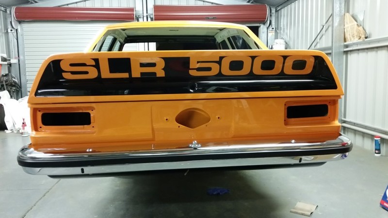

Awesome build AL, top notch effort the paint sure went on well and the stencils look great.

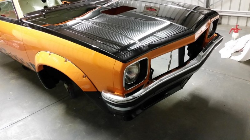

OkiDoki....been away from here for a while so I thought it might be time for another update on Rusty the Torana.
Been working on Rusty every weekend and Im slowly making progress and I mean slowly lol......so heres some pics of what Ive been up to.

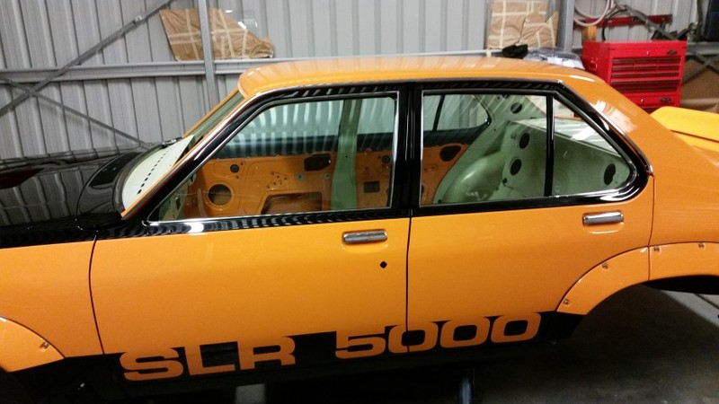

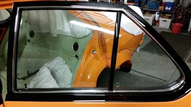

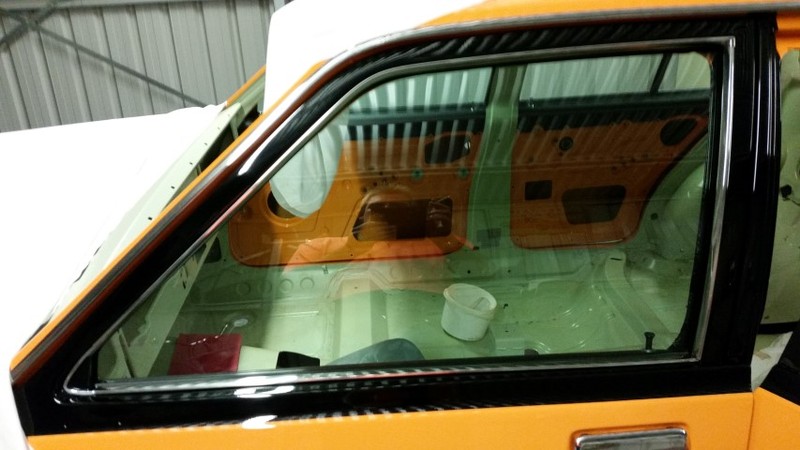

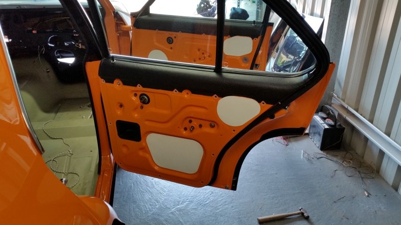

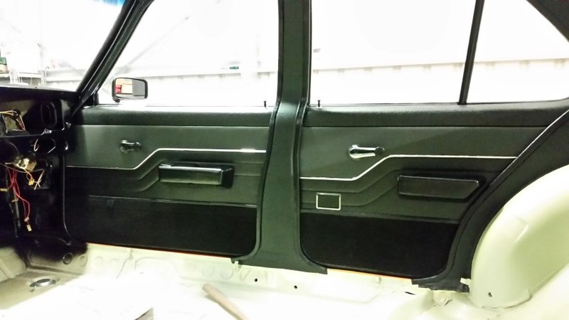

Finally got the new side glass and internals installed in the doors. Bought the new glass from Classic Glass in Queensland.....tinted and fits perfect.
Also installed all the side stainless and gutter trim.....used the rivet type clips for this....but easy to do

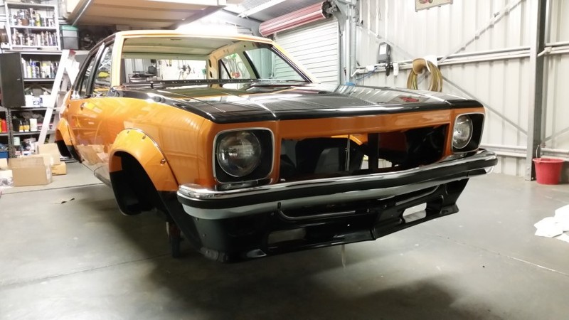

Ok  next bumpers and headlights
Then onto the interior.....starting with the head lining.....bought that from Boomfunk......looks nasty but is actually perfect.

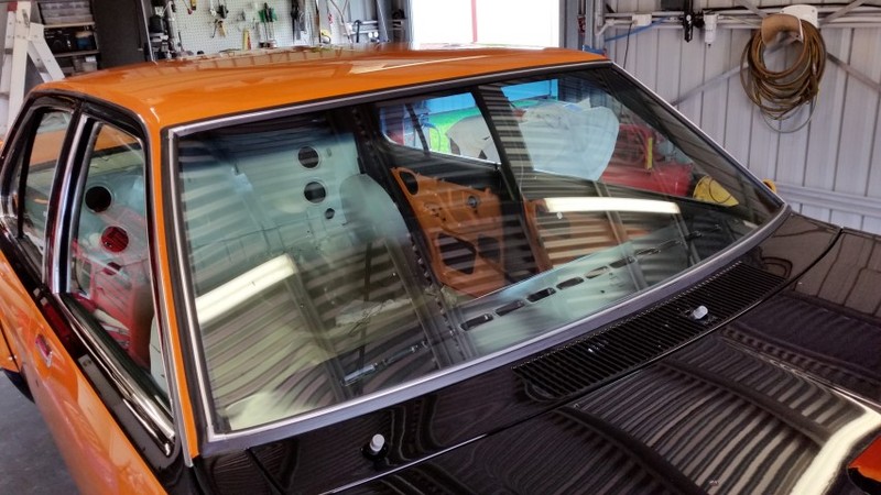

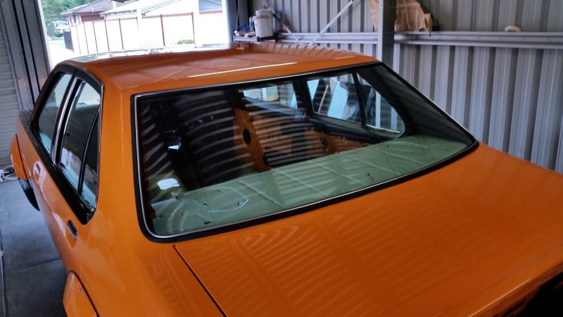

Front and rear screens are in.......mylar strip inserted with all the usual problems....but got it sorted
Thanks to Graham Price (Lx5008) for the rear screen....its perfect.

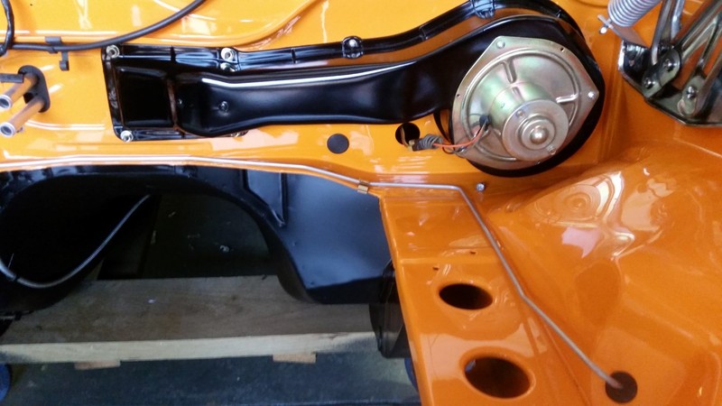

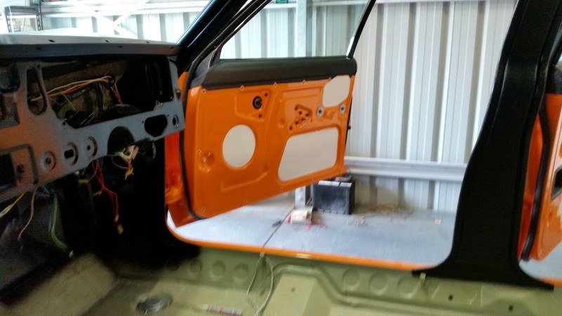

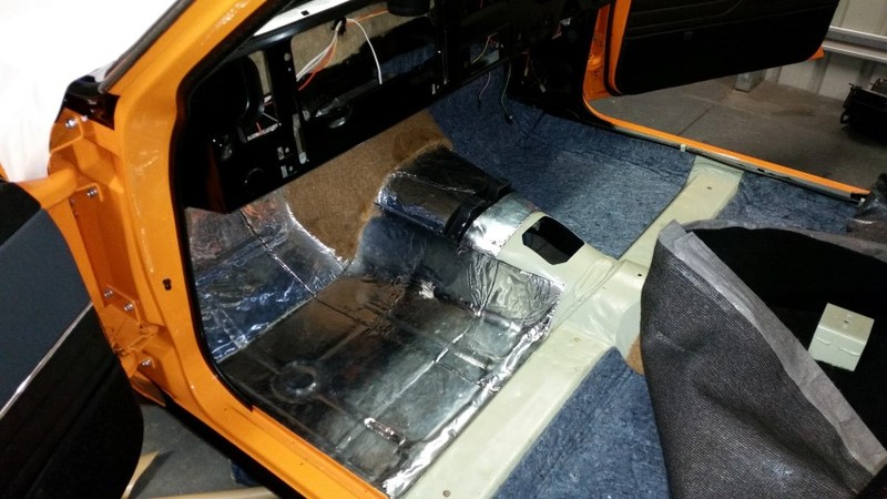

Made up some dust covers for the internal doors and sealed them up with butyl mastic

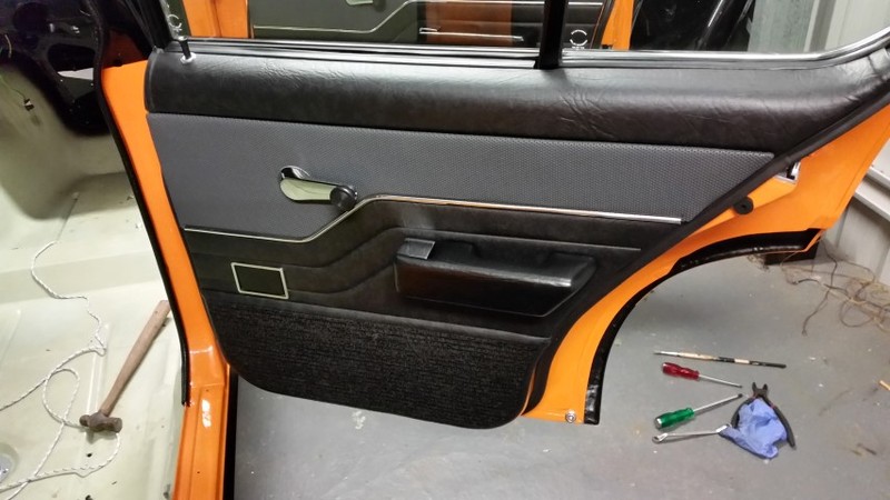

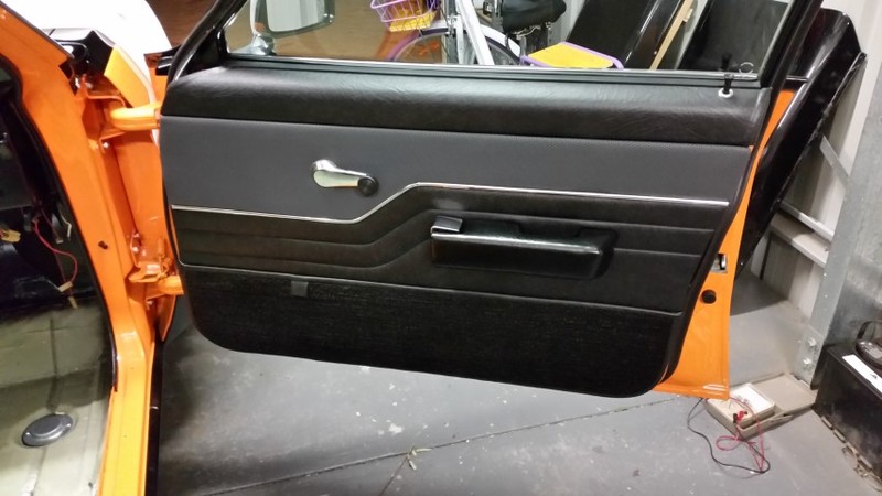

Got the door trims on
sound deadened the floor ready for carpets

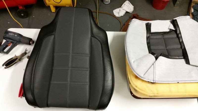

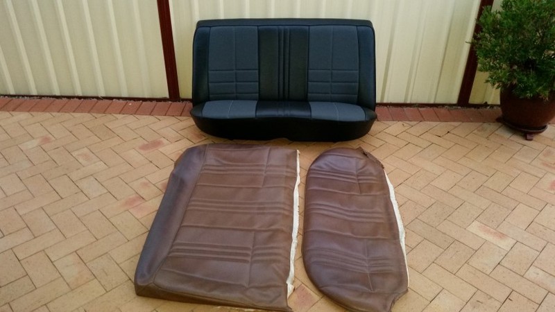

 Got started on the seat upholstery

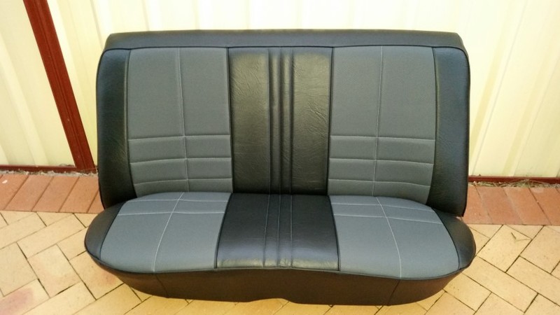

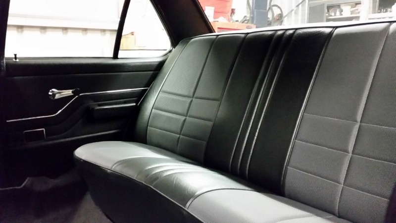

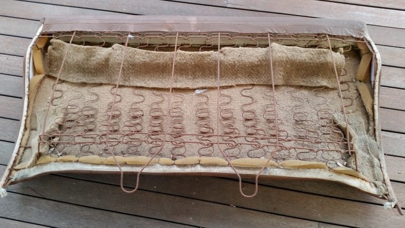

Back seat done and in the car.....Nice!!!
Started on the front seats......my seats where in pretty good shape to start with so all should go well.
Got one seat back done during the week....hitting the rest on the weekend

That's a hell of an update Al, makes mine below look a bit ordinary. Is there anything you can't do..? :-)
Everything looks perfect. What did you use on the floor there - the foil doesn't look like Dynamat? And I haven't seen anyone re-seal up the doors like that before, whats the purpose of that? I was just going to leave mine open...
I like how you made the roof lining look easy... Was it?

Hey Sam....you have to seal the doors from the inside mate to stop the splash from water drops that pass the window seal belts and to stop dust migration into the car.
They were sealed from factory......i used a similar material as original that is waterproof but most people just use plastic.
No its not Dynamat....to expensive for me......it is aluminium covered butyl mastic sheets with peel off sticky backs....pretty thick and works excellent.....I know a car sound guy and he reckons its much of a muchness....he uses this unless a customer demands Dynamat......completely took the drum effect out of the floor and Im very happy with it.
Roof lining wasnt to hard....done it by myself in about 5 hours from start to finish.......the lining was cut with a lot of extra material around the edges so stretching it to shape was relatively easy if you take your time and think about it.

I've been waiting on this with a lot of anticipation and it certainly didn't fall short of my expectations. As per the rest of this build everything once again looks immaculate. Well done Al, your car will definitely turn heads!

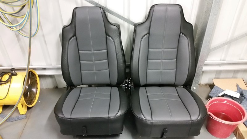

Absolutely stunning AL, who did you use for the seat covers....they fit perfectly not even a ripple

Hi Aaron....thanks for the comments.....the seat covers I bought from Auto Reproduction Trim In Melbourne but I just Googled them and they seem to be no more or they have changed their name......I bought them in 2011 and have been in storage for years.......I collect what I need for my project way in advance...project management lol

Finally finished the front seats without any problems......all went well and look good

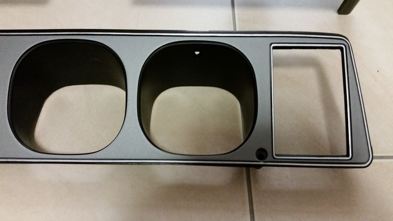

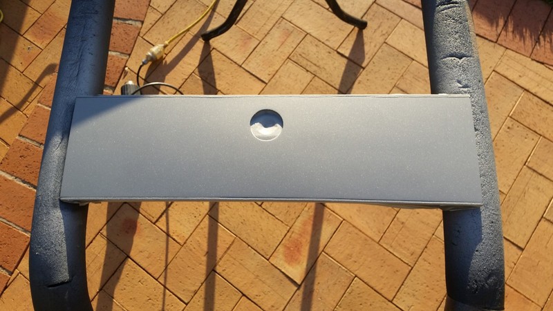

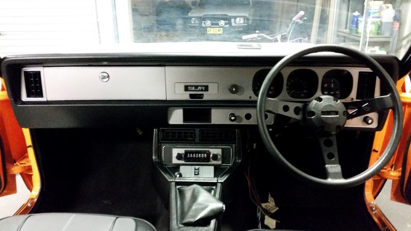

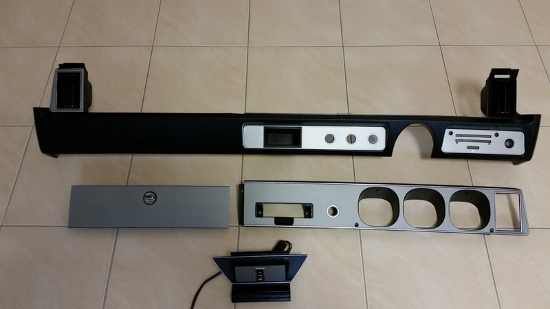

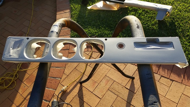

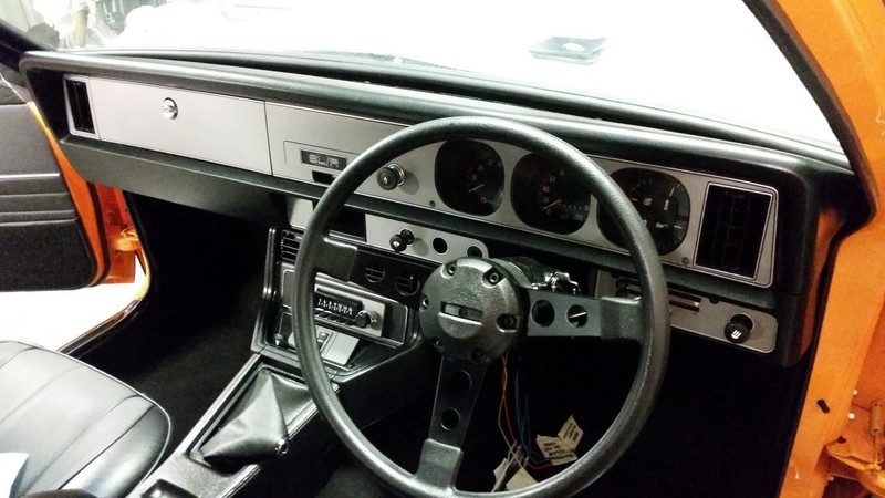

Next I started on recoing the dash facia......was wood grain so I changed it to portland grey.
Taping it up was a bit of a pain but worked out well
Done the silver edging with a paint pen.....happy but what a tedious job
Sprayed the rest of the facia panels with 2k satin black and all looks very nice.

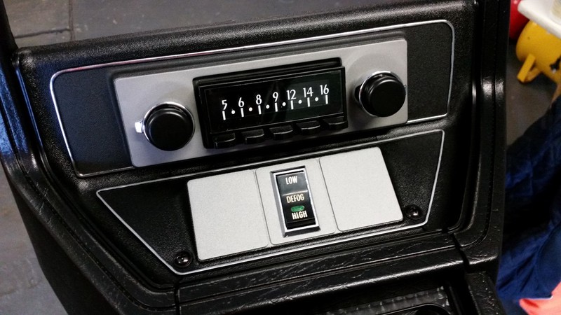

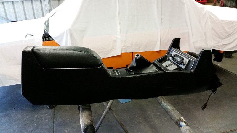

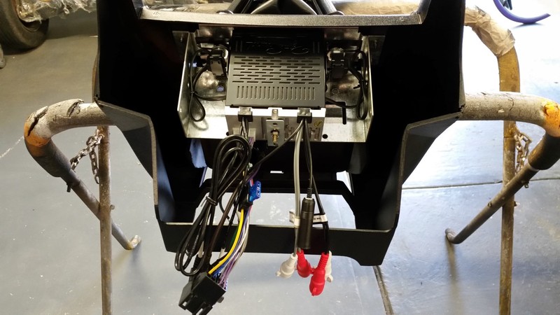

Ok with all that done it was time to hit the center console....same treatment as above
Installed my new Retro Sound Stereo......nice fit into original position and used original radio bracket as well....perfect
Ok all installed and looking smick....everything lined up well and colour match was very good.

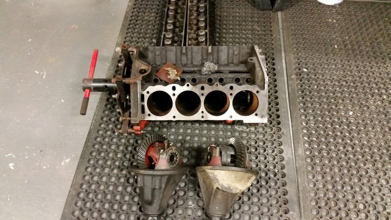

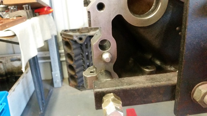

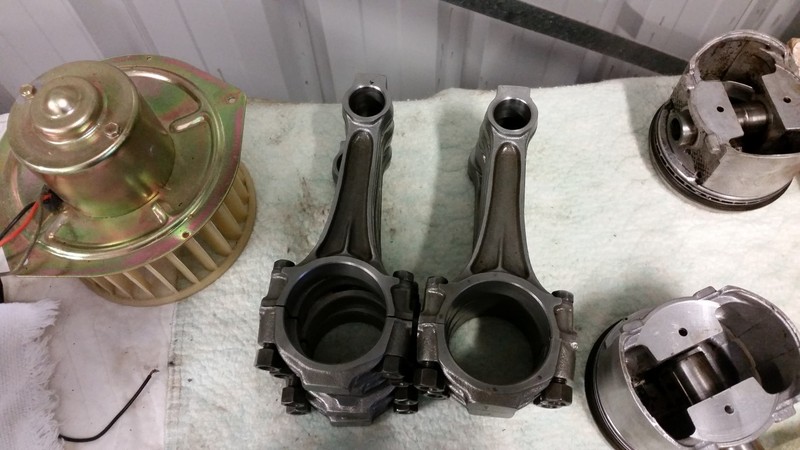

Currently working on the engine and driveline so it was time to drag all the bits out and see what what Ive got.

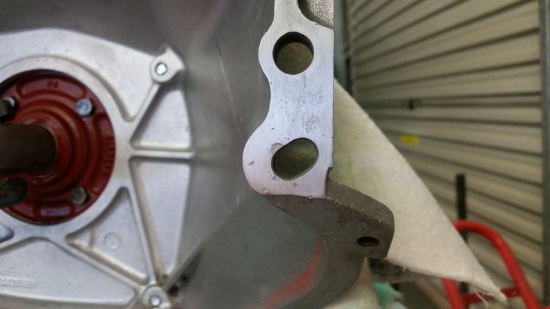

The block in the pic was no good as it has a crack across the back of the gearbox mounting face near the alignment dowels.

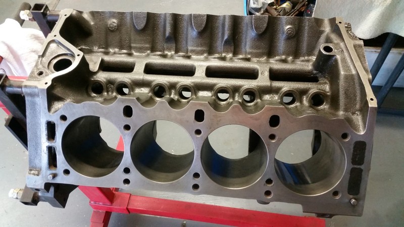

Scrapped it and bought a 304 VN block in perfect virgin condition. No pic of this yet

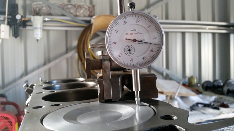

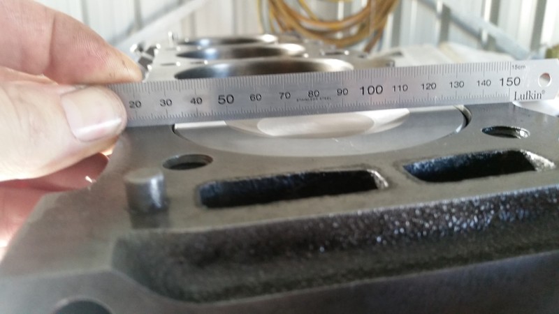

Checking out the compression height of the original pistons in the VN block.....a lot of info on here suggested that on a VN 5.0L the pistons are at deck height....well I can assure you that this is not correct....if you read the dial indicator backwards from zero you will see that the pistons are 0.85mm below deck or 33 thou......this engine has never been disassembled.
So plenty to play with if I up the compression a bit.
Pressed out the gudgeon pins from the A9L rods and all looks good ready for a bore and rebuild.

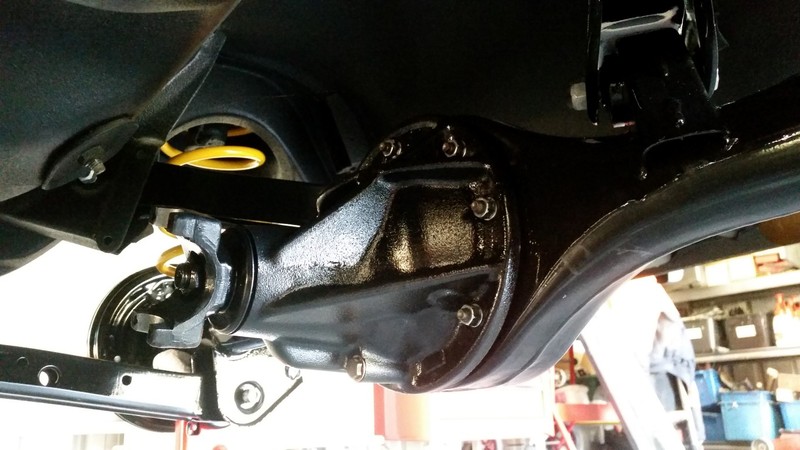

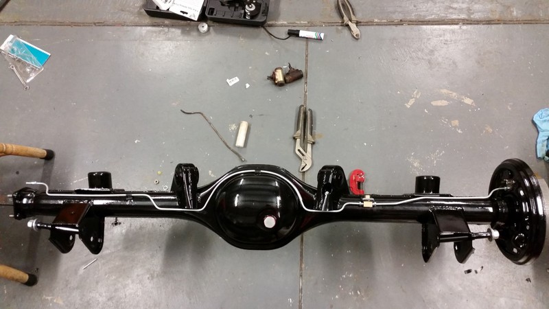

So I decided to reco the diff and brakes on the rear.

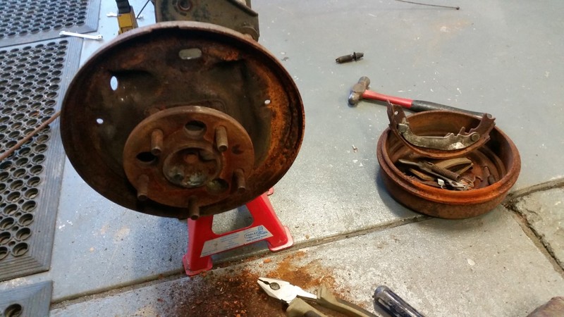

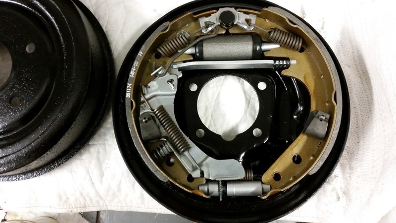

What a night mare trying to get the rusted drums off the diff.....adjustment star wheels where corroded and locked solid so the only alternative was the hammer and this is what I found....mmmmm
Sand blasted and soaked every thing in phosphoric acid for a bit to remove all rust.
Gave them a paint and all looks fine.

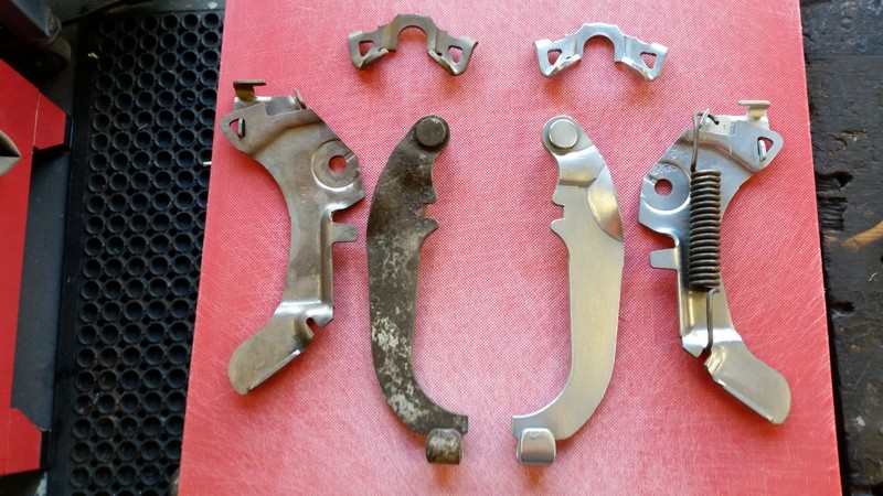

The brake drum internals where equally corroded and look bad.....saved what I could by Zinc plating all the parts in my home made Zinc plating rig.
This is the result
A big thanks to Kirk (forum member) for sending me the extra bits I needed like springs and adjustment wheels.
It all cleaned up nice and here is the finished drum set up
Cleaned up the diff housing and gave it a coat of paint.

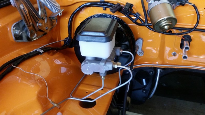

Made up new brake lines yesterday evening and installed them ready to be put back under the car in the near future.

Ahhh. Satisfying update again - and that's for me, I can't imagine how it must feel for you Al! :-)
Top work. You make the car seat covers look easy, pretty sure they ain't!

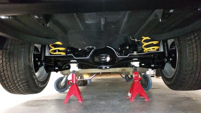

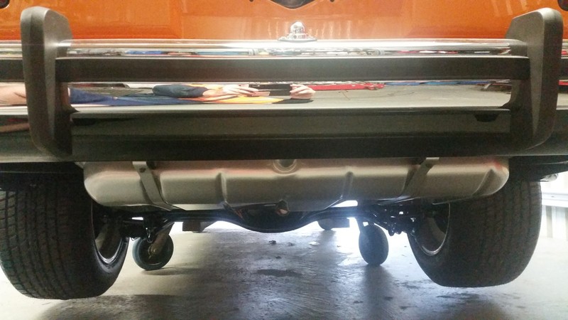

Ok got he diff finished and in the car...new brake lines, new brakes, new bearings, diff center rebuilt, new shocks, sway bar and lowered springs.

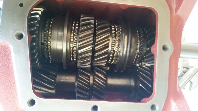

Now thats done its time for the old aussie box to come back to life.
New M21 parts arrived
Started with this
finished up with this
New input shaft, new third gear, new cluster, new syncro's and a full bearing and seal kit....tricky job but fun
Sneek peek

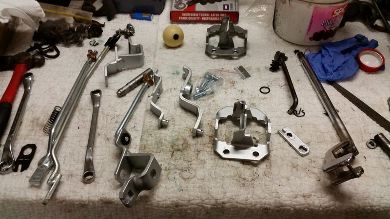

Got all my shifter bits out and reconstructed a new one....new shim and rebuild kit and all was very good

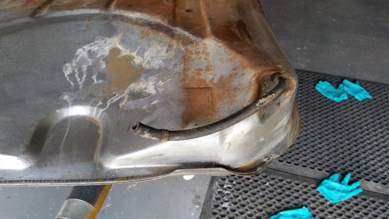

Moving onto the Rusty's old fuel tank...sad...

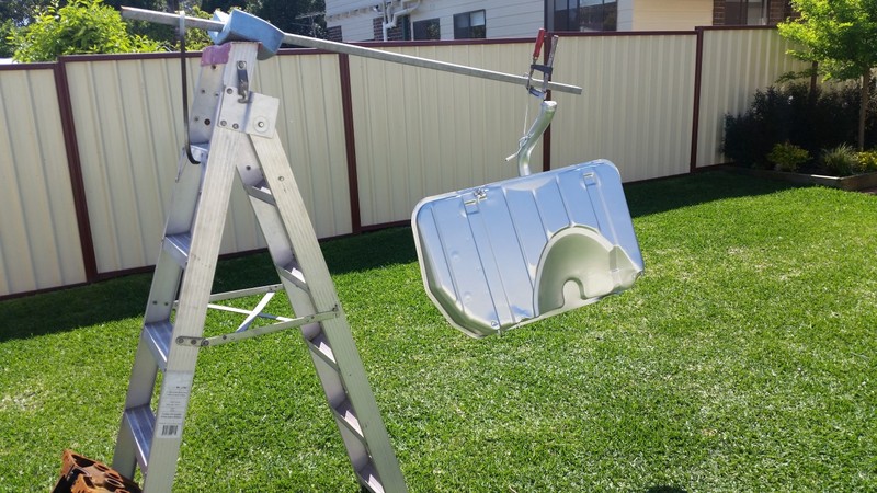

But came up beautiful with a bit of effort and a 2k paint job
Tank in and plumbed

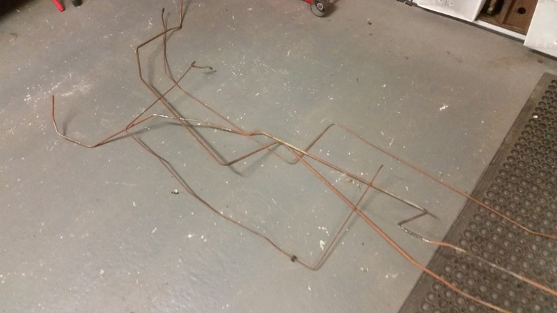

Spaghetti time...bundi tube is a real pain

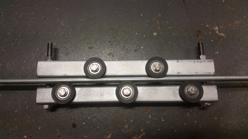

But managed to solve the straightening problem by building a tube straightener out of sliding door rollers
Managed to plumb it all back to original

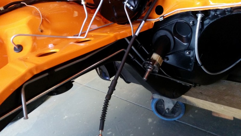

Going to make a new right front brake line...not happy with the shape of this one....not quite tight enough i think

Slipped the bellhousing on and was a perfect fit and alignment.
Ok I know what your all going to say...I have to re drill the block to suit the aussie pattern bell housing.
Well I did re drill the blank top 2 holes but after careful consideration I decide to elongate the bell housing holes as there is plenty of meat to do this and doesn't seem to be a problem. I researched this and found quite a few people have done it this way without issue....guess time will tell.
I will also have to elongate my clutch pivot bracket however seems to be no problem there either...what do ya's think.
Ok that's it for now
Al
