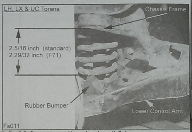

Even with the std A9X springs the bottom A9X LCA's are still level ,as are UC's with the appropriate steering arms correcting for the stub axles used (bump steer).
The L34 and A9X were fitted with F71 heavy duty spring package as standard. The F71 heavy duty spring package was available as an option on the standard Torana.
The F71 spring increased the clearance between the bump stop and k-frame at ride height by 15 mm  from 59 mm to 74 mm. The actual ride height would increase by more than 15 mm due to the location of the bump stop.
If the LCA is level on a UC with standard springs then it cannot be level with A9X springs. If the UCA pivot position is optimal with standard springs then it would need to be lowered for F71 springs.

According to the service manual replacing the standard springs with F71 springs will raise the suspension ride height increasing the gap between the bump stop and k-frame by 15 mm.
If you alter the suspension ride height then obviously you change the angle of the LCA. The LCA cannot be at the same angle on a car fitted F71 springs and the same car fitted with the lower standard springs. Whatever the angle of the LCA is on a A9X the angle of the LCA on a V8 Torana that weighs the same with standard springs will be different.
If you alter the suspension ride height then you may need to revise the whole suspension design, at a minimum you would look at moving the UCA pivot point.

Those numbers are dubious - what torrie config do they apply to? The heavy duty F71 front springs (P/N 9931027) are used in the 4cyd, 6cyl and 8cyl auto/manual/AC.
They must be pretty magical springs if the "working load height" (hence bump stop gap) is the same regardless of the powertrain aircond configuration? Its also worthy of note that the regular springs without aircond in 4, 6 and 8 are all different numbers with some being optional for aircond fitted. Yet according to this they are all 2" 5/16?
To say that F71 in a 4cyd with A/C will retain the same loaded height as an A9X with its 308 is not logical.
I would say its either not accurate, BS numbers or some just sort of guesswork.
I don't have my GM service manual here what page is it on? (I am a bit slow - I just worked it out "being a photo" its from an aftermarket manual)

The picture above looks like it comes from an Ellery manual so I wouldn't put too much faith in it either. However the basic premise that the heavier spring pushes the lower control arm further down has to be correct, as the cross member doesn't move. It also needs to bring the stub axle down to cater for the drop stub effect if the car is to remain at the same height as with a Torana stub.
That makes logical sense to me.
