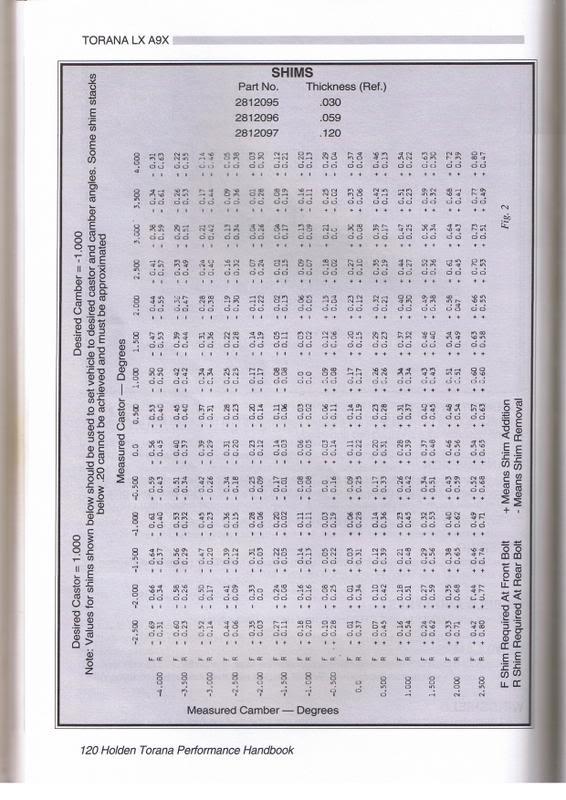

To reduce the camber by 1.5 degrees requires 0.25" shims to be removed so the H series stub axle will have 0.25" less shims than the LX stub axle to achieve the same camber setting. If you have 0.25" less shims then UCA and therefore the top ball joint is 0.25" further to the left when looking at the drivers side from the front.
I believe the factory camber for the LX was -0.5 +/- 1.0 and the factory camber for the A9X was -1.0 +/- 0.5 so when aligned to factory specs LX -0.5 and A9X -1.0 the difference in terms of shim stacks would be 1 degree which is 0.17". However the maximum camber for both is -1.5 so when both are set to factory spec maximum camber we are back to 1.5 degrees difference and 0.25" of shims.
Shim chart posted by JBM in this thread.

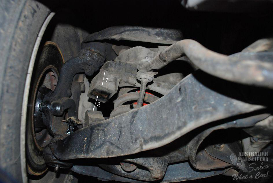

Factory geometry. This should clear up that with the standard A9X springs the lwr control arms sit flat with road weight. Note that steering arms at tie rod mount (when static straight) are at level with bottom of stub axle.
The other photo is just for comparison. It is a dead stock unmolested LX sunbird at stock ride height.
The difference is in the firmness and rate of the springs, it has nothing to do with the A9X being jacked up by taller springs. I am sure if you put the  F71's in the sunbird it might sit 15mm higher as it has significantly less weight over the front, but the 308, a bigger gearbox, radiator etc negate that when fitted in the A9X. My bet is that manual has just taken free height as ride height and thrown in a caption on the photo indicating the difference. It's false info anyhow. The F71's are a much stronger spring.

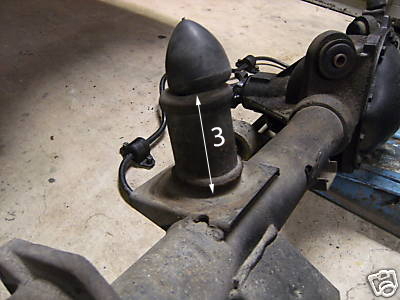

How tall are the front and rear the bump stop extensions on the A9X?
If the compression travel on the front and rear suspension of the A9X has been reduced by the same amount then that would basically confirm that suspension ride height on the A9X is the same as a V8 Torana and that the A9X just has considerably less compression travel.

One day when you have the time these are the three measurements I would like to see.
