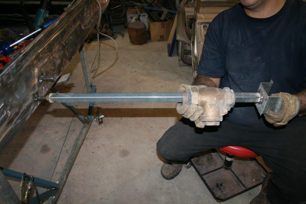

Posted 08 September 2013 - 08:55 AM

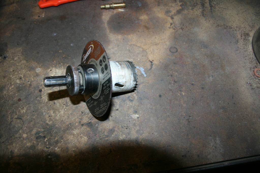

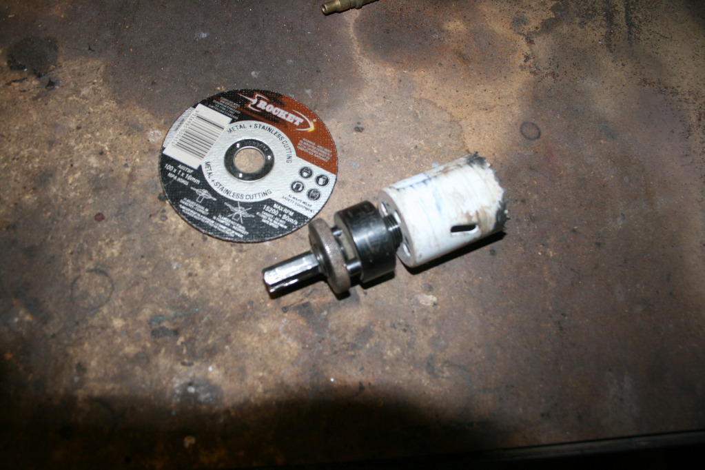

This is one of my many tricks i have used many times you get a hole saw and arbor and put a 100mm grinding disc on the arbor and use this set up on a drill to cut pipes internally. Probably more useful for plumbers ,Thought i would share it any way.

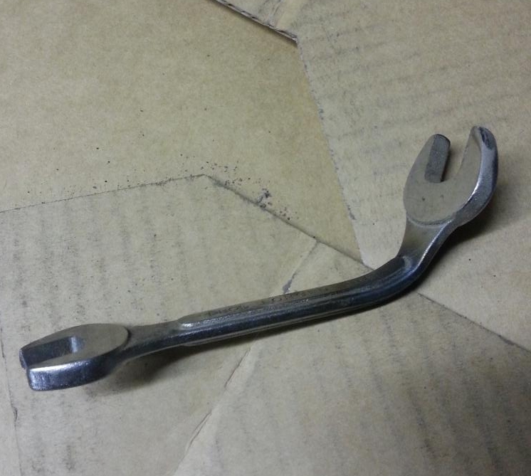

if any one owns a 253 or a 308 with a trimatic transmission in a torana with a vc commodore electronic ignition you have three problems against you trying to tighten the distributor lock down bolt.
  • The fire wall ,
  • The large distributor cap
  •  The transmission dip stick tube.
  • This is my solution to tighten the bolt. I bent an open ended spanner with the oxy and now have access to tighten the bolt

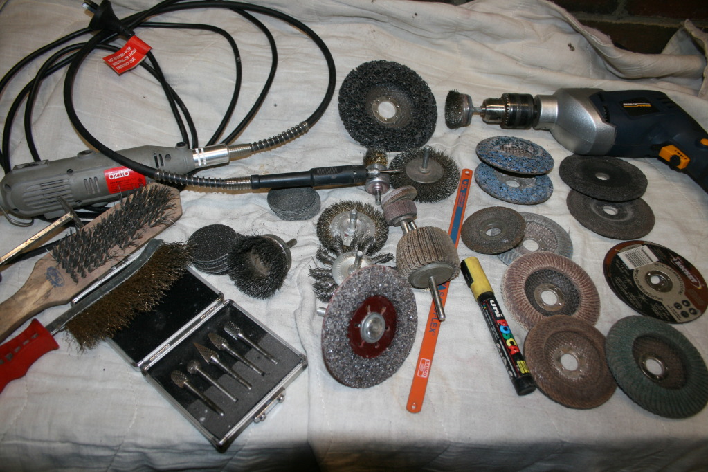

This is my paint surface rust and rust removal kit.It comes in extremely handy.
