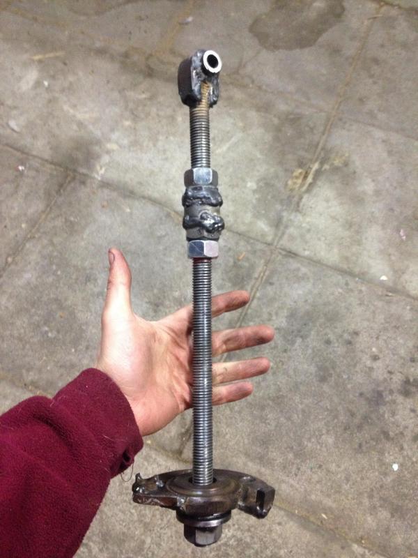

Hey Mick That lot looks exactly same as mine even down to those die grinder bits being chewed a little around spline from being in a drill chuck, They also don't work quite as good due to lack of rpm's, But still get the job done when the air compressor wont feed a die grinder or such...... Here's a couple of recent tools I knocked up 1 is rear calliper piston adjusting tool, & other being good ole spring compressor...

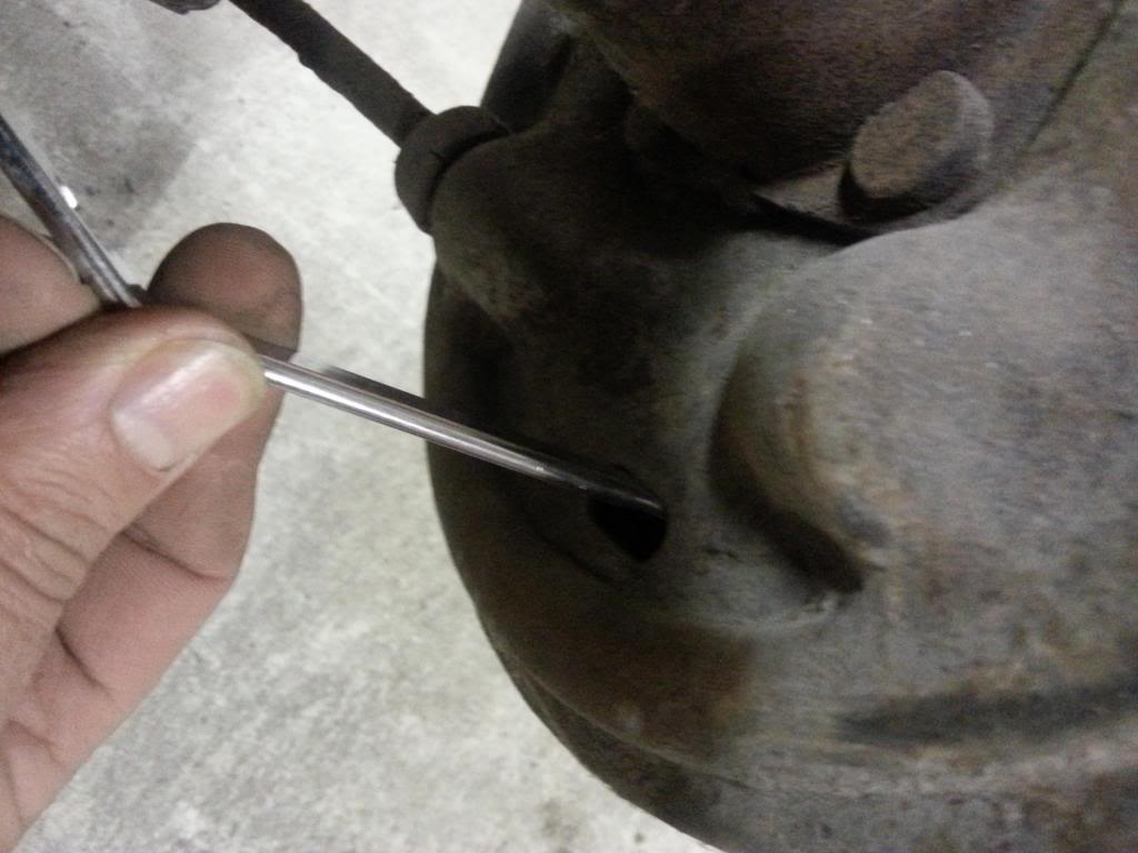

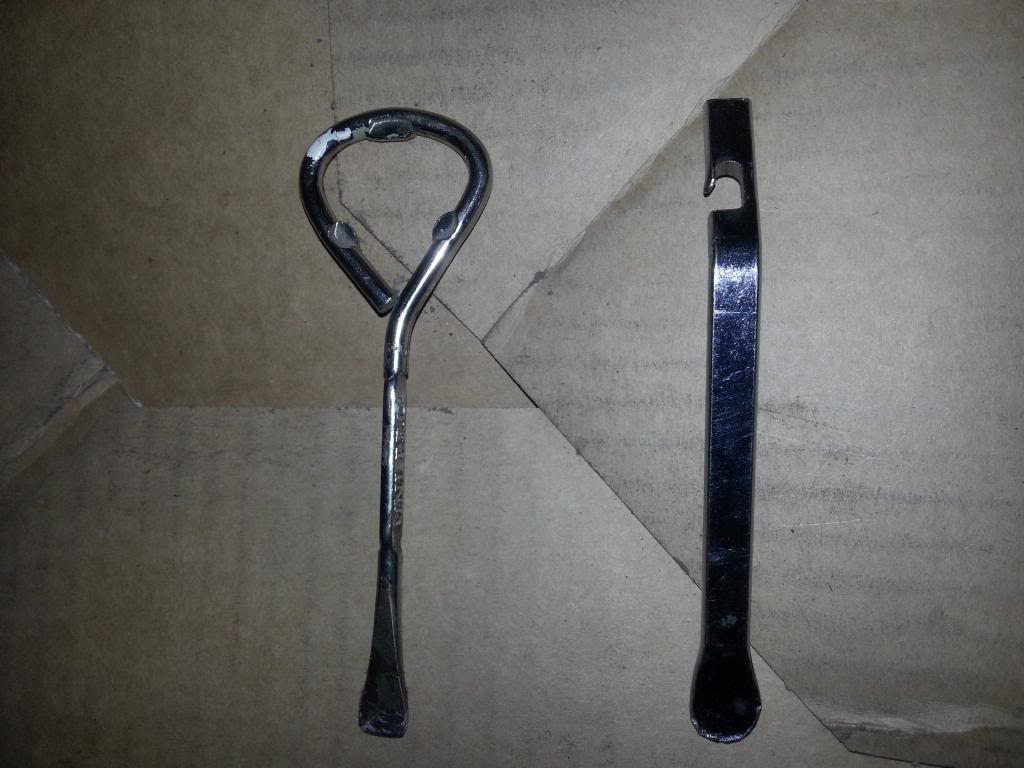

A couple of Diy,s or improvizing. I found it hard years ago to adjust the drum brakes on my early holden with a screw driver.I came across my push bike tyre remover in my tool box and thought this might work gave it a try and Presto it works excellent also a paint tin opener from Bunnings works great as well.

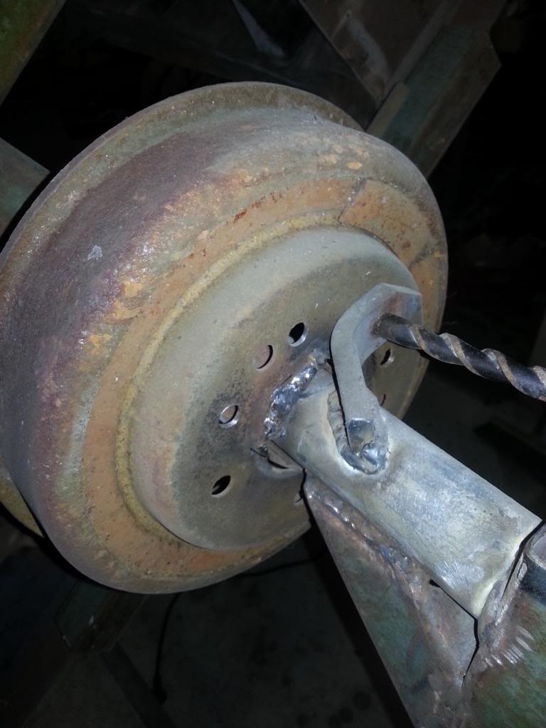

This is part of my home built rottiserie. Its and old brake drum with holes drilled in it.The holes are drilled at all the positions i need to work on the car i have used a high tensile drill bit shaft as the pin so it can not sheer
the pin easy its crude but it works. And the rotisserie was the best thing i ever built.

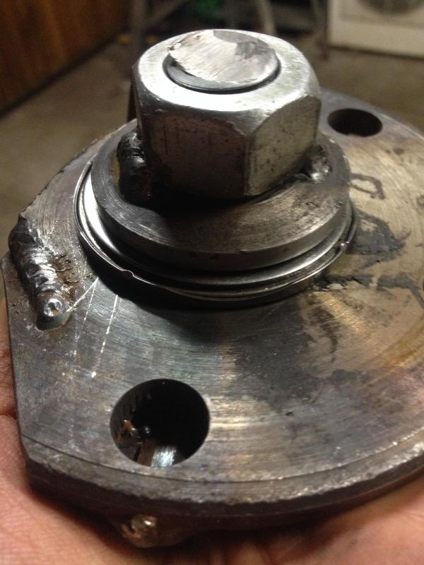

#35 wot179
Posted 24 April 2014 - 10:23 PM
Great little tool Wot but you'd have to have plenty of faith in your welding skills.
What have you got in the plug holes?
Just busted off sparkplugs. I snapped them off so I could wirebrush the block before I painted it to keep junk out of the bores.
#36 Potta
Posted 25 April 2014 - 02:14 AM
Good idea!
Does that count as another set of tools you've made?

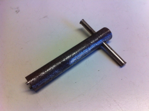

After being prompted by Potta I herby release the patent on my wiper switch nut tool for LJ.
Using an old tube spanner or piece of metal tube that fits. Mark out a 2mm square raised section on opposite sides. Cut out the other section with hacksaw to leave something that looks similar to my picture. File off rough edges and test, adjust where necessary.
Too easy.

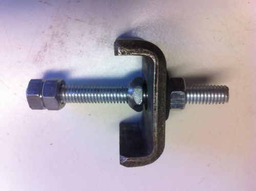

here is a tool I made like the one in the manual for installing Rares LJ rear spring insulators

Andrew that spring compressor is nice. Like mine. Is that tape to stop the all thread from twisting out of it's joint?
Machined bottom to accept a bearing which made turning much easier. Still a long and painful proccess. And it chipped my powdercoat :(
