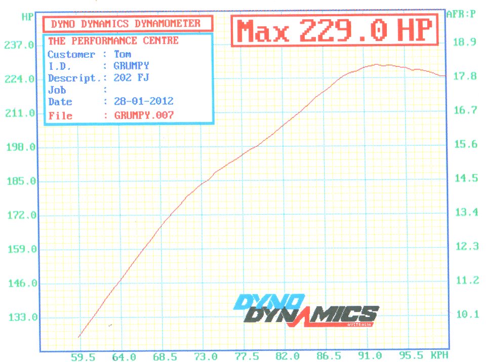

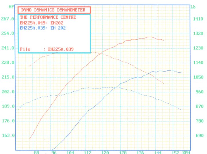

Thought i should add my 2 cent's.
This is a 12 port engine i did, YT alloy 12 port with welded chamber's and weber's.
395350_10150837090288438_1524550824_n_zp
And my 9 port engine, 2 inch su's.
Red line is methanol and the blue line is pump fuel.
267394_10150397755948438_1295124_n_zpsae

2 cents noted Kev, they're some good power runs.
