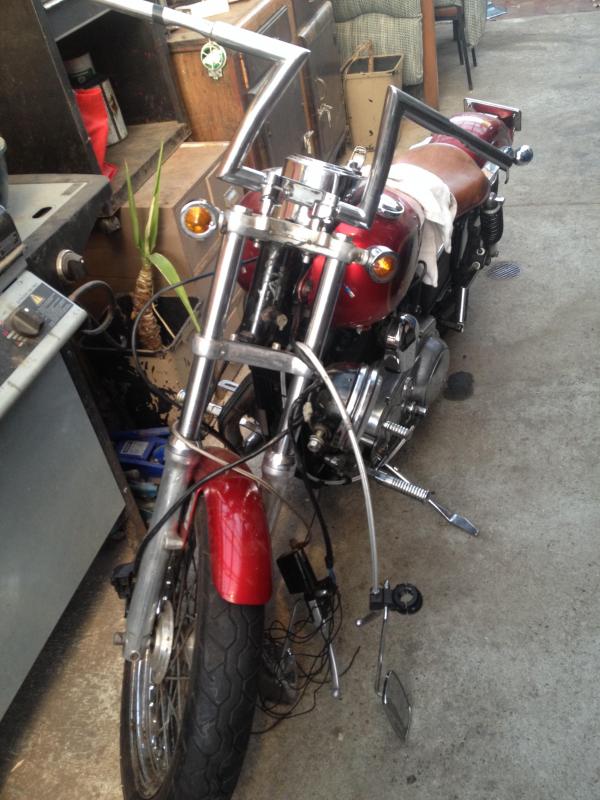

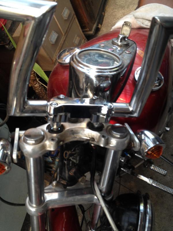

Anyway slapped it all together quickly this is how it came out. Still not 100% sure i liked it but it will have to stay this way for now. Ideally i'd like to finish lowering it but it will need some spacers made up, for which i have obtained some 25mm solid alloy bar. Only problem is i dont know how to cut it so it is perfectly square. This stuff melts with cut off discs, any ideas?
