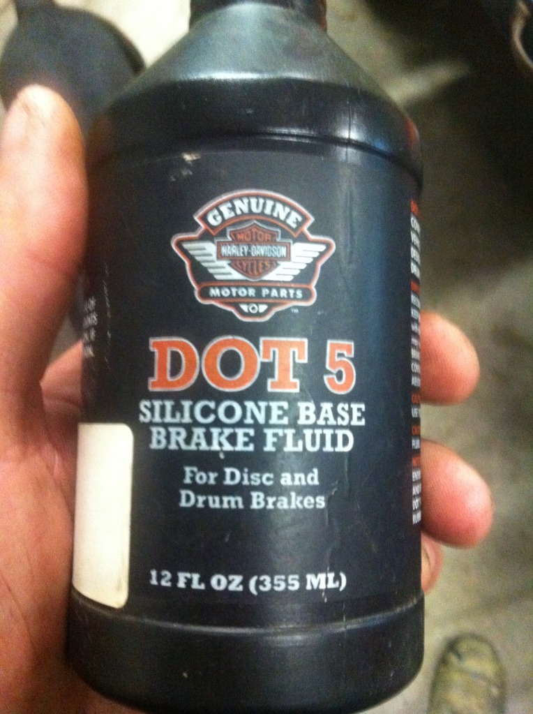

Yeah you can take the top of the reservoir and cable tie the lever, it just may take a bit of time.. my break lever was OK, but had a little bit of a soft lever pull, I removed the front wheel to change wheel bearings ... when I pulled the Calipers off, I pushed the pistons back as far as they would go (to make it easier to fit the wheel back in) this pushed the little bit of air out that was giving me a soft lever... now my brakes are awesome, the lever is very firm, and only travels about an 25mm, instead of coming 3/4 of the way to the handle bar.. you could also try this, just BE CAREFUL that the brake fluid does pore out of your reservoir when you do this...... I hope this link works... BikeBiz brake fluid prices... cheers mate http://motor.bikebiz...t 4 brake fluid
Ok thats great ill give it a go thanks for the advice. Failing that ill give it a bleed i suppose, cheers.
Whats 12oz, is that 500ml? You know what's funny, when the bloke told me $50 something, i said "oh is that genuine", to which he replied "theres no such thing as genuine brake fluid", i was like oh ok feeling like an idiot.... Obviously not. Ill try make it to a harley dealer and get some. Also found some 5.1 but lucky i researched it as it's glycol based and could have been a bad ending.
Jeff, yes crazy mark up, but that is also 5.1 which is not the same as synthetic dot 5

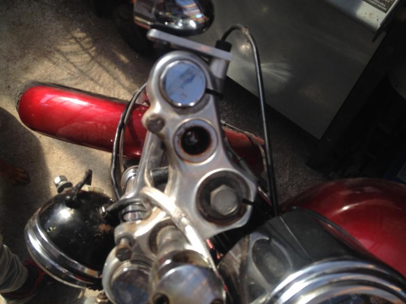

Does the reservoir need to be parallel to the ground?
Posted 09 February 2014 - 07:43 PM
Nope. I'd avoid any extreme angles, but i've never had an issue having it not parrallell.
The reason you got air in the system is you must have put the res upside down.
THeres an air pocket in the top of the res near under the lid, and a feed hole into the master down the bottom...Obviously. If you invert it then put it lower than another part of the braking system then of course your going to get air in the line.
But yeah, every bike i've ever had i've spun the grips and the like around to fit me. No real reason it wouldnt work even on like a 45, you would just need to watch your fluid level....
Posted 09 February 2014 - 07:48 PM
Yeah i suppose as long as the feed has fluid supply shouldn't matter the angle. Yeah res was upside down it will need a bleed cable tie on the handle didnt work.
Posted 09 February 2014 - 07:51 PM
Bike brakes are bitches of things.
With the res top off, if you just pull the handle a little bit, say 10mm or so, do you get bubbles come up from the bottom or a squirt of fluid?
I've found with my Harley you have to bleed from both top and bottom, just pull the lever a tiny bit untill bubbles stop coming out of the top then start on the bottom, sometimes leving it overnight helps to, you might still be lucky.....

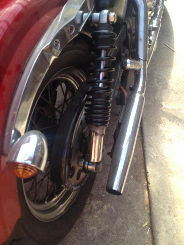

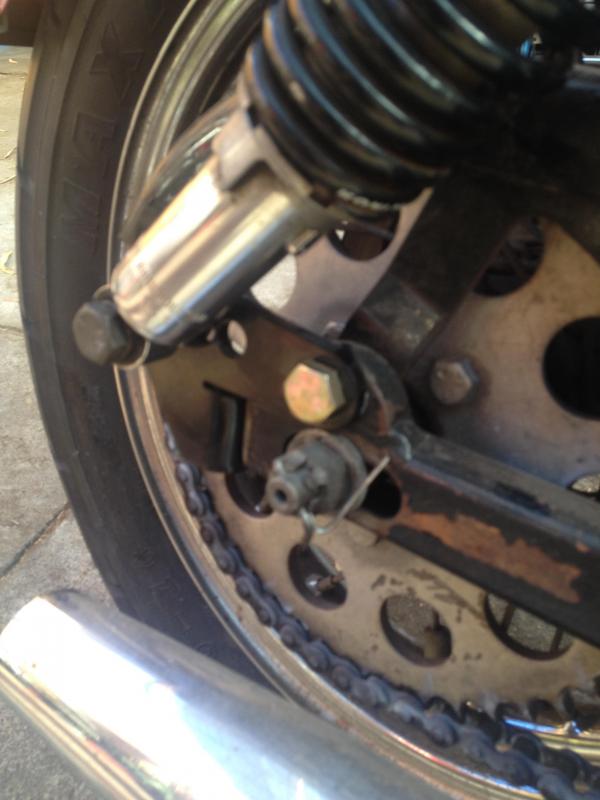

Anyway somehow got some motivation to do a full front end polish. I couldnt bare to look at it next to my shiny new chrome risers and clamp. Also finished lowering it, and wow does it look good. Pitty i cant fit my hand under the guard anymore lol. Only problem is the chain tightened up heaps. Does anyone know the factory specs for play in the chain (deflection)?

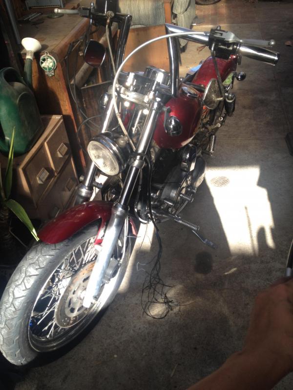

Tomorrow i will be polishing the alloy on the motor, primary case and any other flat pieces of alloy i can find. Still not sure if these mirrors should go under or above the bars, opinions?
Edited by judgelj, 10 February 2014 - 10:05 PM.
Posted 10 February 2014 - 10:24 PM
Over.
With high mirrors you get to look in them and see your nice big broad shoulders.
With low mirrors you get to look in them and see your nice big broad gut....
I prefer over ![]()

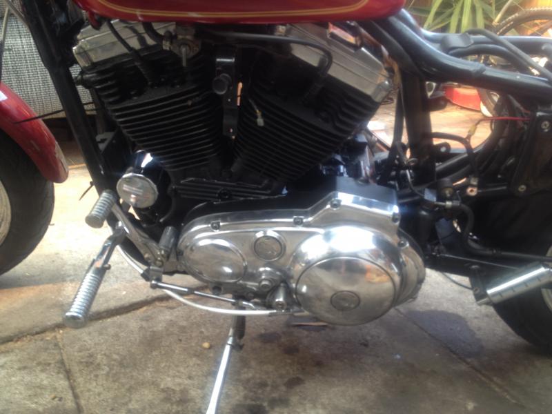

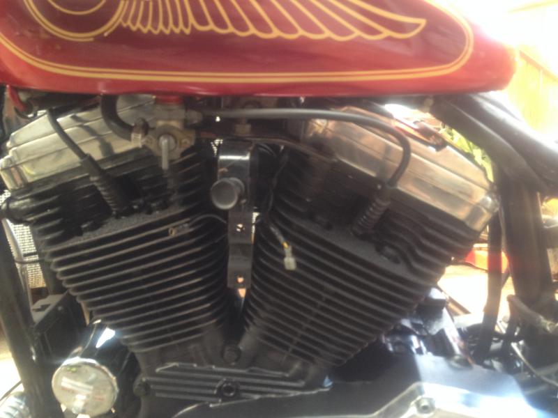

So spent three days and about 36+ hours polishing, wiring, fixing, cleaning and painting. This is the result, makes me a bit less reluctant to sell and buy a bigger one haha.
