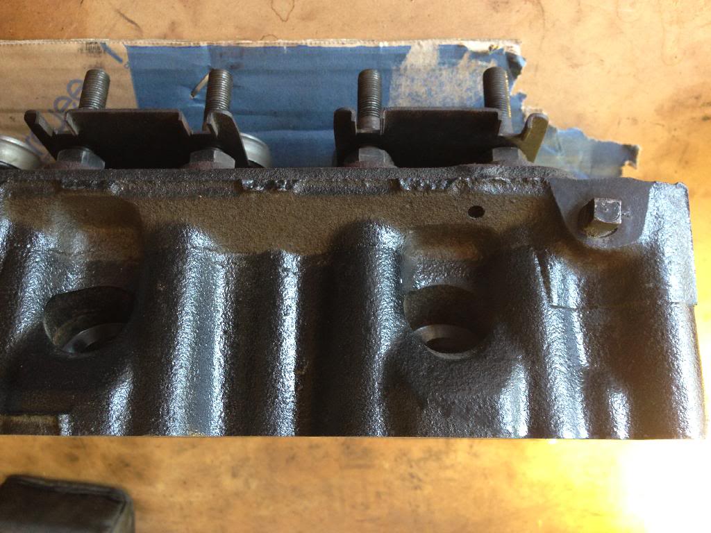

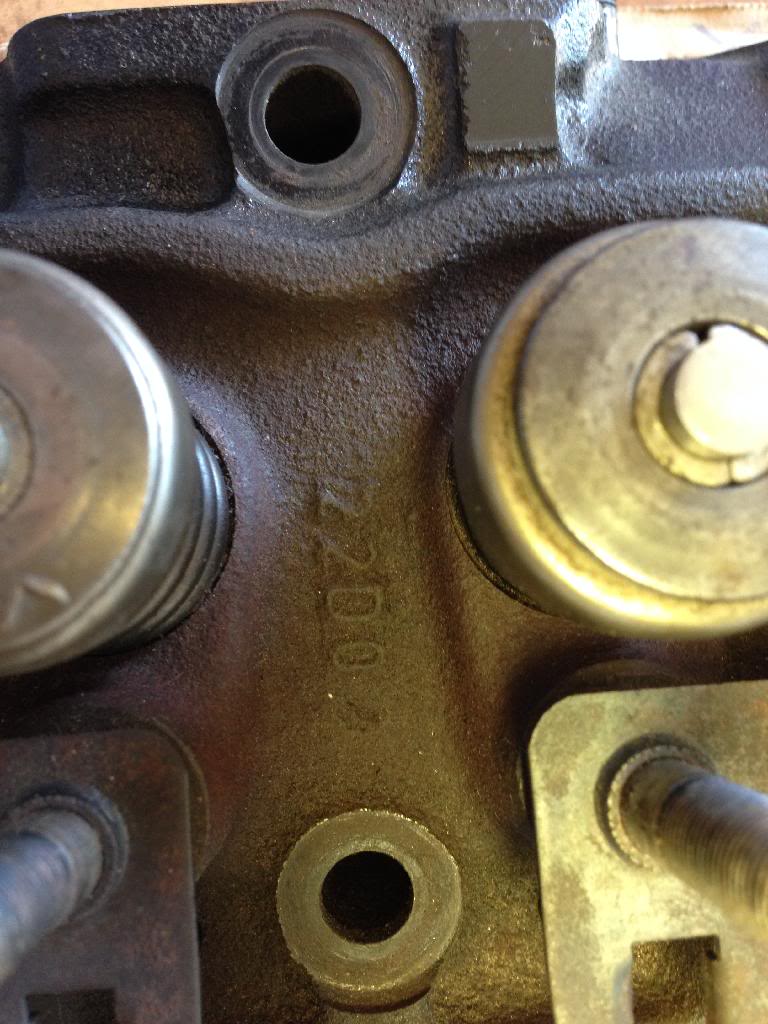

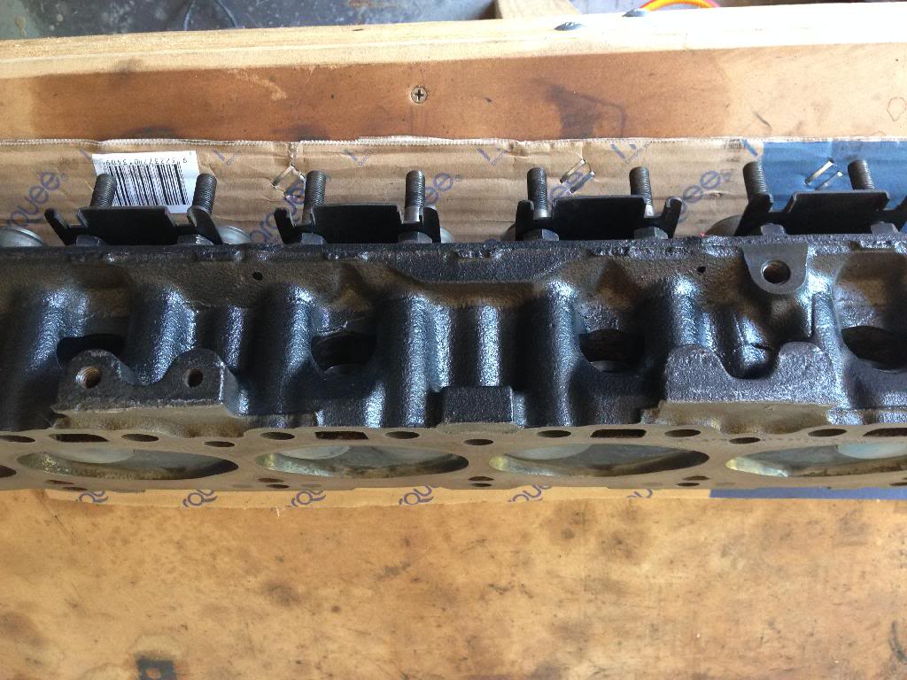

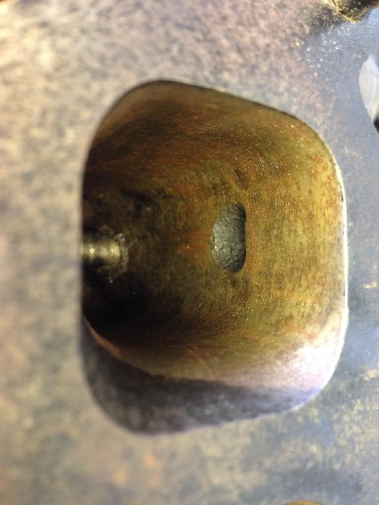

i had a better look at my head, it has the date code 22D0, is that 1980? early blue head? it doesn't have and mounting holes on the front right for the air con or power steer or whatever went there. it also appears to have the lump in the port ground down(i had not seen how far that lump actually sticks out into the port before seeing the pics in this thread. i assumed the dimple left in my port was how the undrilled heads were)
here are some pics for future reference
DD34E796-F955-49D8-9A9D-D59806D258D1_zps
136FE4F4-2729-4322-880F-51A144C4151E_zps
2D697D42-B699-46F3-82D0-54089862B214_zps
AE629CA1-374B-4E91-BE9F-908BC760732F_zps
#78 S pack
Posted 29 December 2013 - 04:20 PM
22D0 would have to be 22nd April 1980 cast date.
