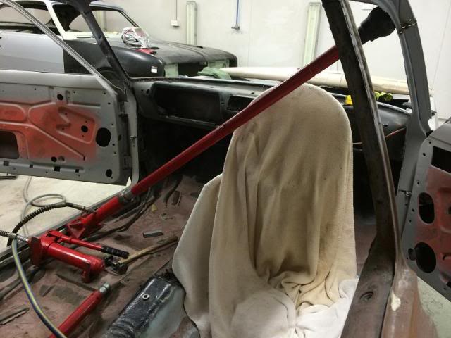

So decided to put some decent welds on the B and C pillars as I was happy with where they were and then use the port-a-power to adjust the front pillars slightly (talking a few mm)
Thats where I am up to at the moment, Will clean back all the welds, then adjust the front until im happy... tripple check everything measures up nicely, start welding in the outer layers then Lead wipe the factory joins.

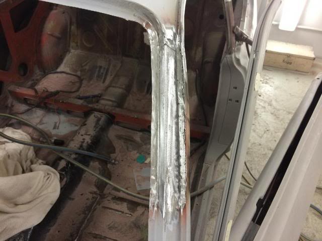

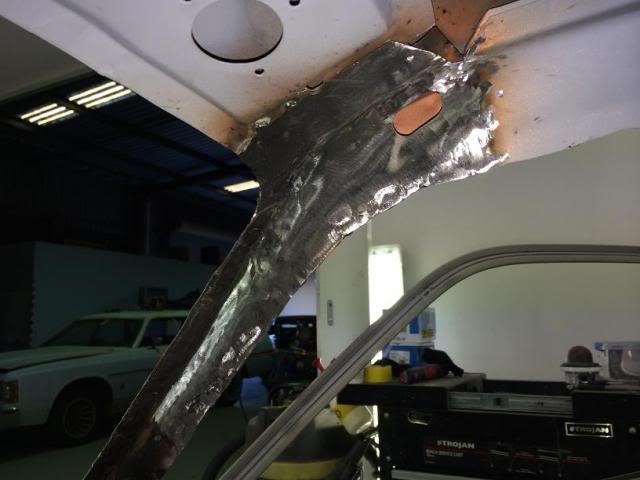

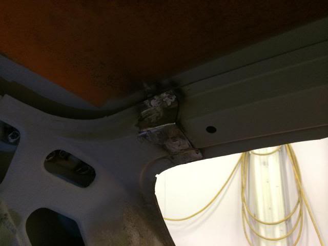

Plug welded the rear inner roof brace to the C-pillars:
Had to make a slight adjustment to the front window frame as it was out of square and had to move it over towards the drivers side 3mm
Not having much experience with LC/LJ's myself, today I noticed their dashes are almost identical left to right... were these cars ever offered in left hand drive countries?

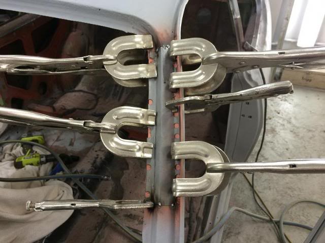

Anyway now I was happy with where the A-pillars were I fully welded the first join, cleaned up the welds a little and sprayed the insides with weld through primer (this stuff smells so good!)

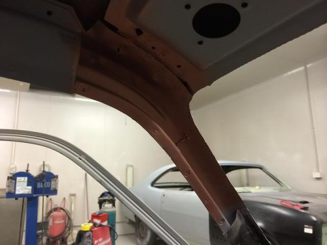

The inner A-piller section was sandblasted, the back side sprayed with the same weld through primer and put in place.... Can never have enough clamps ;)
Weld weld weld, grind grind grind... still abit more grinding to do but ran out of time.

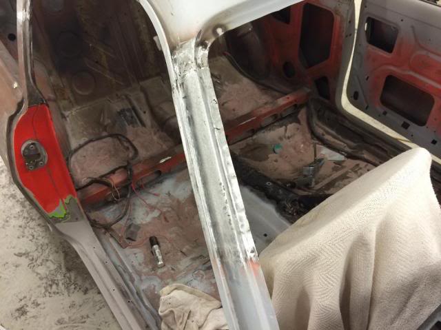

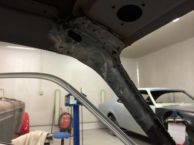

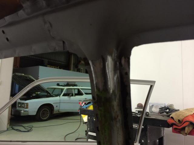

Back to the Torana, Did the same on the inside of the Drivers side A-piller:
1DriversApillerinternalwelded_zpse10ec67

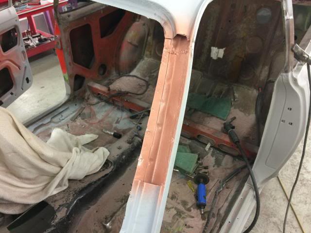

Next was the outer section of the passenger side A pillar
2passengerouterApillerweldthru_zps8e5596
3passengerouterApillerclamped_zps505816e
4passengerouterApillerground_zps17d21f07

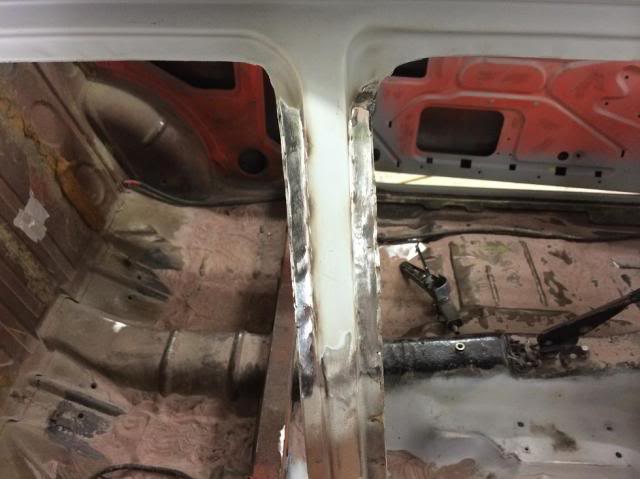

Finished off the B-pillers up to this stage:

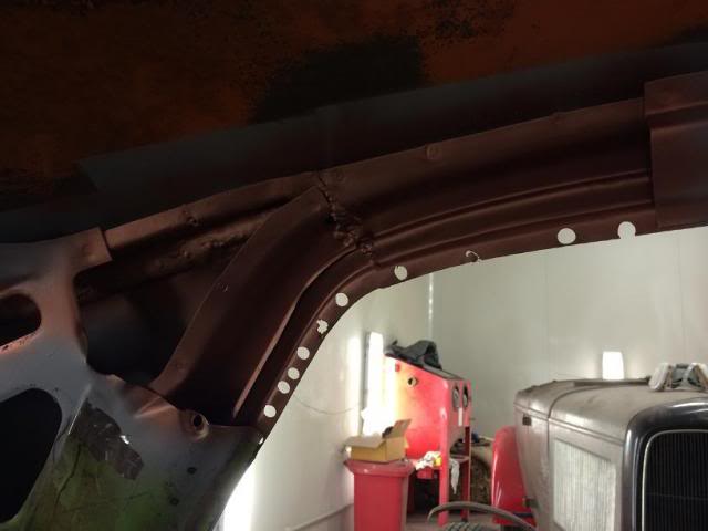

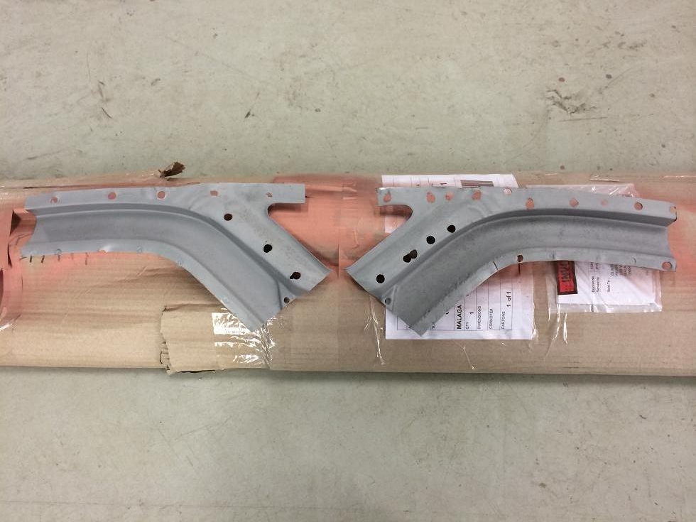

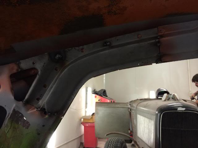

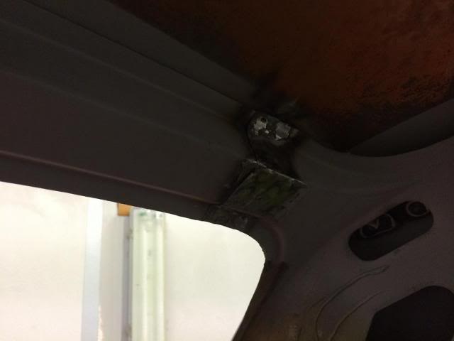

Next what the Inner C-pillar sections, they were blasted and sprayed with weld through primer on the inside:
Ditto on the C piller
Then tacked in place... and thats where Im up to atm... Will fully weld this, same for the drivers side. The 2 gutter sections on the C-piller need re-instating then all these sections will get sandblasted and sprayed in epoxy.
