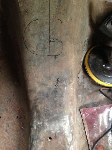

Last but not least was the tunner, at some stage had been modified so suit a different gearbox, That silver rectangle is a piece of alloy stuck over a hole with sikaflex

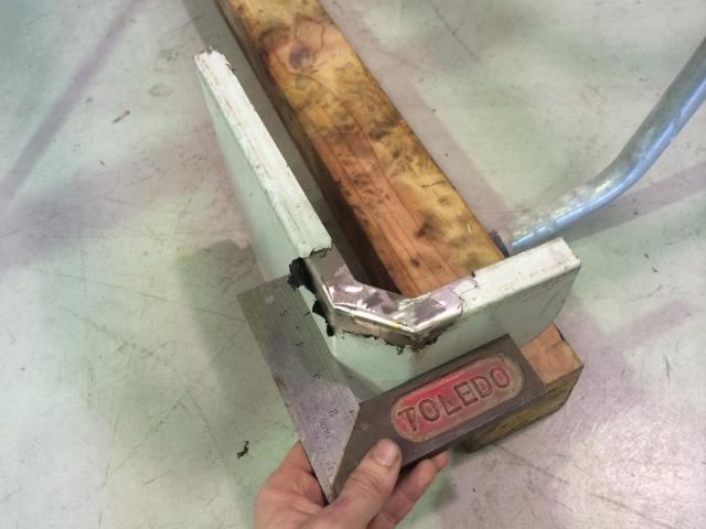

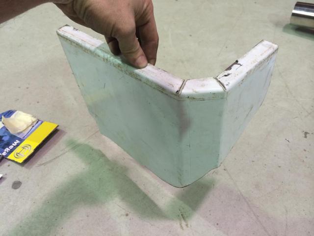

One quick and easy way to make a template is with some masking tape
Mark your lines, un-peel it and lay it over your new steel, cut it out then abit of rolling on the english wheel and shazam one tunnel patch peice.
patch_zps6910508d.jpg\
All we had to go off for the shifter hole was this image from "The Marty Report" thread:
Was actually going to just leave it blank for now but Rob wanted a hole so he could reach under the tunnel with the dolly and knock the warpage out from the welding, so using the above measurements to create a sort of scale we marked out a guesstimate of the hole, then actually cut it out 10mm smaller. Once we have some better measurements we can trim to suit.
All done!
So there you go, is now one awesome Torana with no more rust left for us to fix! like most of the cars we get the chance to work on with this standard of quality they really start to grow on me and knowing all the metalwork has been done properly I cant help but want them for myself! I Wonder if John will notice if it goes missing?
Don't worry, those measurements are the best. It ain't no guesstimate. Marty

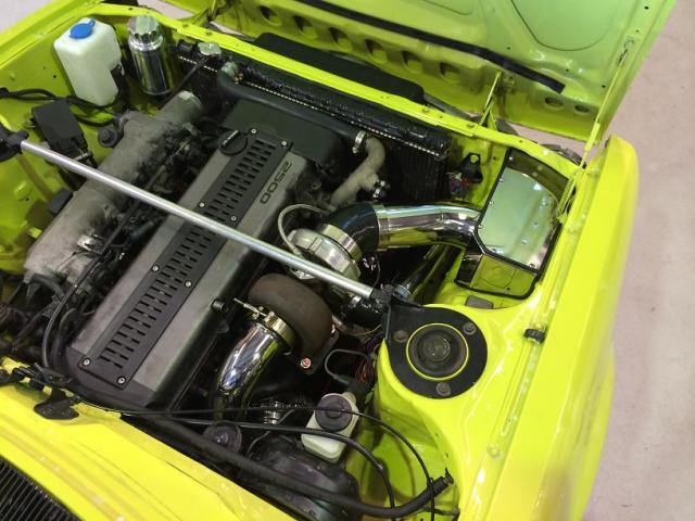

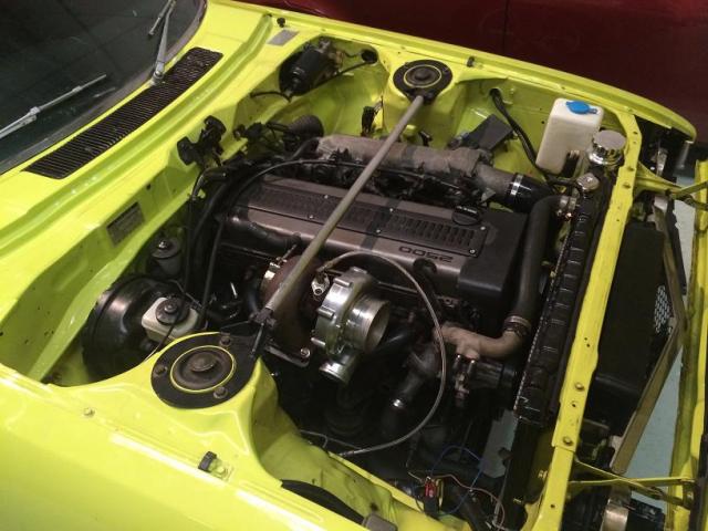

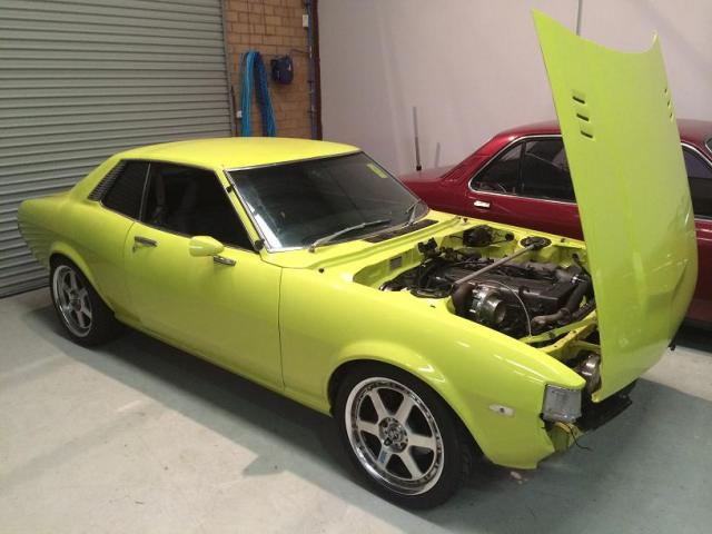

Little project I worked on Recently...
1977? Toyota Celica, has had a Toyo 1JZ 2.5L Straight 6 conversion, had the original twin turbos on it before and made 260rwhp. He removed the twins and fitted a single large turbo. Which is where I came in to match everything up with the new Turbo. He also just got a Yellow sticker a few days before while the cops were having their Hoon blitz, was just cruising along and got pulled over, first thing the copper said to him was the wheels are too big and the car is illegal, then picked on the seatbelt being twisted. Copper asked him to pop the bonnet and since it was already obvious he was getting a sticker he refused so the cop just wrote that his washer bottle didnt work (without even checking it) and gave him the sticker.... He made a complaint to the police not that I think that will get anywhere... Hah sorry going a little off topic here but annoys me, Yes this car is indeed 100% defectable with the engine conversion not being engineered but the cop didnt even know about the conversion and seems he decided the car was getting a sticker before he even got out of his car. He even checked with his engineer (as he was actually already in the process of getting it engineered) and the wheels are perfectly legal size...
Anyway..
So here is what I started with

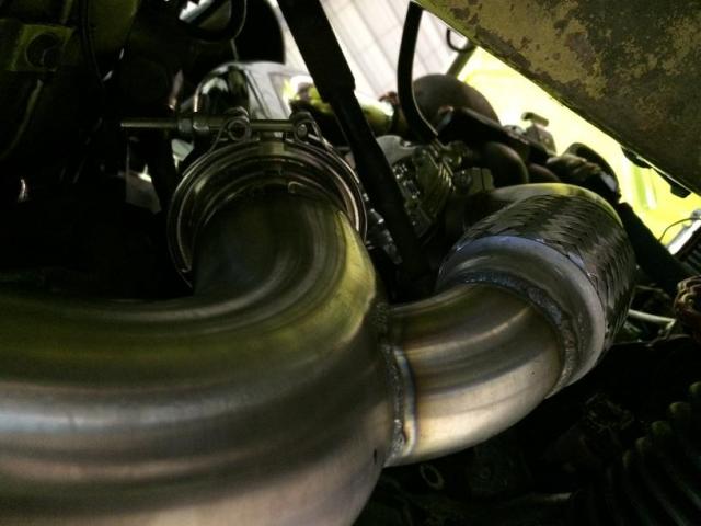

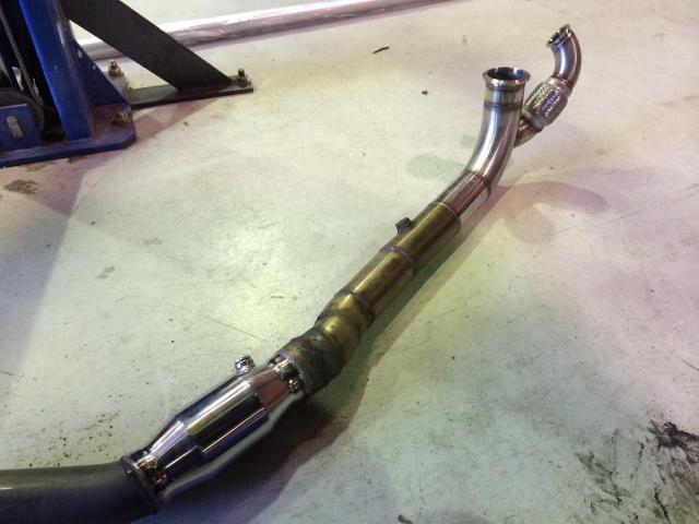

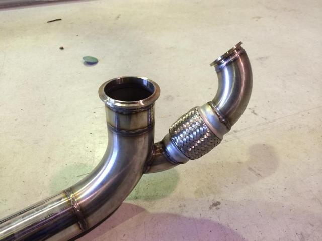

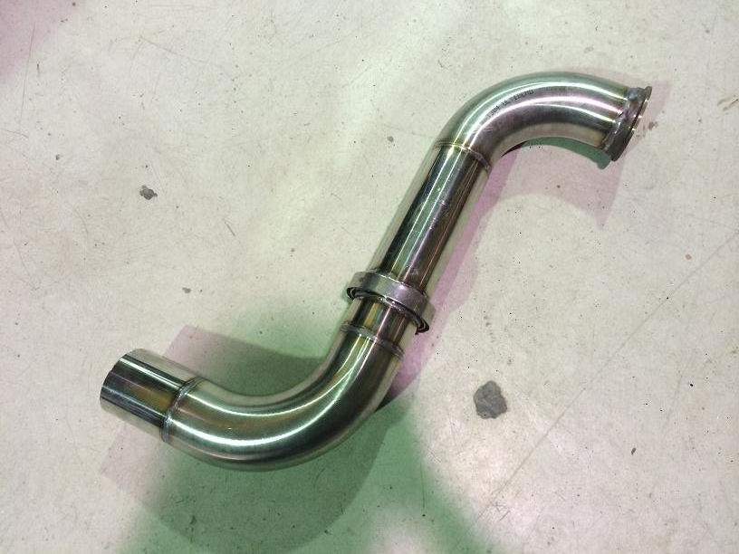

Made up a new dump pipe and section to match up with the existing exhaust:

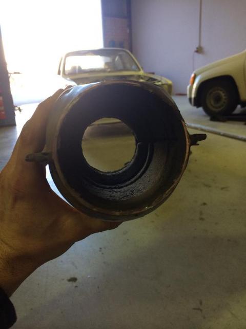

Since he needs to pass engineering (and a polution test) his old Cat Converter was not going to cut it...
New EURO IV Cat in place.

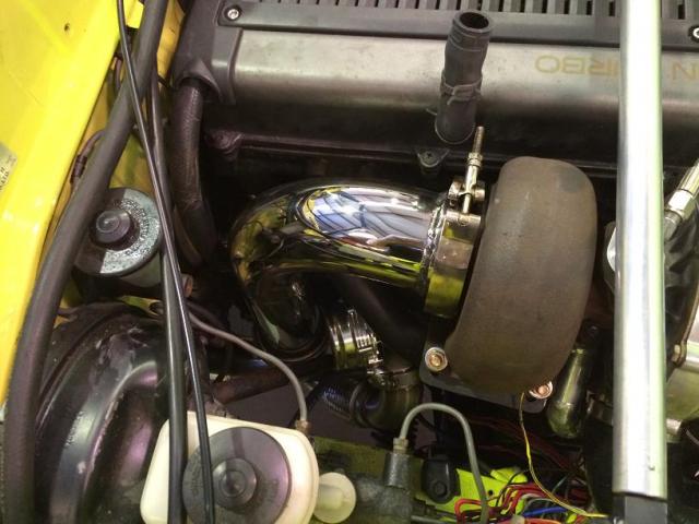

Also made a section to join up the new external wastegate with the exhaust.
Personally I Would have liked to have the Cat closer to the engine (they work better when hotter) but the floorpan didnt really accommodate it, plus he just said to put it where the old one was.
Dump pipe in place and showing where the wastegate is:
Bits you can see of the exhaust were polished:

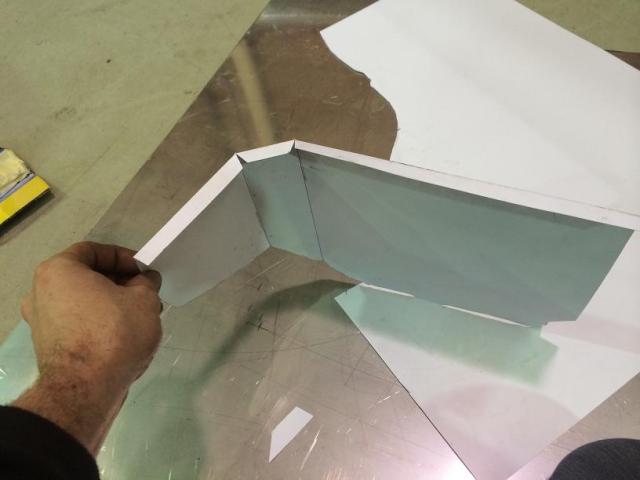

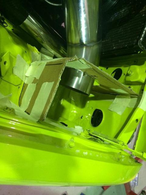

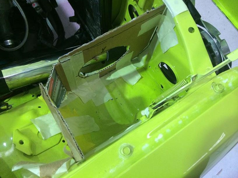

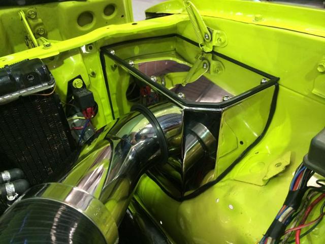

But after that I started mocking up the custom airbox using CAD (Cardboard Aided Design)
Then transferred it to something abit more accurate and double checked the fitment and so I can plan my cuts/folds
Then cut it out of 1.2mm Stainless and bent it up (The stainless comes with a white plastic protective coating)
Weld up the Gaps in the top flange, Making sure its square:
Test fit:

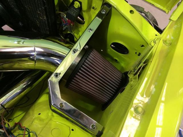

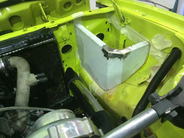

I was leaning towards cutting the hole behind the headlight larger for the air inlet to the box to create a high pressure zone within the box (could remove the headlight at the drags) and add abit of a rammed air effect (not that you really need it with a turbo but still helps) but it was decided to cut the hole into the wheel well.

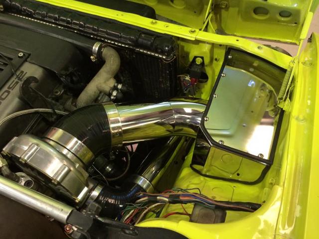

K&N Filter in place and Nutserts ready to accept the lid, Cant really see but there is also 3 mounting tabs on the inside of the airbox with nutserts in the body to hold the box in place.
Lid on, As well as the intake pipe I made and polished:
