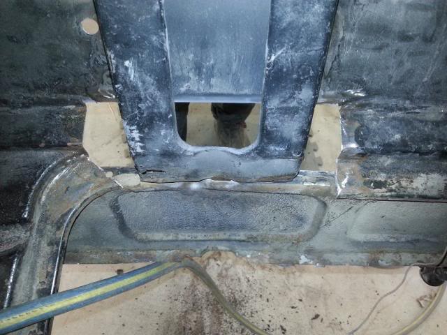

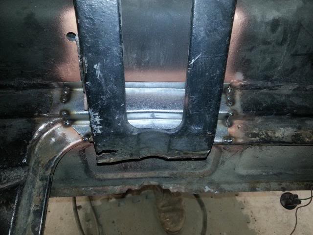

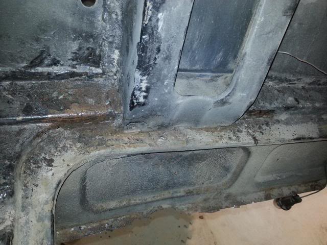

Ok so Robs been busy as on the Torana, I raided his phone the other day for some pics.

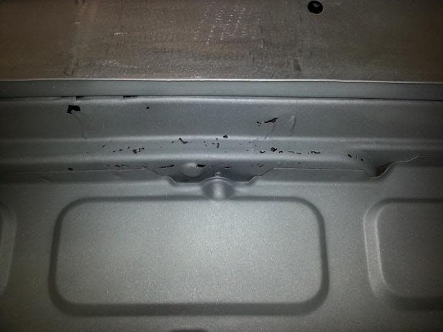

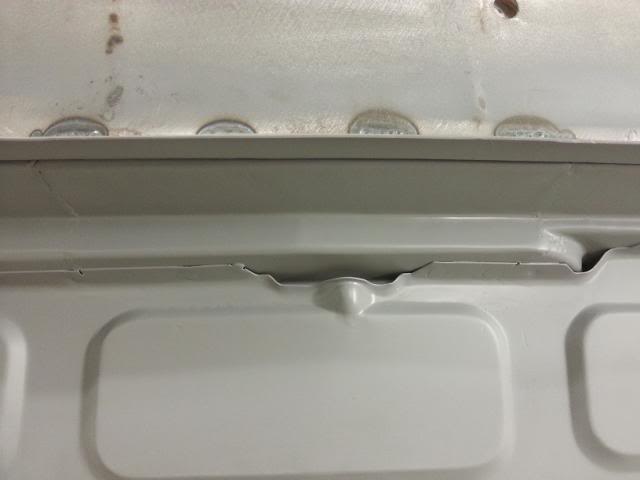

The rear beaver panel had evidence of rust in once corner, originally was just planning to patch that section but after cutting the corner out and having a look inside with a torch we could see the rust inside and decided it best to open her up to clean it inside and out.
Looking further we found some holes in the inner panel that was hidden by bog :/
passengerinnerlowerquarter_zps65b5b63d.j
Blasted the lot
A section of the inner beaver was cut out the way to give access and all the rusty steel was cut out.
passengerinnerlowerquarter2_zpsee4626ce.

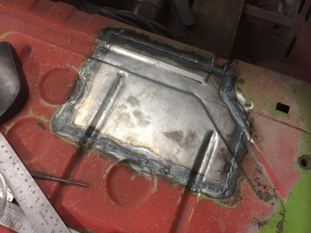

Patch made up:
Test fit:
And fully welded into place:
Another Pesky hole:
Gone:
Inner beaver section put back in place:

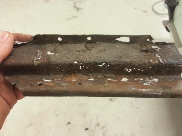

More holes!
Which seemed to be caused by debri getting trapped behind this bracket:

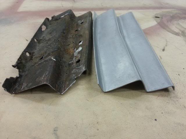

Usual story, cut out wherever there is rust:
Make a replacement part: (was a little trickyer as its not just straight but has a kink in the middle but only in the second fold not the first)
just about done
No more holes:

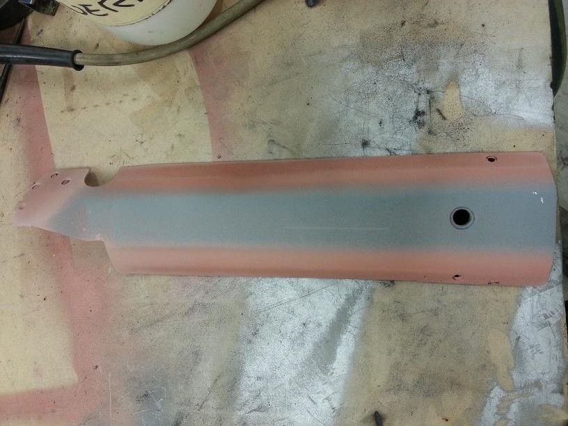

The parcel shelf had been hacked out for speakers at some stage, John prefers to listen to the sweet sounds of the engine and wanted them filled in. Dont actually have a pic of them before but im sure you can imagine a rough hole cut for speakers... But here is some progress pics:
Passenger side:
Drivers Side:

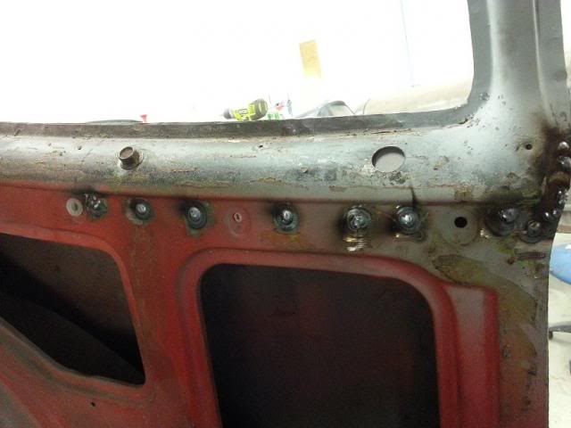

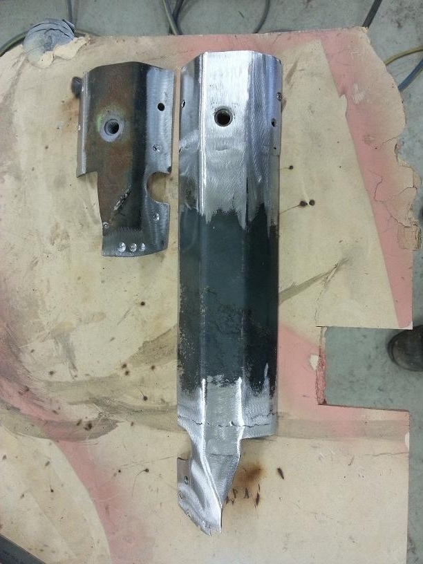

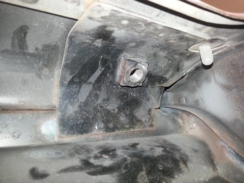

Another job was to re-locate the seat belt mount holes. John prefered the location of the later LJ's as the seat belt doesnt fall off your shoulder as easy.
here is the original mount with the pic taken from the inside:
And both the passenger side and drivers side mounts removed from the car:
The original mounts actually tied into the B-pillar and since we were moving them back a couple hundred mm we had to also extend the brace.
Welded in place:
Old hole welded up
