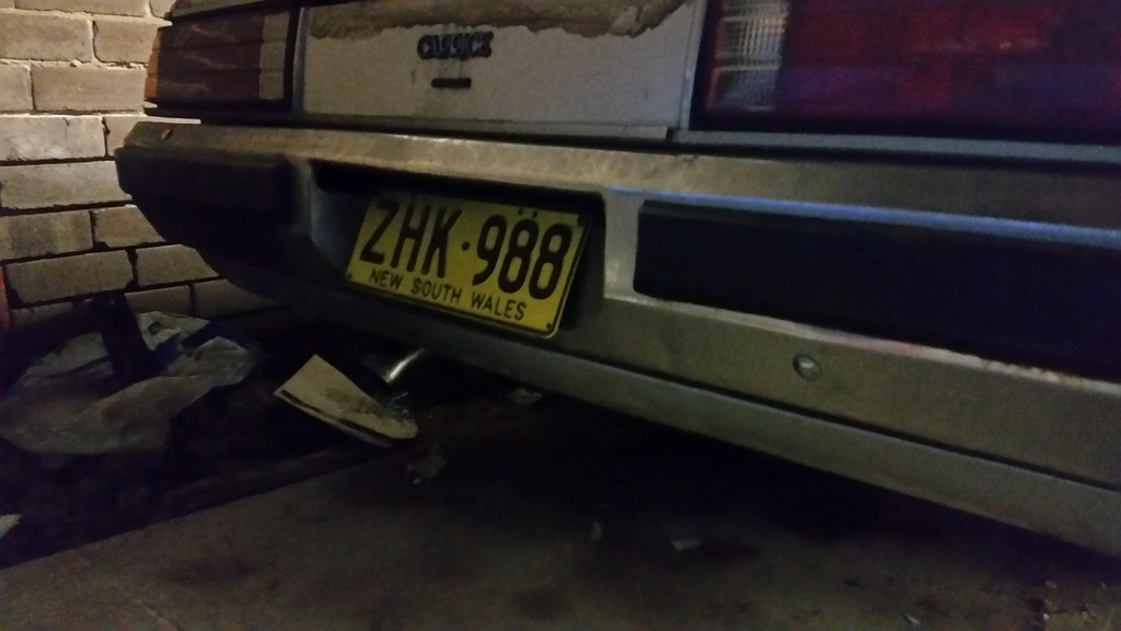

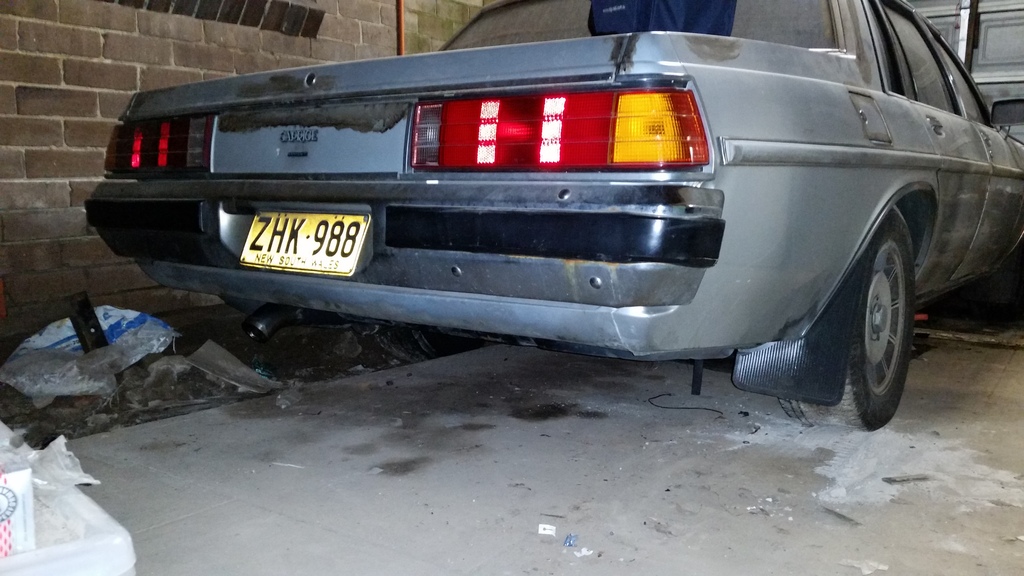

So its all running but a few bits more needs to be done such as completing the fan relay wiring, it is connected but not properly.
I have put the car back on the ground and drove it 1 meter forward and 1 meter back lol as I have the doner commodore in front and LX Hatch shell behind me.
Exhaust is done, twin 2.5 inch into a single 3 inch, Hooker muffler then some stainless rear muffler out back. Not loud but a nice note.
Exhaust tip has an old school turn down which I started to like when I saw LJ355 car when it was red years ago

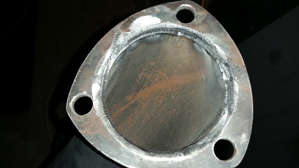

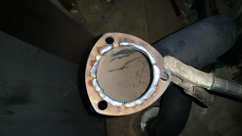

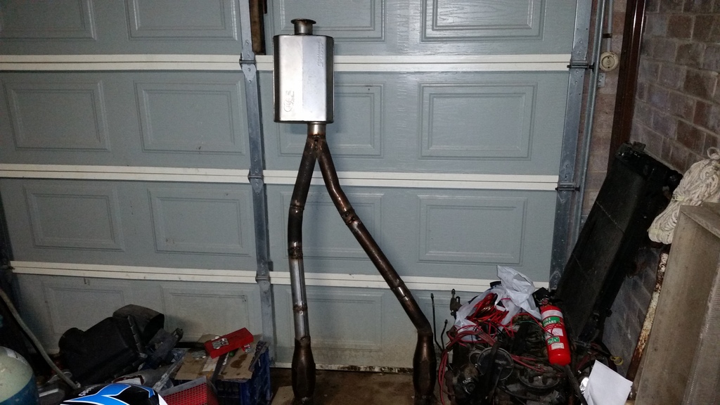

Basically reused the existing 2.5 inch pipe from the Statesman and some new mandrel 3 inch bends for the diff housing section. Chop chop and weld
Its a twin 2.5 which goes into single 3 inch.

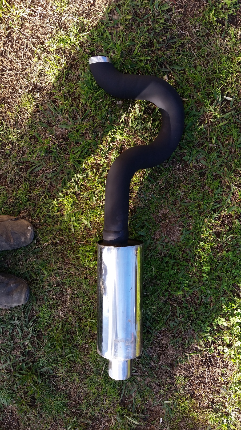

Rear muffler with 3 inch pipeing
Before I cleaned it up and painted
