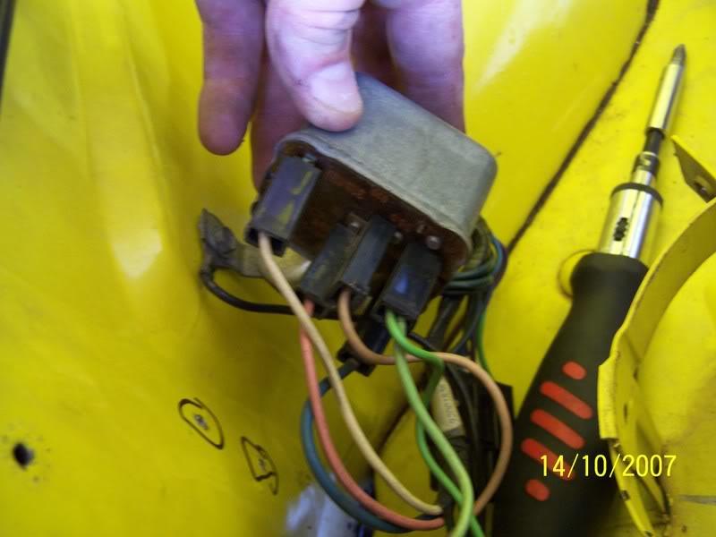

cheers! yes, lx car wiring harness. and do have that relay mounted near the driver's side headlight
(and yes, lights/low are working)
but this section of wiring... (example photo NOT of mine, this is an ebay photo)
Attached File  indicater dimmer wiring (3).jpg   180.52K   6 downloads
..i took from an lh steering column. (as my car was missing this indicator/wiring stuff)
guess worried that as i stole this section from an LH tory it might not be right
(but the lower section that this example loom shown would connect to.. is all proper lx wiring)
------------guess i buy the dimmer... and run the black and white off it as shown..
.. but where i connect to lower section of harness is escaping me.
well, maybe not the WHITE, that i can see from this pic.
but the BLACK ??
Edited by livo74, 08 January 2018 - 09:22 AM.

That picture above is from an LX, you can see the microswitch at the base of the stalk...
If you buy an LX combo switch it should plug straight into the LX wiring harness without doing any modification, it's all in the one single plug.
You feed it down through the coffee pot, down through the plastic sleeve below that, and connect it to the wiring harness down next to the ignition switch (the switch itself, not the key).
Should be easy as...

i can see where i feed the WHITE down to..(last position in the connector, seeemingly)
..but not the BLACK.(coming from the dimmer switch)
hard to tell in this pic
but two or three other wires seem to be black, (or dark blue?) darn it.
..soo, using this pic, i am not sure which of these is the BLACK wire from dimmer. (and hence where in the connector/terminal i place it)
maybe the dimmer black wire is one of the "ground"s in the pic?
or is it one of the black running to the connector. aaargh!

Oh P.S. Yes the extra black wire is just an earth, if you look at the LX wiring diagram it clearly shows it earthed on one side of the switch (No. 11)...
