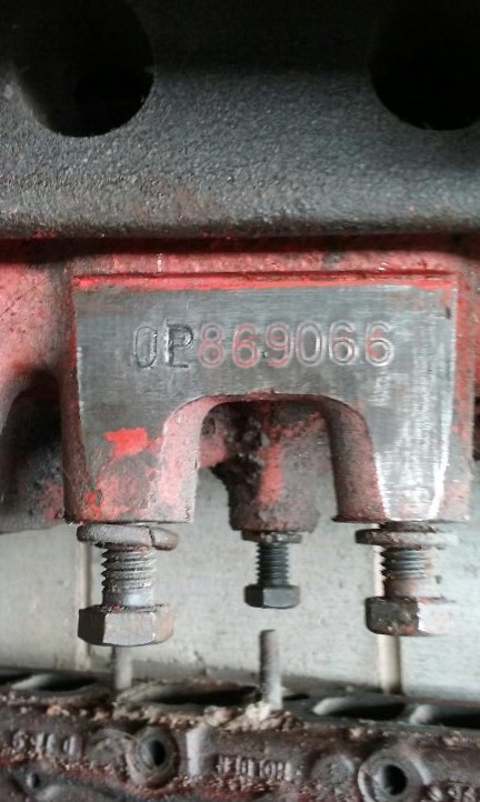

#132 hanra
Posted 03 March 2016 - 12:44 PM
Seems legit?
01146E72-ADC7-4A8D-9BF4-6C0B1A5EAA54_zps
#133 wot179
Posted 03 March 2016 - 01:34 PM
A little scrape of bog, a coat of paint and you'll never know.
#134 S pack
Posted 03 March 2016 - 01:50 PM
Seems legit?
OMG, we better get Bruce to take a look at this one. I always seem to get the easy ones wrong.......

That number looks fine to me.

If its dual cast and has a 3 cast number than its clear some idiot stamped ql over the jp!!!

I cant see a ql.......
#140 S pack
Posted 04 March 2016 - 04:56 PM
Your looking for the wrong prefix. It's QL not ql. :)

Seriously, you say that you can't see the QL under the JP, your eyes must be terrible. The number is much to high anyway.

I think the J is to rounded at the bottom, I think you may have to get this one X-rayed.
