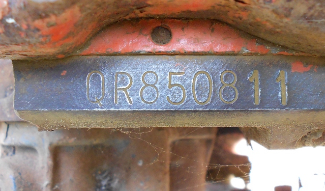

Posted 11 March 2016 - 05:13 PM
I think the "5" and its telltale has been carried on?
The engine is 253 of whatever era i don't know or much care!
Attached File  eng#.JPG   186.14K   2 downloads
Perhaps the interest in these numbers deserves a thread on its own (in Off Topic or other sign on type thing for obvious reasons), clear pictures would be good so that those who are interested can add/comment or whatever without the dual cast stuff getting in the way !
So if some one wants to start a thread with pictures from this/other threads it would at least keep some sort of order about what people
should look for when spotting numbers.
Will try to get a sample of other blocks apart from the genuine QLJP one we made as well as what "after market" stamps look like.

Posted 11 March 2016 - 06:06 PM
Yes the 5 on this QR 253 is the same font as the 5's I posted pics of from genuine original JP, 3100x and CD prefix blocks.
At a guess I'd say 850811 would be 1977 vintage.
Edited by S pack, 11 March 2016 - 06:06 PM.

Engine numbers are only assembly plant specific for Chevrolet V8 engines in HK- HQ. The rest were all stamped in the one place but wear on numbers will probably vary as will alignment as the tools used are different for 6 and V8 and will probably differ for Starfire and V6 too, but same numbers. There are some key indicators across engines too but I won't go into that for obvious reasons, not publically anyway.
