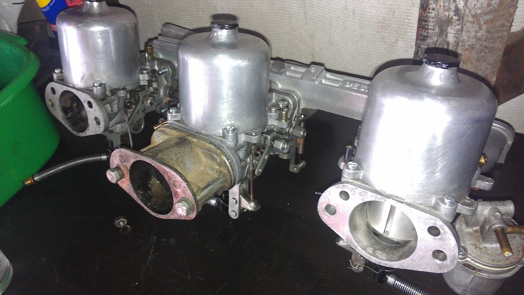

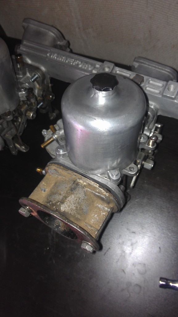

#141 LC-GTR-1969
LC-GTR-1969
    Shed tinkerer
  • 1,162 posts
  • Location:New South Wales
  • Car:Which one?
  • Joined: 09-March 14
Posted 18 April 2016 - 07:20 PM
The later model carbs were spring needles. You can convert your carbs to take a fixed needle by getting a bush made similar to the link for Midels. I haven't got any 2" carbs with spring needles to compare with, but the Midel pic almost looks like it might convert from spring to fixed, not the way it is listed, not sure why you would convert to spring needles, there's a better choice with fixed, maybe a phone call to Midels to confirm.
They sell a bush with a grub screw to convert to fixed screw. I have some here as I needed to convert mine. Not expensive and easy to setup.
I will try to get a pic and will post back.
#142 _ljxu1torana_
_ljxu1torana_
Posted 18 April 2016 - 09:29 PM
a friend of mine has a set of 2 1/2 inch su on his eh holden they might be of a old jag,his manifold is the g t x stamp on it.
#143 warrenm
warrenm
  • 2,131 posts
  • Location:Central West NSW
  • Car:1972 LJ Torana
Posted 18 April 2016 - 11:54 PM
Bit of an update...
So it has been very busy round here, and I have a few projects on the go, but I have started rebuilding my 2 inch SUs... got 2 out of three done.
Firstly, what a great carb to rebuild. Marvellously simple. No need to even refer to a manual or anything they are just so straight forward.
I will need to wait a while now though as unfortunately I have a hole/ crack in one of the fuel bowls from an accident, but I have ordered a new bowl from the UK- not expensive, 40 bucks or so, but it will take a while to arrive I imagine.
I want to port out the warnerford manifold as much as I can to match the 2 inch carb (they are designed for 1 3/4 carbs by the look of it). However, i have to find my die grinder first. STuffed if i know where it is...
Parts from the UK generally turn up reasonably quick.
Not sure about 2 1/2" but there was a 2 1/8" fitted to some Jags.
#144 LC-GTR-1969
LC-GTR-1969
    Shed tinkerer
  • 1,162 posts
  • Car:Which one?
Posted 20 April 2016 - 02:26 PM
Gday again, the rebuild is progressing nicely... still a few things to do but waiting on the new fuel bowl so no rush...
[/URL]">http://IMAG1231%201.jpg
I havent polished things to the enth degree as at the end of the day I am just experimenting with the 2 inch SUs. Iff I fall in love with them, I will probably improve the finish on them. I soda blasted them and gave the dashpots a quick rub with wet and dry but thats it for the exterior.
The internals are all new though.
Quick question... As I am running a warnerford, which I know is a little short so not ideal (but its what I have and it came with the carbs- so I figure I may as well just use it for now), I was thinking of making some extenders for the manifold out of some plate and allum. pipe to effectively lengthen the manifold say 2 inches... However I then remembered that some spacers came with my box of parts- i havent cleaned these up at all yet as I wasn't sure whether I would be using them...
Here are some pics of them;
[/URL]">http://IMAG1233.jpg
[/URL]">http://IMAG1234.jpg
I figure that these spaces could be good for increasing the runner length... With the spacers, plus 3 inch bell mouth trumpets (which I will be buying from SU Midel), the runner length from the face of the manifold to the end of the bell mouth will be 14 inches. Not sure exactly of the measurement to the valve though, maybe 17 inches?
So my question is, what is the ideal runner length for peak power at 6000rpm and a powerband between 4-6500rpm? I have seen phenolic spaces for 2 inch carbs from the UK so it would not be hard to extend the length a little more if needed.
