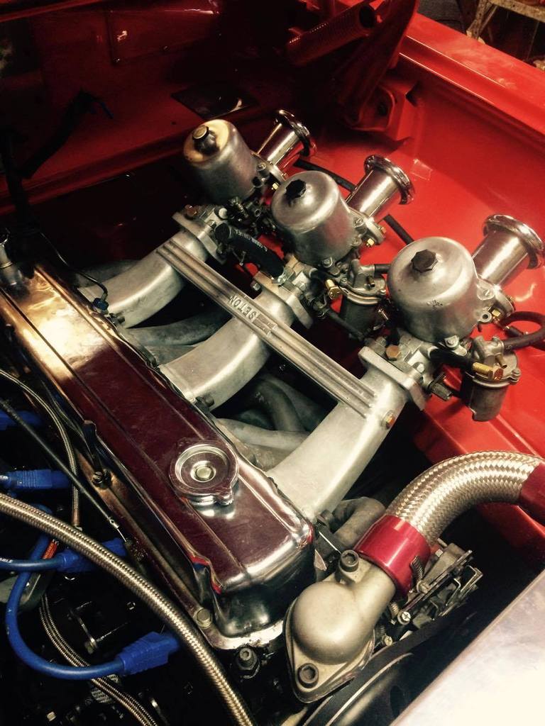

So here is a before and after-
Before, with webers;
Screen%20Shot%202015-06-11%20at%206.40.3
And after, with seton manifold and HS8s;
17886908_10155406614594095_1032204369_o.
BTW- Photobucket seriously sucks balls.
Edited by LC-GTR-1969, 15 April 2017 - 04:51 PM.

Ok, so I have been syncing the carbs and setting the AFR at idle...
Firstly, it seems a little rich at idle- my INNOVATE wideband is telling me 12.5:1 and my colourtune confirms this. I have the jet wound back as much as possible and this is the reading... it then appears a little lean above 4000- dips to 14:1. The lean above 4000 could possible be a small vacuum leak- so I am going to test that and fix any vacuum leaks if there are any.
Running .125 jets and UP needles. The spings are red at one and and green at the other- these are just what Midel gave me... I have no idea if the springs are ideal, but I still have the original JAG springs that came in the HS8s. The original feel lighter but could be my imagination.
Secondly- it doesnt like idling below about 1400- but that could have a bit to do with the rich condition at idle I suppose. Carbs are synced but she gets all rattly at 1000rpm, and the SUs are shaking like an ice addict on the morning after. Settles and smooths nicely at 1300 or so rpm. My webers idled very happily at 850rpm but I still have tuning to do so not too worried at this stage.

I just took the old girl for a spin and it is a little rich at idle- 11.9 - 12.1:1, but when it comes on the cam it jumps up to 13.5:1- this is at about 4500-5000rpm...
I cant really richen up much with the adjuster screws as it starts to stumble and want to die from being too rich at idle.
I will try the other set of springs and see if that helps...
Also, yes, I am running oil in the dashpots, quick snap of throttle seems ok, no lean bog. Genuine SU oil.
Also, the chappers just pulled me over lol- they said they had reports of me driving like an absolute maniac- which was not true, I hardly got out of first gear and would not rev it past 4500ish rpm as it was too lean.. . Coppers were very nice though, they just said to drive my normal car as its so loud that everyone will think that I am flying... At least they were pleasant and did not hassle me.

Ive been tinkering again this morning, and have it idling better- the AF is now about 13.5-13.8:1 at idle, which is quite crisp- pretty much what I ran with the webers. The idle is now 1200rpm where it seems happy- once I got the idle AFR more ideal it idles cleaner obviously... but still doesnt like it lower than that though.
Problem is she is still leaning out when coming on the cam- so I suspect either stiffer springs or needles with more taper in the mid/ bottom half than the UP needles? Any recommendations?

Ok, so I seem to have them dialled in quite well now- just need to drop the idle a bit more, but otherwise she is running very clean.
Just some obervations;
The good (compared to webers);
- Much easier to drive than webers- seems smoother just above idle
- Much better low down torque, runs crisper from 2000-5000rpm. This may have more to do with the manifold but whatever...
- Pulls out of corners easier
- Car sounds more aggressive at idle (I didnt think it was possible but it does)
- Revs quicker, much better response. Violent response would be a good way to describe it.
The bad (compared to webers);
- Harder to start, but no big deal, seems to start most times without choke but only when weather warmish.
- Does not like idling very low- the webers could idle at 650rpm without too much trouble, but the SUs start rattling bad below 1000rpm. This is a big cam though, with lots of overlap (266@50 thou).
- I do much prefer the look of webers
- I actually find the webers more pleasant to work on, but thats just me..
- Did I say I prefer the look? (the SUs look good, but just not the same)
Neutral observations;
- The webers seem to bring the cam on harder- has more 'hit', whereas the SUs seem to spread out the torque curve quite a bit (which softens the hit).
- The sound of the car is very similar when on the boil- cant say the webers sound better on full song, seems the same above 5000rpm.
From a standstill, I would say the SUs would win the drag race due to better response and better torque down low to pull it out of the hole.
However, my guess is the peak HP would be the same or very similar. On a circuit track, where the revs would not drop below 4000rpm, I would say their are not many advantages to the SUs, they would basically be very similar to webers. But on the street, or for drag racing, the improved torque and low down response really wakes it up. I can see why so many drag racers seem to prefer 2 inch SUs and circuit seem to prefer webers.
At some point I will try to get the car dynoed at my local dyno place, but the operator has broken his back (poor bigger), so it may be a while from now.
