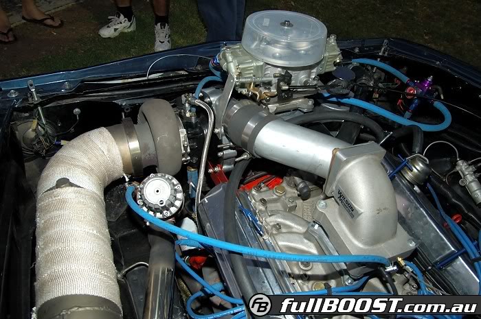

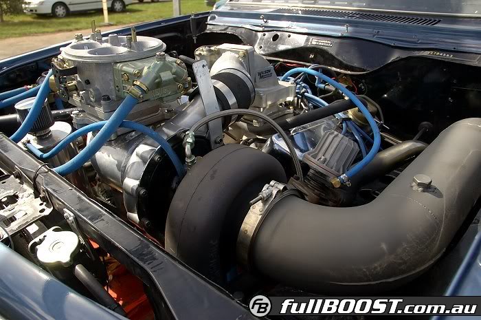

Heres some pics of a Turbo LH that I got from Fullboost. Its not very street friendly with the pipes running under the K-Frame but thats a massive turbo and it runs 9.5 @ 143 which is impressive. Have a look through the Fullboost back catalogue of videos there is a few of this LH running hard. Its a handful to drive when the boost comes on.

that torana above doesnt really need a IC, I am pretty sure its running on methanol.
