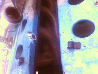

Posted 17 January 2007 - 04:46 PM
nose cone still has all the bolts holding her in, i only have two small holes cut out of the bottom to lower the cooler and locate it. it also has two L brackets from the radiator to the top of the cooler to support the top. the bar that runs vertical from the safety catch to the nose cone supportr is the only thing deleted.

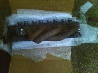

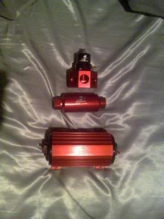

my aeromotive stuff just rolled up. looks sweet

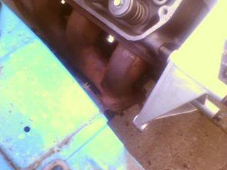

hey all

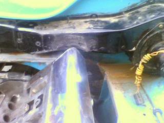

i have been playing around will plumber her up im now using stock 185i factory extractors reversed. i was going to use a cast manifold on the drivers side like jakes torana but know using the vr extractor on both sides. im using a vn engine mount and moving the the mount back a bit. i also going to run the dump pipe down the front of the engine and under the sub frame. the passenger side hads had the flange cut off so i can mod the pipes. you also have to space the alt out and get a triple crank pulley. we had to heat up the heater box and massage so it would fit, it looks a bit crappy at the moment but with a bit of filler will look sweet.

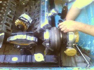

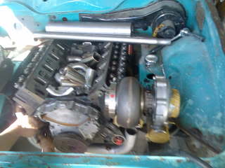

Posted 27 March 2007 - 10:22 PM

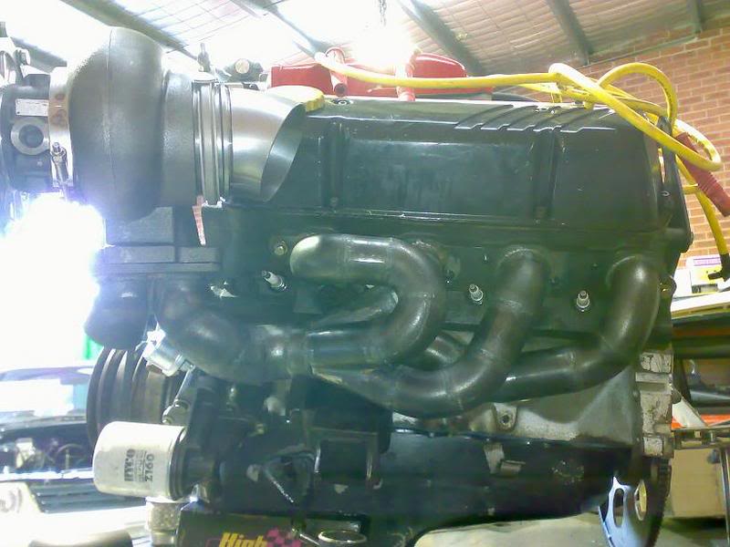

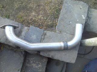

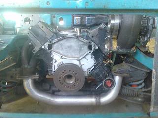

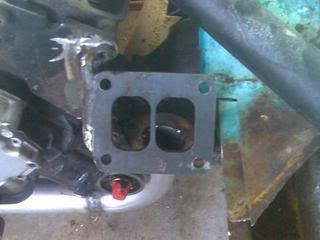

hey all, long time but have finally got off my ass and im finishing off the exhaust side so we can finish off the engine bay. i know that the left hand extractor has a lot of length variation but im only doing this on the cheap it see how much power i can make and for what cost. i also go my scoop. heres some more pics
Posted ImagePosted Image

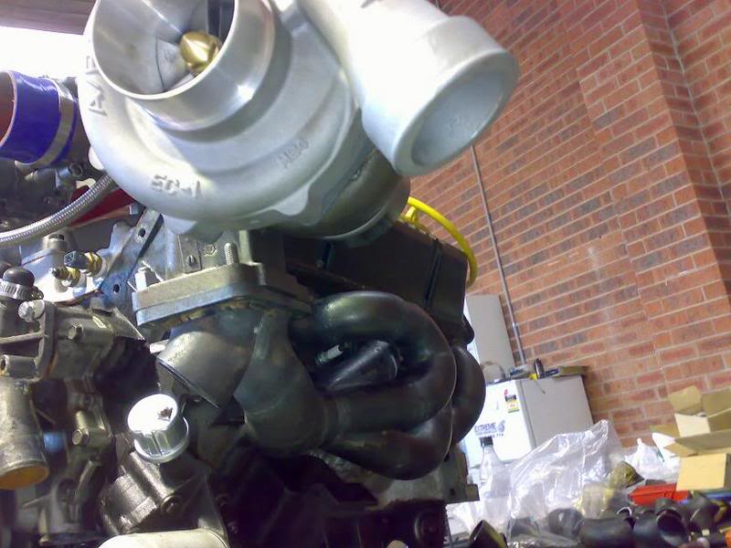

long time no post. i have finally finished my apprenticeship and can now get some reasonable cash. anyway i have changed my mine on engine combo, im going with a 355 i just got my crank and rods (eagle crank and scat h beam rods). i also am getting a nice alloy fuel cell and all fittings off a mates car (purple HR blow-thur single turbo 400 chev). i have finished my turbo manifold and cross over pipe, just waiting to get some cash to hpc coat them. i will put some pics up later .

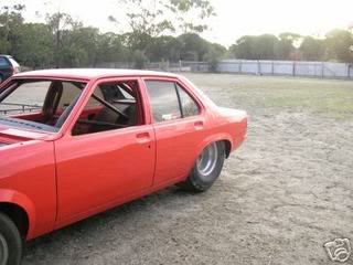

i have changed my mine again with the car. i have sold the old car to a mate and brought a new roller. heres a look at it.Posted Image :spoton:
