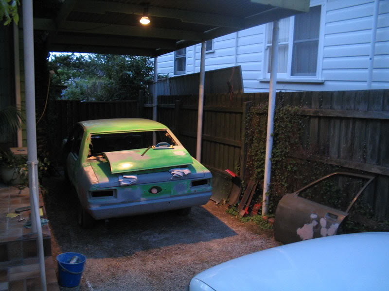

Posted 05 December 2007 - 12:35 PM
Working away... I can see the light at the end of the tunnel but it's still a long way :P
#236 MRLXSS
Posted 05 December 2007 - 01:25 PM
is there a torana under all that bog?
#237 Heath
Posted 05 December 2007 - 01:57 PM
It's a bit that way isn't it? I've used like 1.5 L/kg so far :P

Posted 05 December 2007 - 04:50 PM
your not bare metalling it heath? whos doing the paint job? thats a bit of bog! lol. looking good tho!

#247 Heath
Posted 06 December 2007 - 12:10 AM
I have to stress that there isn't actually particularly much bog on it, I think Matty was just joking. He hasn't seen it in the flesh and you can't see much in that shot I provided... I'll get some better photos. There's nothing over a few mm really, I would say that way more than half of that bog has been sanded off Rob, but I may be wrong.
toryman76, not I'm not bare metalling the car. I'm just bare metalling everything I repair, and everything I'm not sure about. If I bare metal a dint, I will still overlap the bog out past where the paint begins again (you can see that in lots of pics so it looks like there might be paint under the bog) but the edges of the bog all come out when you block it back, so don't worry about that, the bog still ends up meeting bare metal around the edges once it's fully sanded, and then I give it some coats of undercoat as that's better than nothing. I'm just afraid of the moisture in the air... but I know people who have had good results from similar repairs so I'll just hope for the best.
A friend of mine who used to be a member of these forums is spraying the car, 2k using my gun and my mate's compressor.
GML-31 and Herne rofl I agree, they use it in excess. Admittedly there is a reasonable quantity in my beaver panel though :P
Anyway I'm getting more experience fixing these doors that are covered in small shopping-trolley dints than I would if I was given a straight set (haha that doesn't mean I didn't try to get a straight set though!). And I think I'm close to finishing with bog work. It's not that hard... I think. I will see how well or poorly I did when we start coating the whole car in high fill.
