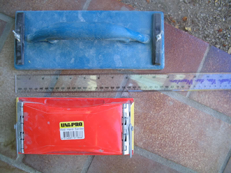

40, 80 and 120. Haven't been through that much... you can get rolls of the stuff for $9 at Bunnings and that is more than you should need for any car if you don't spend too long trying to sand into the steel. Have a few increments and at least two blocks/body files so you don't have to swap paper, you just pick up the other tool.
I'll be using finer stuff from now on though. The really course grades are only for things that need a lot of shaping. Using very course paper creates difficulties...
That body file and a smaller block as well
