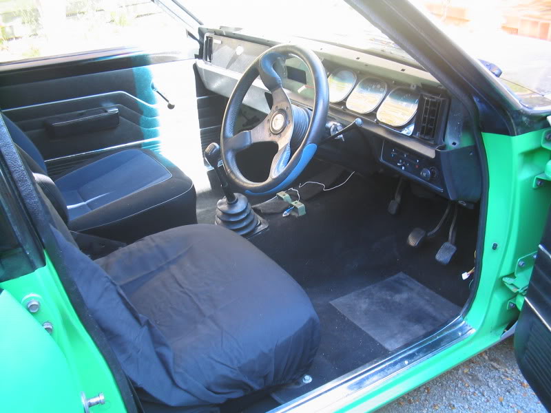

Painted my steering wheel; before:
After
#1131 _mello92_
_mello92_
Posted 26 May 2009 - 04:22 PM
Nice improvement.
Always something to do ay...

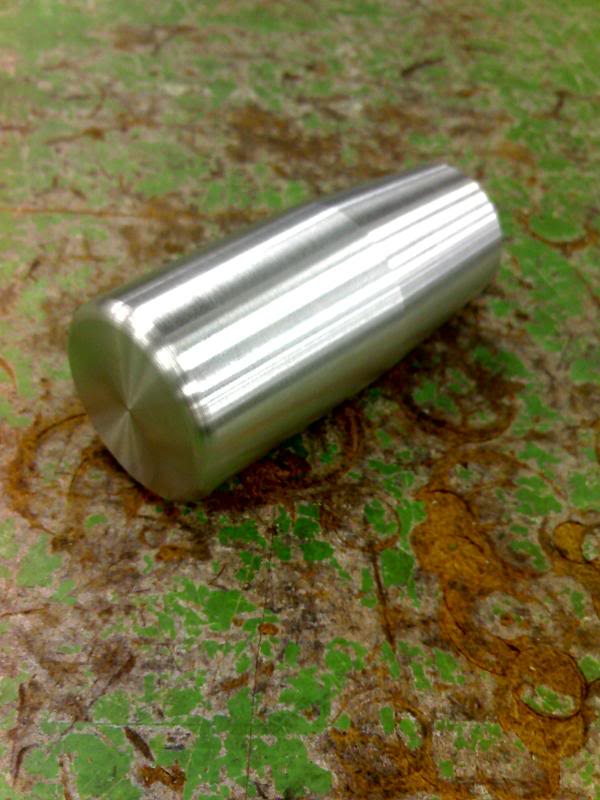

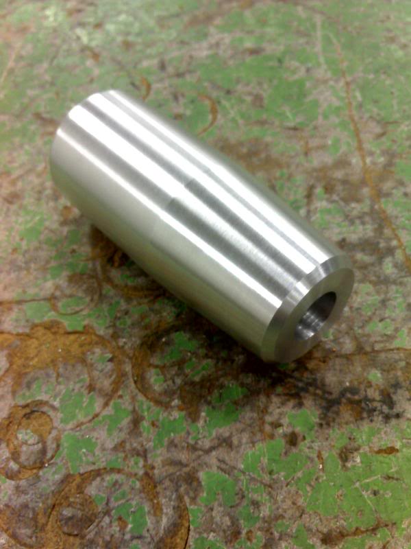

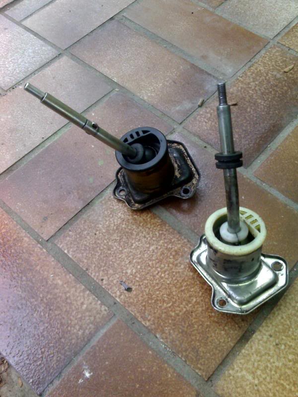

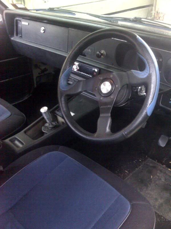

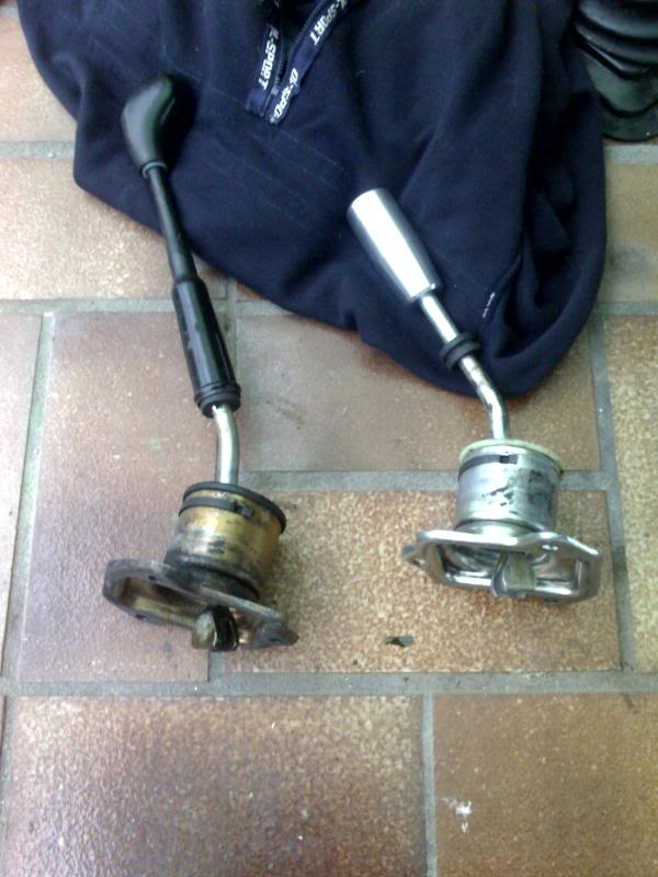

Finished up the work on my shifter, making the best of everything I had, feels a lot more precise and should hold together better than the old one with some adjustments that I made.
After i finished making my shift knob i had a bit more material and time so i made a few horn button centres to suit an autotecnica (generic?) horn button, and I think it's a lot neater than the plastic sticker things that they come with. If anyone wants one, I have some spare, gimme a yell
Knob:
New shifter and temporary boot setup to suit smaller diameter lol
In the car with the horn thingo pressed in
Obviously it's a lot shorter (angular throw is the same but i found out that it wouldn't be particularly hard to make a real short throw shifter if you felt that way inclined; I have no need for that), it gives more feedback now without the dampened connection, the reduced weight of the new knob and shaft means it isn't trying to wear itself apart every time a force is applied (such as steering, accelleration, braking), and it looks exactly how I wanted it to look, even if it isn't to everyone's taste
But I'm gonna need to pull it down again and heat up the bend, reshaping it to fit in the console hole better (wish I knew that, because i already used an oxy to soften the hard surface last week; D'oh!). And then I need to get a proper console boot and then probably make up a new collet to suit the smaller shifter diameter too haha
It's amazing how even the most simple machining tasks can be so satisfying when they have a real application lol.
Edited by Heath, 02 June 2009 - 03:15 PM.

How does it go for comfort when shifting from a nromal driving position?

Beautifully of course. I wouldn't have made it if I had to lean forward to reach it LOL I measured it all up before I cut things up :P
Having said that, I sit reasonably close to the firewall, and sit very upright; not like a fooli sick Commodore driver. So for me, it's spot-on.

Looks neat man well done.
The shifter does look quite short but that said, the old one was rather long (and at least this one is functional).
